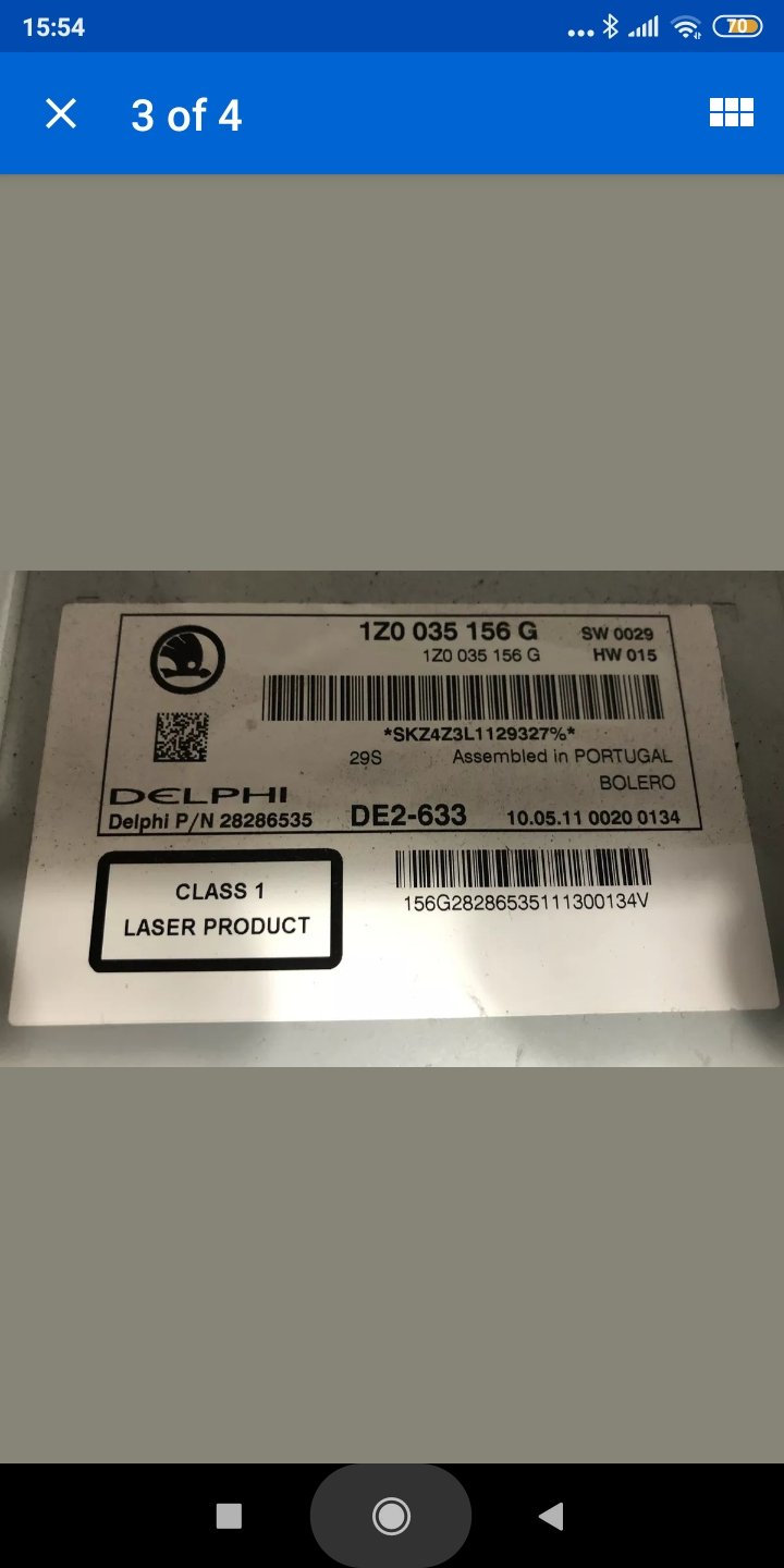

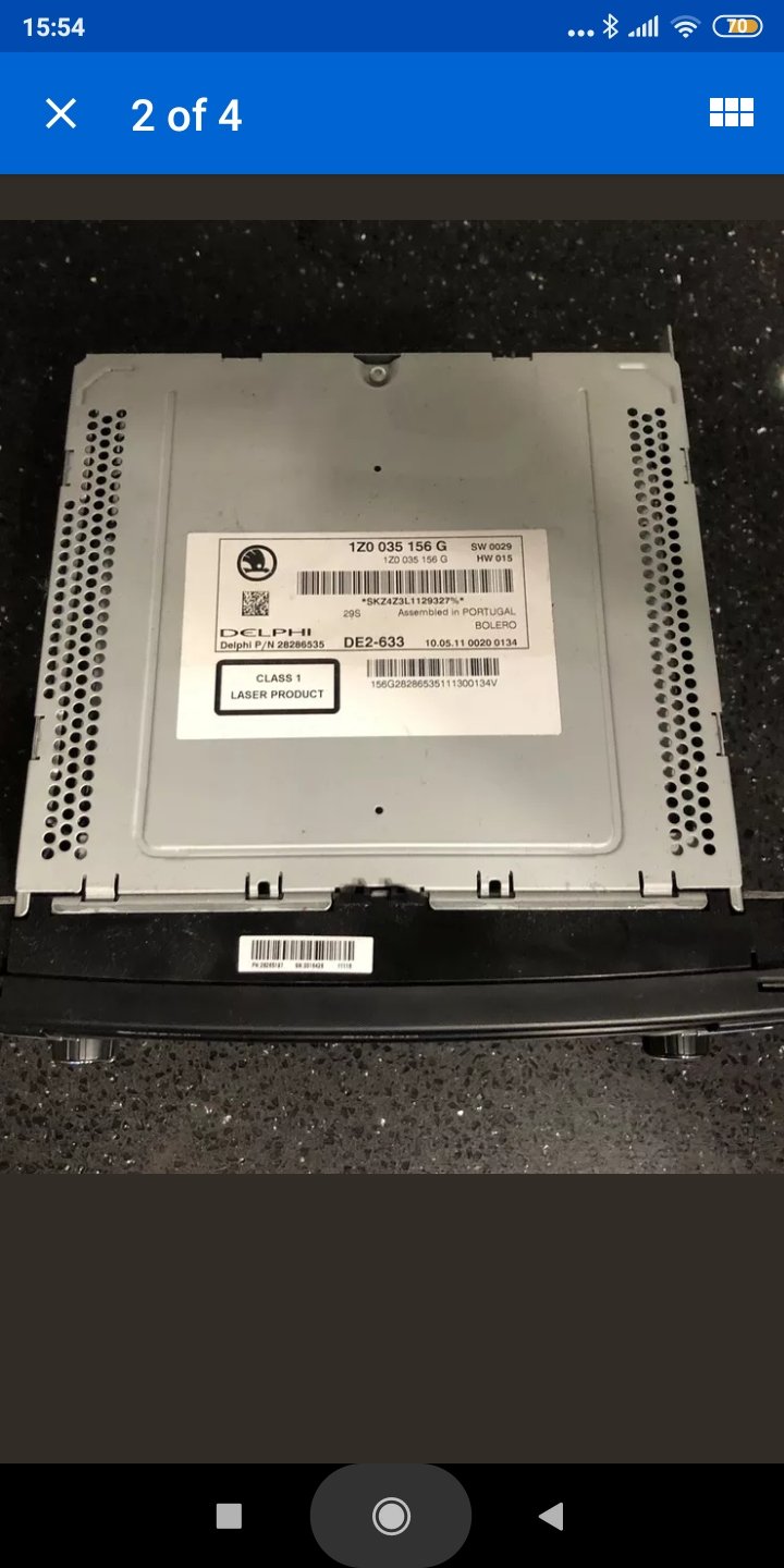

What is the part number on the bolero and what make is it?
Screenshot_2019-11-25-15-54-24-151_com_ebay.mobile.thumb.jpg.485d1bb9c510198016e4e01f20586618.jpg
