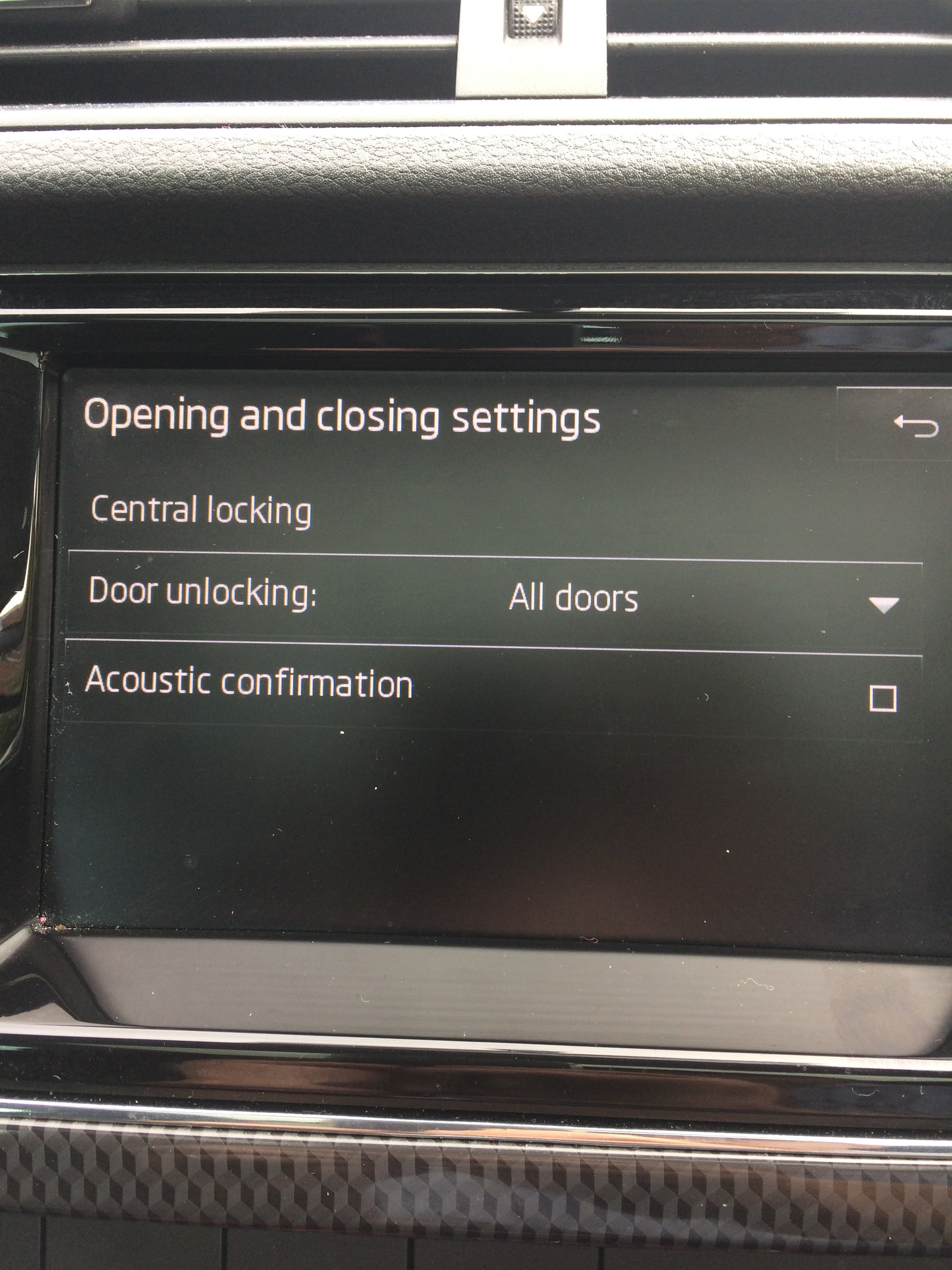

Can anyone tell me the VCDS coding for activating alarm chirp on locking/unlocking the Fabia3 please?  TIA.
2 hours ago, Trev2 said:
Hi,
Doesn't need coding, it's activated in the car settings/set up under opening & closing.
Edited by pauldazzle
Thanks, unfortunately that's not the case on my car, there is only one option which is setting whether unlocking all doors, one door, or vehicle side
Hi Trev2
do you have an alarm or just keyless entry?
I do not have the alarm and have not been able to activate the chirp on lock / unlock
Not keyless entry (I have to press the button on the keyfob), and is alarmed.
This is what our Monte shows.
No, I don't have Acoustic confirmation
Ah, so you'll have to code it in then.
Ours (not KESSY) came from the factory with it so I presumed all Monte's would be the same, obviously not in the 2017 version.
As I said, I did mine with the free Carista app and obd2 Bluetooth dongle.
Wasnt in the options on my 2017 Fabia either
