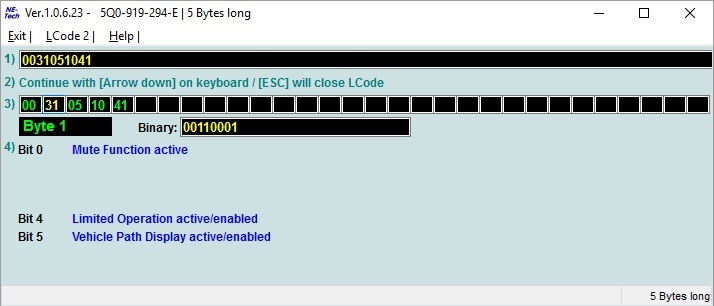

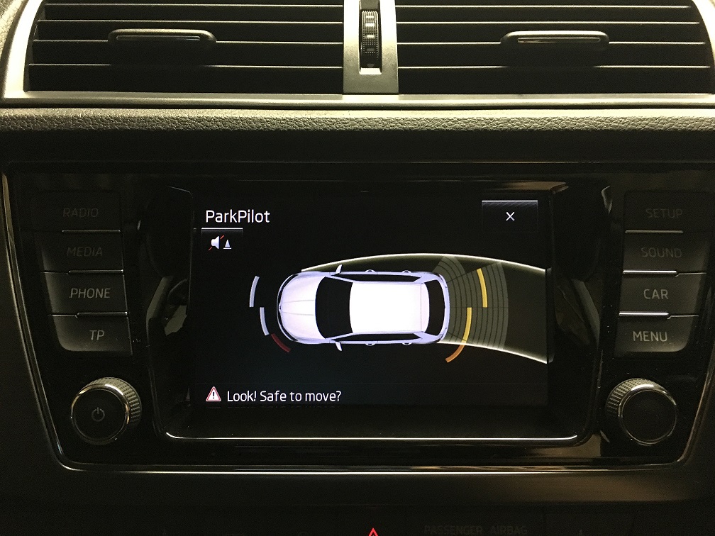

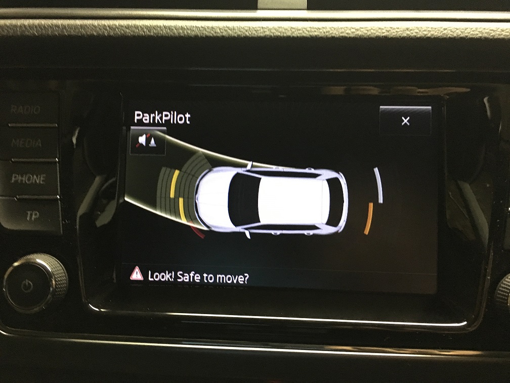

Enable Vehicle Path for parking distance sensors.
Module 10 Park/Steer Assist - Coding - Long Coding Helper - Byte 1, Bit 5
post-5279-0-46373000-1460493621_thumb.jpg  post-5279-0-53022000-1460496082_thumb.jpg  post-5279-0-30861100-1460496162_thumb.jpg

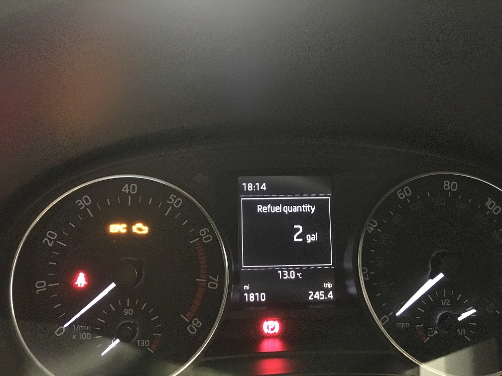

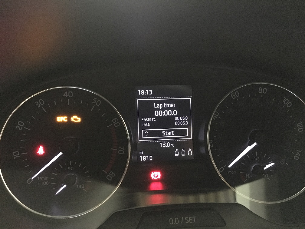

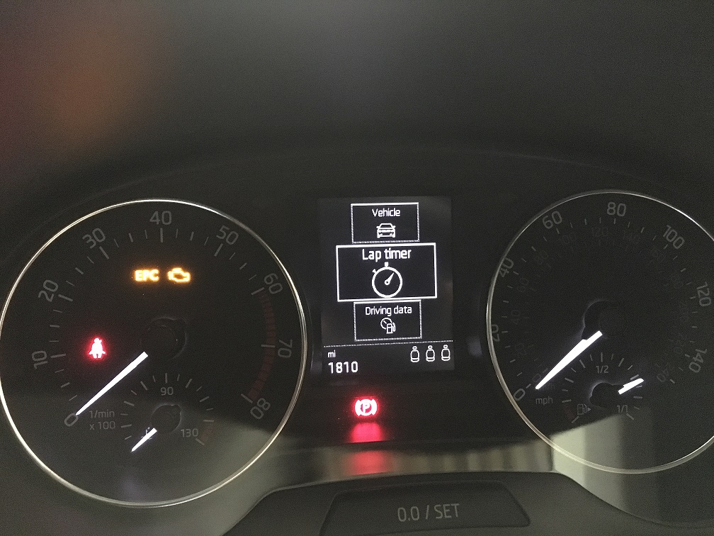

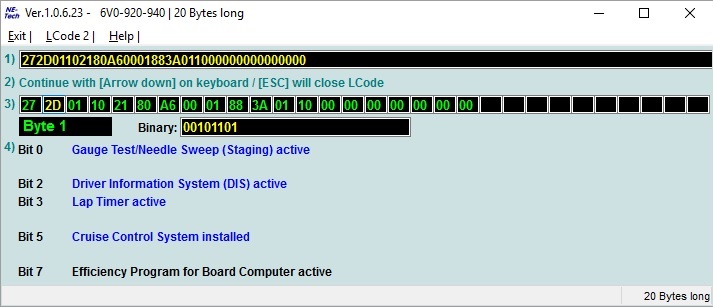

Enable Needle Staging, Lap Timer & Display Volume to Replenish
Module 17 Instruments - Coding - Long Coding Helper
Needle Staging - Byte 1, Bit 0
Lap Timer Byte 1 Bit 3
post-5279-0-28753100-1460494232_thumb.jpg  post-5279-0-75232100-1460496290_thumb.jpg  post-5279-0-95706400-1460496295_thumb.jpg

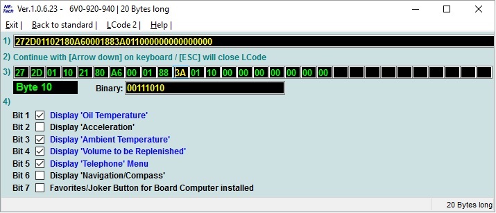

Display volume to replenish - Byte 10, Bit 4
post-5279-0-10625400-1460494417_thumb.jpg  post-5279-0-84270700-1460496393_thumb.jpg

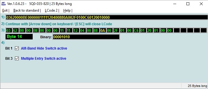

Hide AM Band
Module 5F Information Elerct - Coding - Long Coding Helper - Byte 14, Bit 1
post-5279-0-23494000-1460494712_thumb.jpg  post-5279-0-67114000-1460496387_thumb.jpg

carl0076 - the vehicle path looks cool! Do you know if that is available even with only the rear sensors?
It is awesome I was so pleased when I spotted it as I had seen it on my mates octy mk3, the octy only had rear sensors so yes would imagine it's there for just rear sensors, should be the same module just make sure you have the latest VCDS version as there are way more tags in the long code helper than in previous versions for the fabia

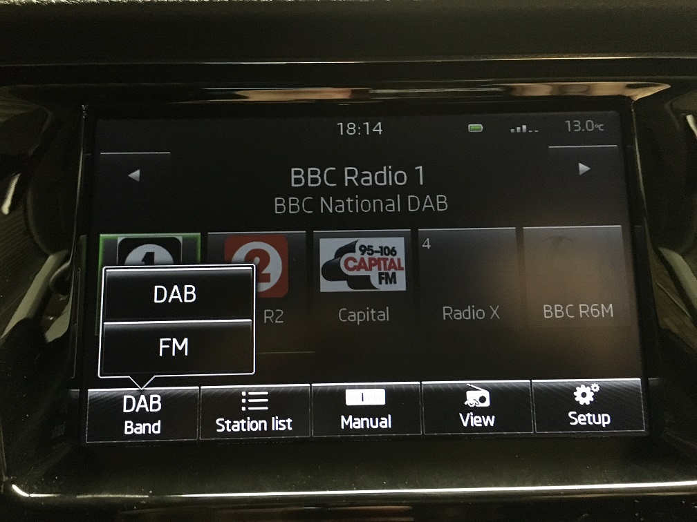

Anyone know how to activate the radio station logo settings on a Swing radio??
I have the logos on the SD card, but the required selection box under DAB or FM settings to "grab" the logos from the SD card is not there!
I've had a quick look in the 5F admap I did but nothing stands out at me as of yet!
No need for VCDS - there is a little donkey-work needed though - no "grabbing or "cutting-and-pasting" here !!
Here's the gen you need, fabdav :
http://www.briskoda.net/forums/topic/361220-swing-gen-2-and-station-logos/#entry4313013
Edited by Dithane
I read that post, but it does not help as the radio does not have a setting for "station logos" as shown in your pictures! I am asking if it is possible to ""activate" that setting via VCDS to then be able to reveal the station logos setting to enable you to then load the logos as you state in your post!
