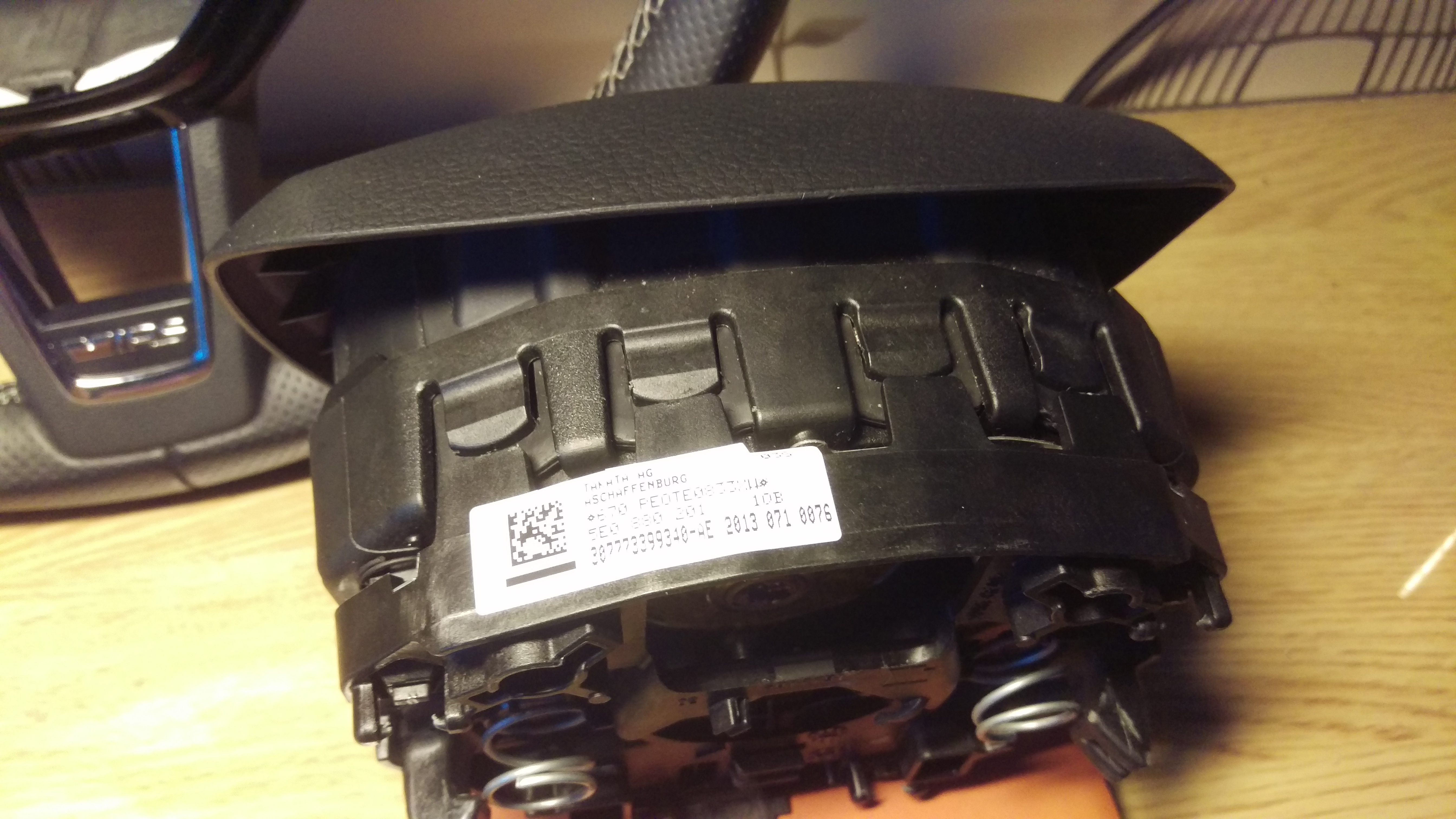

it looks like your airbag is just put together by plastic clips around the cover.
https://lookaside.fbsbx.com/file/Montering af nyt airbag logo..pdf?token=AWy9-kmqQLBE8a-r6hVQV9U1mpbTJ-9sc6kWwshRN7o1wtfwBz8PX9EdI5Sp2UWRe4uQ7EV6-otHxb0nnVNM5cckjo5-zQavX44g1Eyycc-Nh2aJelDY02CZfej9eP7OnBbAlf-VquYKNdT4yraW-g37J8IIUlTatJpvN1Wd-E_vx9ZlBdnuCejcjB73EaYetfg
It looks like it should pull off without disassembling anything else, but the cover won't seem to budge when I release the clips.

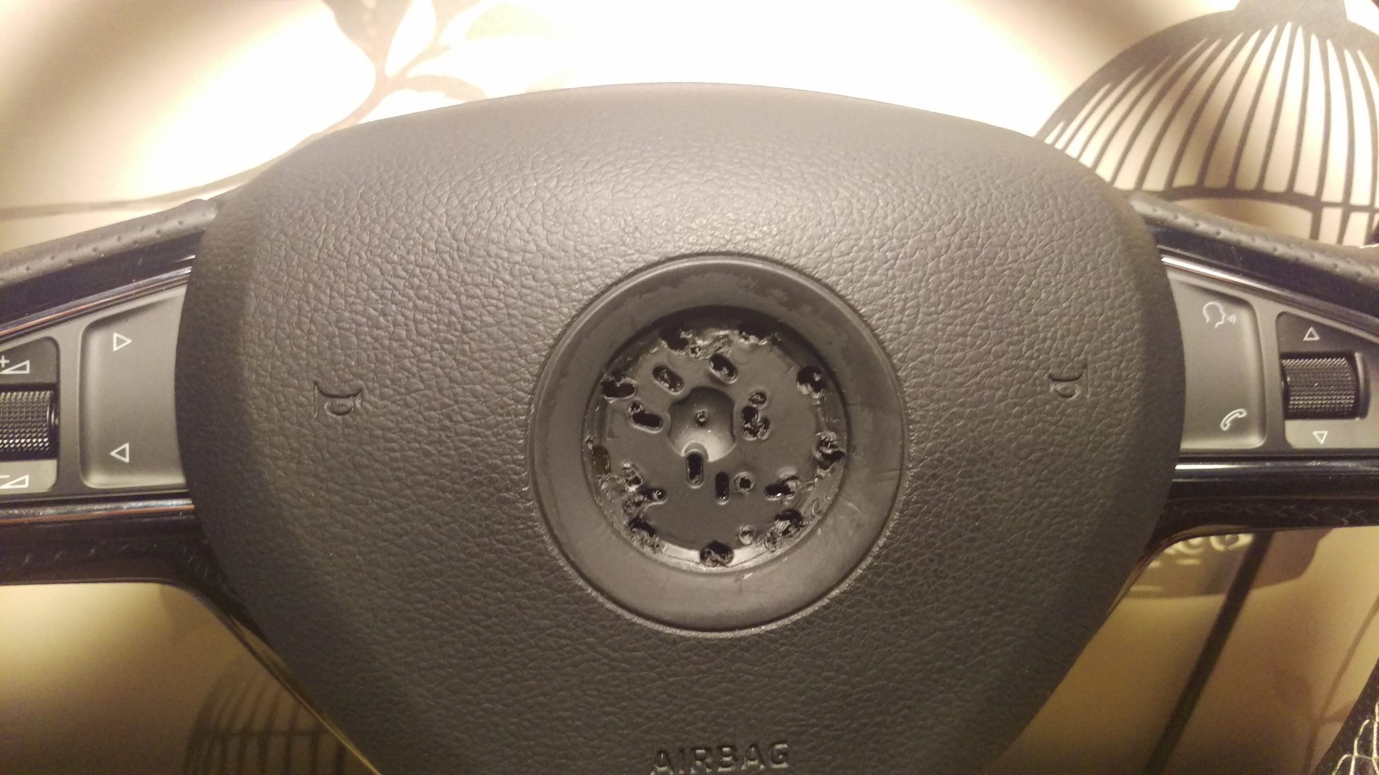

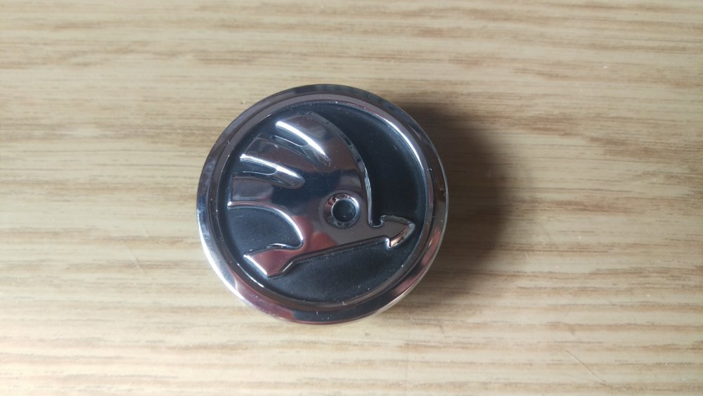

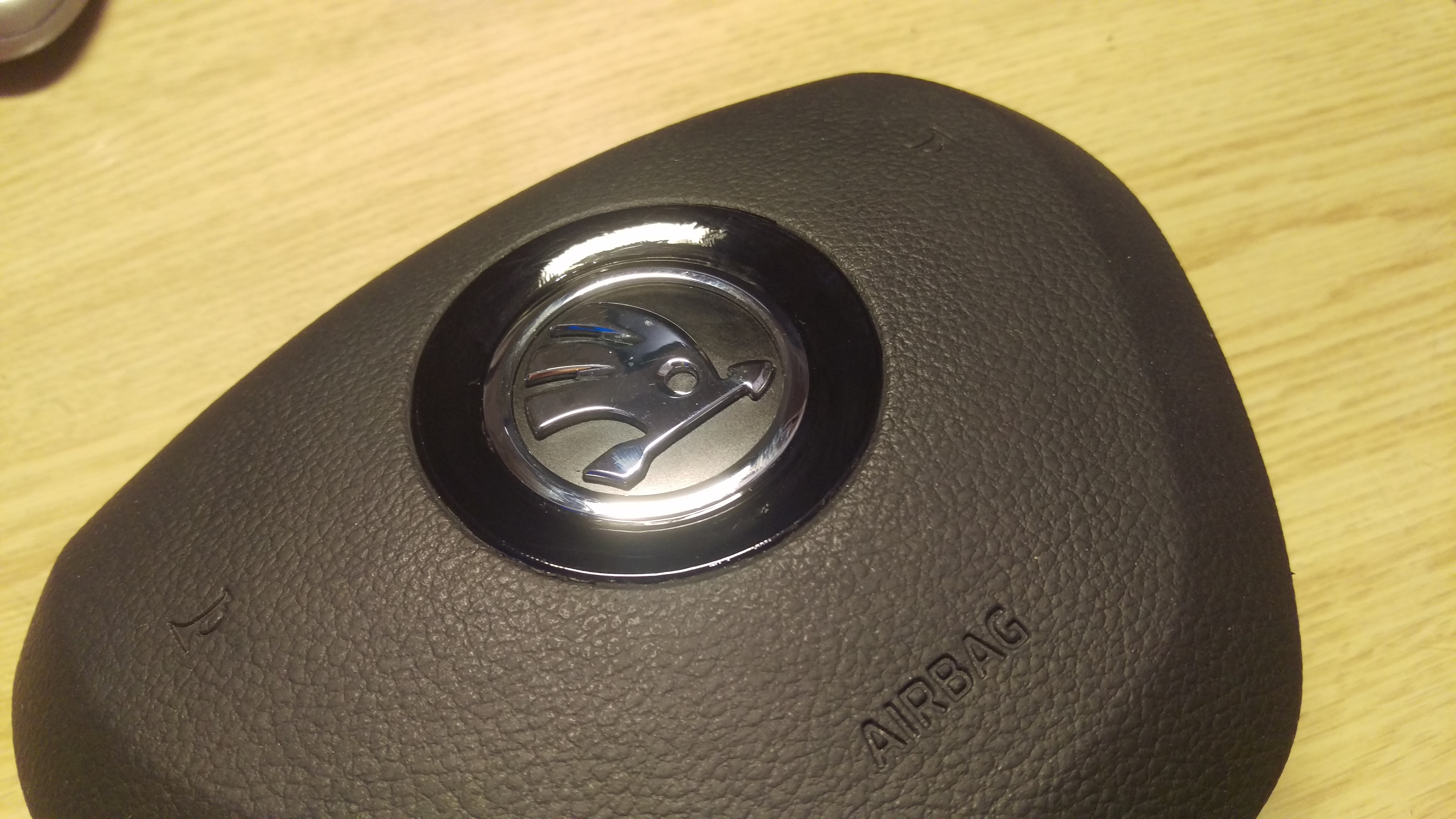

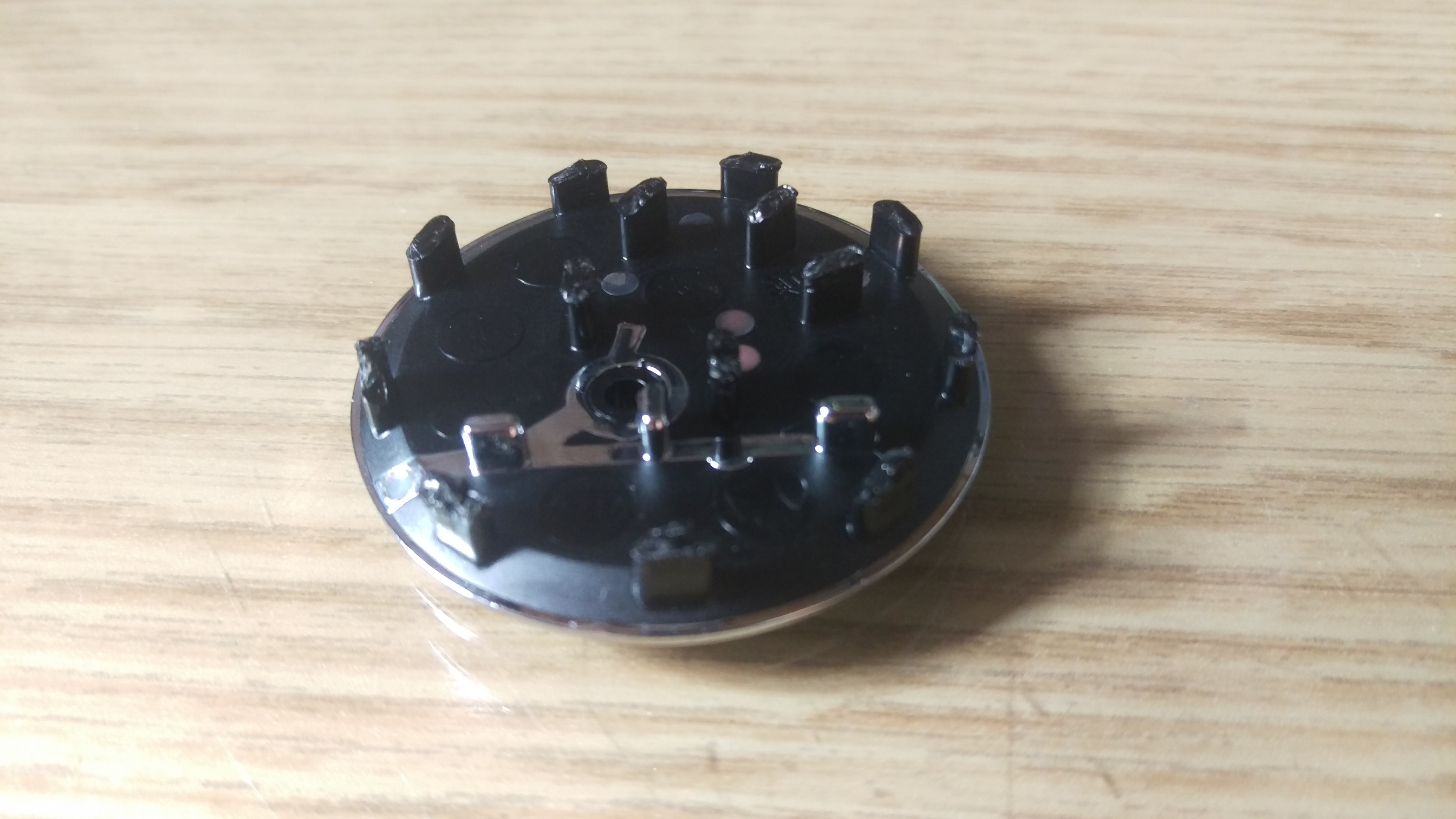

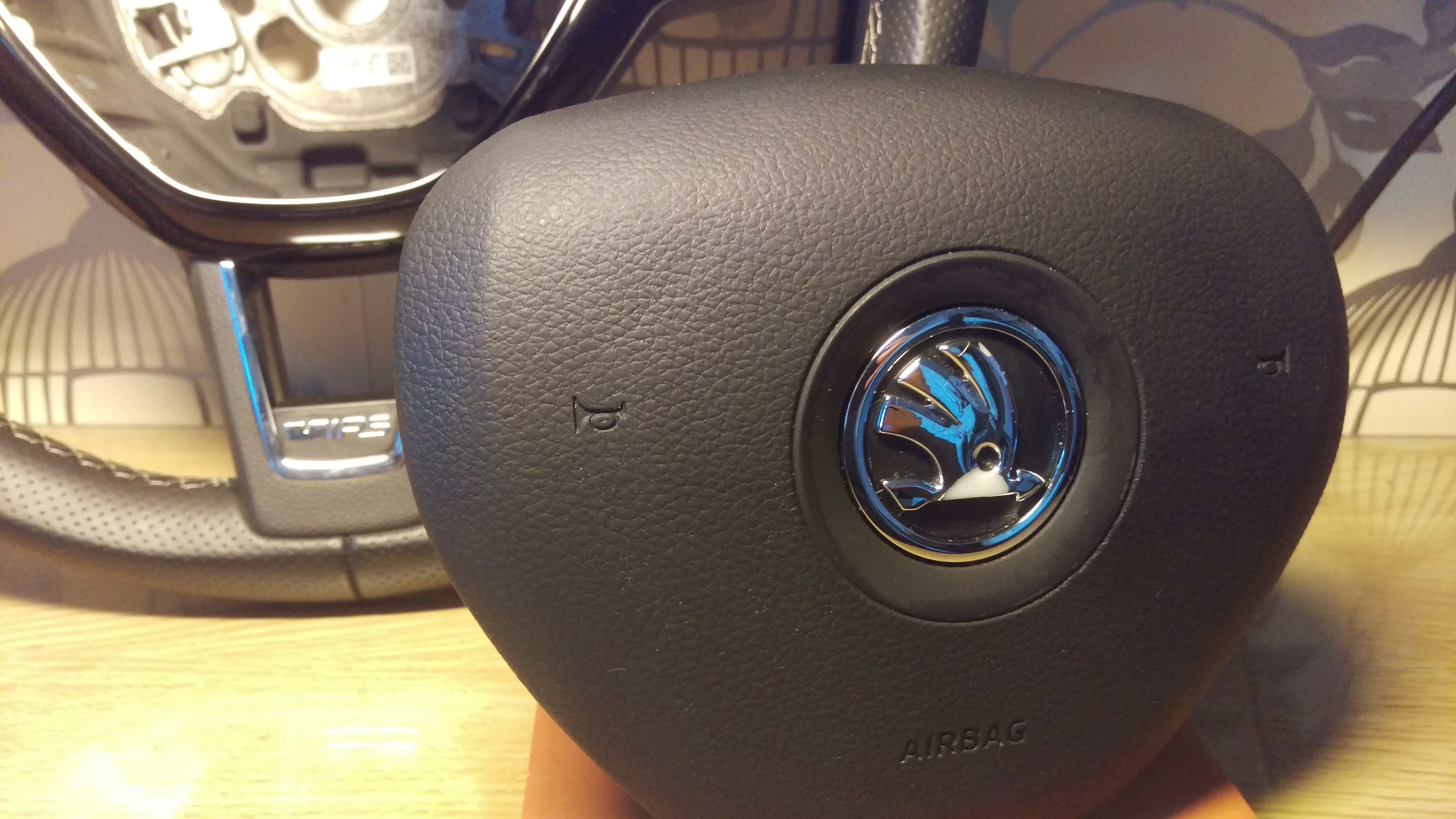

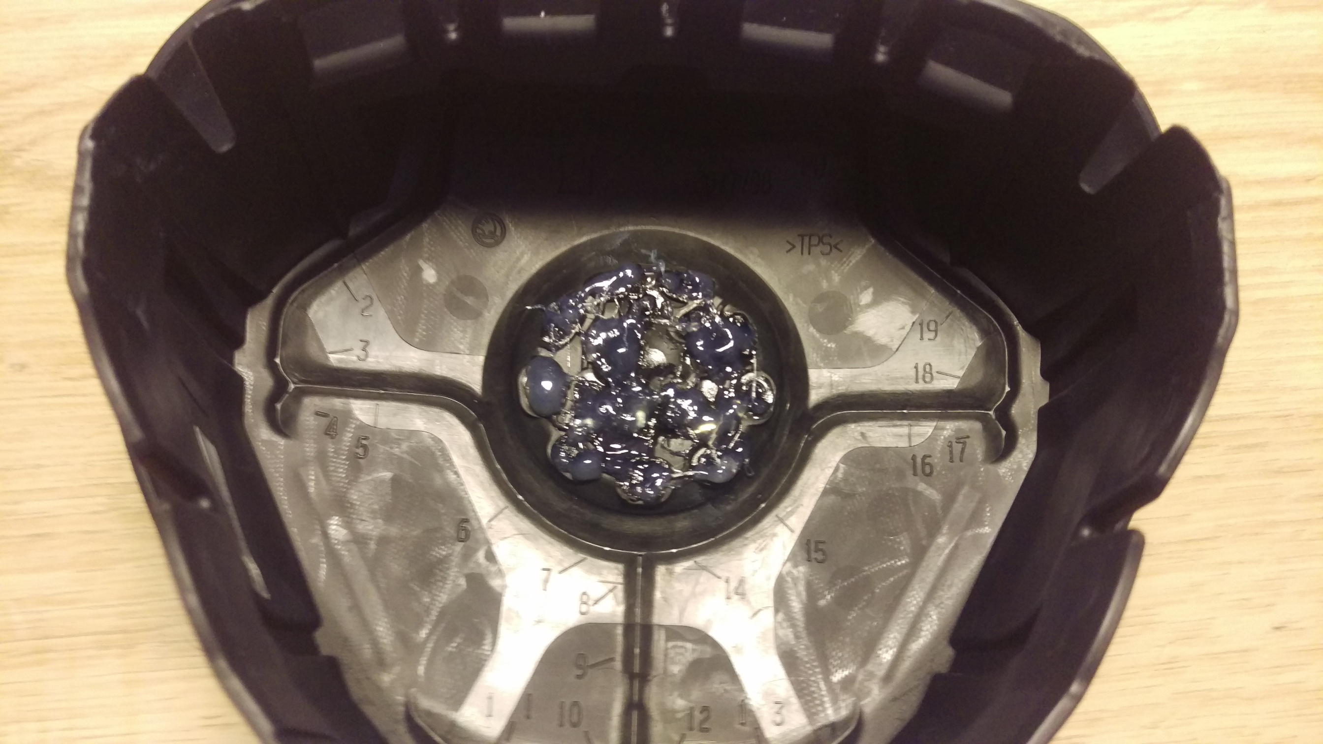

So I obtained 2no. badges from the top flap of deployed airbags from a breakers.  They're easy to cut off, then break off the plastic blobs on the back of the badge.
The tabs don't protrude enough through the holes in the cover to melt and secure them.  This was my own airbag, so I used hotmelt glue on the back of the badge, superglue in the tabs in the holes and then filled with hotmelt on the back.  It should be secure enough, but if I do another one I may pilot some small holes in a few tabs and thread some tying wire though on the inside of the cover, then use hotmelt to secure and cover the wire.
I plan on doing my Octavia mk2, preFL airbag with a view to selling.

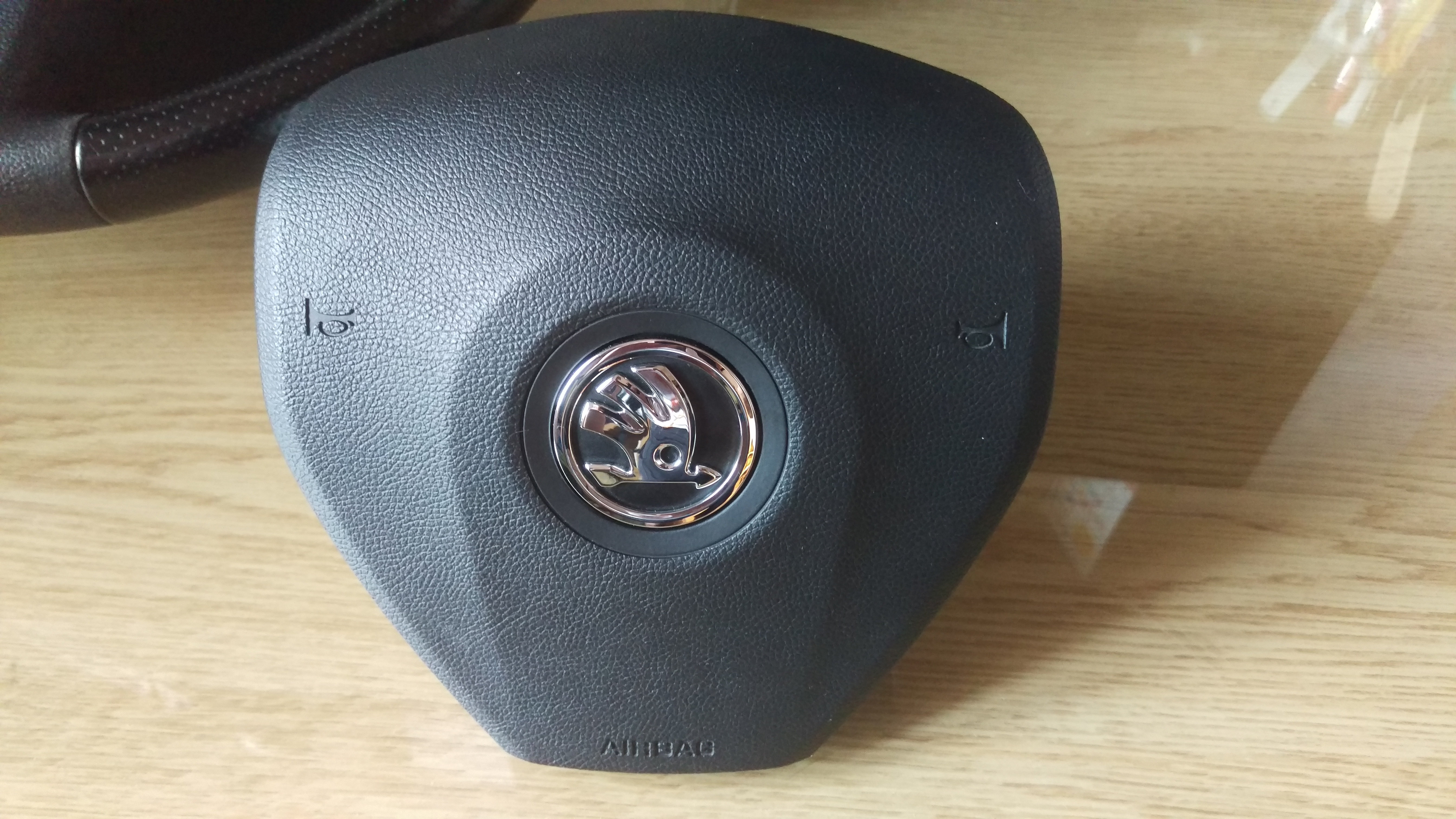

So, I had a spare badge and it seemed rude not to change the badge on my original pre-facelift Octavia vrs wheel:

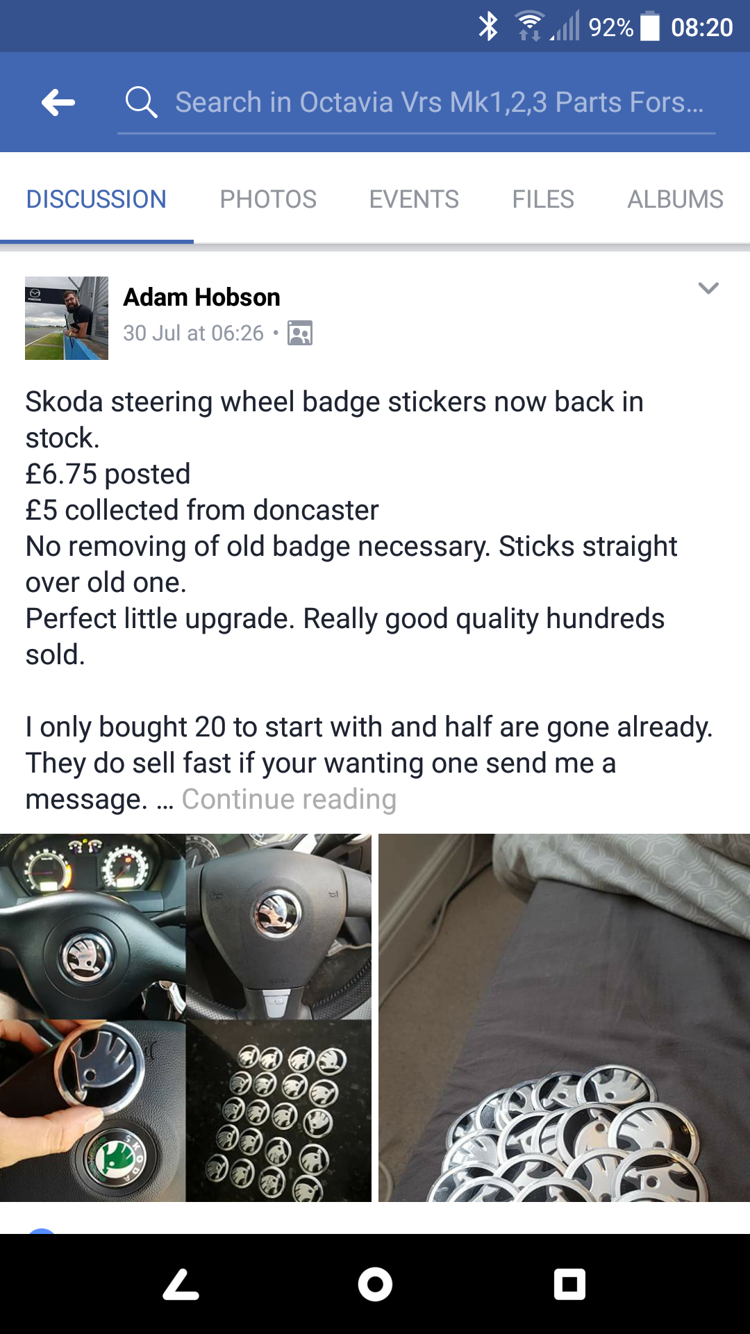

This guy Adam Hobson has them for sale on Facebook
Pity - I don't use facebook
