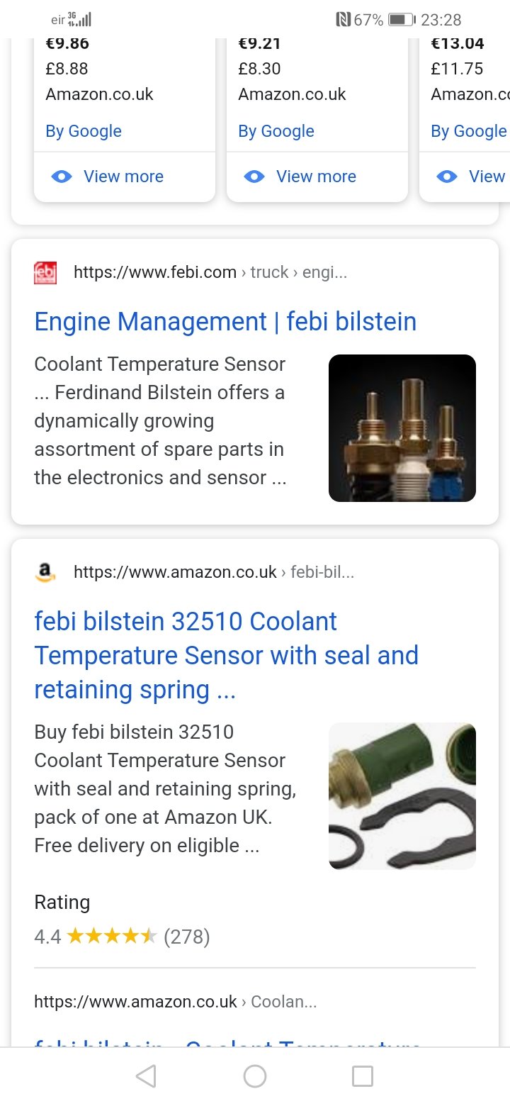

The febi bilstein may be ok as it is the same colour green as the genuine VAG unit. If you can find someone local with VCDS, they could read the temperature indicated to the ecu by the sensor. And while they are doing that, get them to do a full VCDS diagnostic scan.
