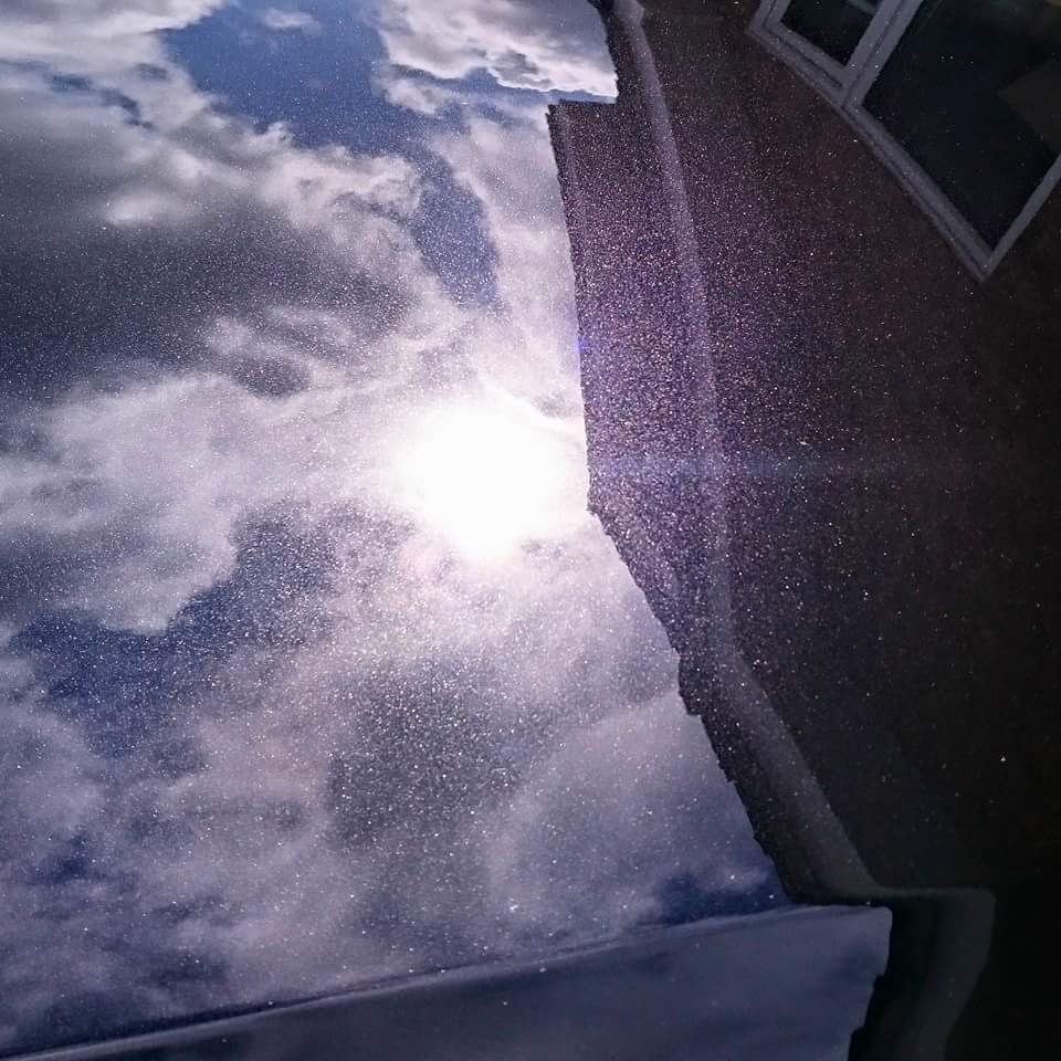

Buy a clay mitt, no need to dry and then clay.
Got my paint looking like this recently... 125k mileage.
Approx 25+ hrs spent on it. Will be protected for 2yrs now.

Great flake pop, what coating have you applied?
That was prior any coatings, but I applied carbon collective platinum paint and then oracle.

Any particular reason why you topped CC Platinum with Oracle?
Because that's what its for.

Oracle as a topper to Platinum?
Really?
Please give more info
Cheers
Oracle is a multi use sealant in this sense. You can coat plastics etc with it to restore the colour of them but also use it as a gloss enhancer to paintwork as well as added protection and durability.

Thanks for your reply, not used Oracle, but if you get 2-3 years as they say then happy days :)
Thanks for clarification
