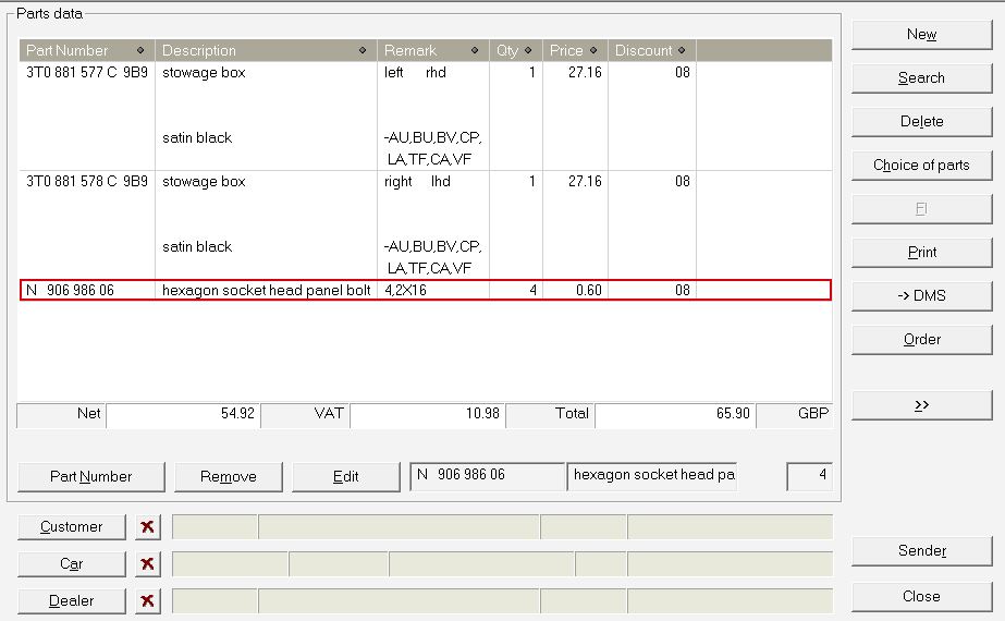

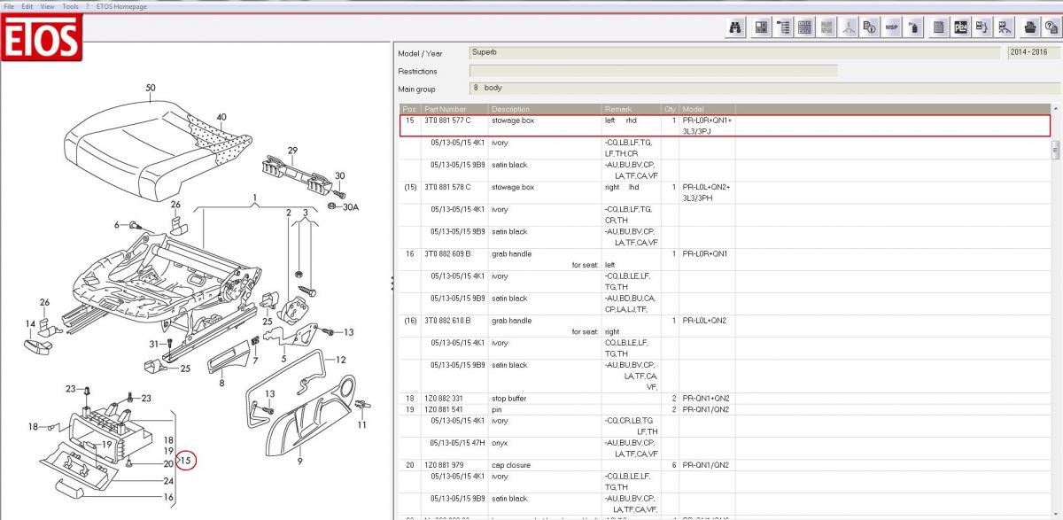

This is the info from ETOS ref part numbers...  I think it would be 2 boxes and 8 screws to do both...
It seems that "officially" you have one fitted depending on RHD or LHD.... I can't see a reason why you could not fit both ;) Not mega expensive....
