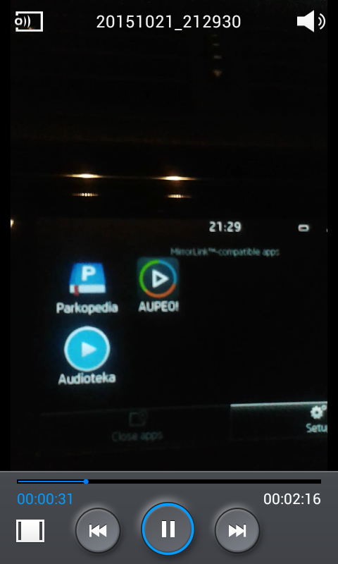

Hello all.
FYI - Mirrorlink seems to work with Samsung Galaxy A3 LTE Android 5.0.2 on Skoda Fabia III Bolero MY15 Mirrorlink only.
Cannot say anything about performance, stability, etc. just that - it connects and shows apps.
IMPORTANT: you must have at least ONE certified app installed on your phone to Bolero connect with your phone. If you have none, Bolero will give you error messages. I have installed Parkopedia, Aupeo and Audioteka. After doing it I connected my phone by USB, chose Mirrorlink and VOILA it shows apps.
Here is the proof (sorry for quality..).
Cheers,
