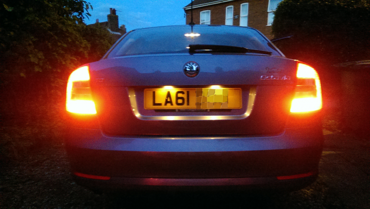

Twin Rear Foglights Enabled on a Facelift
Well done Eddie - I can see your assistance may well be sought out by a good few people in the near future as you seem to have conquered one of the last 'problem' areas with the FL! :thumbup:
BTW, what's VCP?
Well done. You'll be hounded by many FL owners now...
I popped into see Ed earlier tonight and I'm also happy to confirm that it's completely possible with a FL via VCP. It won't be possible via VCDS unless they add more functionally unfortunately.

Just yesterday I swapped my headlights over to LHD ones and ran a crossover cable to switch the rear fog light to the left.
I think I will have to get both fog lights enabled as it looks so much better!
Hope I don't end up following 'Eddie-NL' with those blinding rear foglights..LOL

My pre FL has both working?
Pre FL can be done with VCDS very easily.
Something changed in the FL controllers that prevented VCDS from being able to do it.
Obviously Eddie has access to the right tools and the time to put into trying it on a FL.
Ah right, I'd read somewhere that they normally weren't both active. Didn't know the massive pre and fl difference

I have found this can be enabled with Carista. Is it just a case of fitting a bulb once enabled?
Sent from my Galaxy S5
Hate 2 rear fogs. Nightmare following cars like this.. looks like the brakes are on all the time :thumbdown: . Def not needed at all
As you are the owner of a 2008 car, you shouldn't have a problem anyway. It was just from the FL that the 'problem' started.
The bulb will already be fitted.
Just double checked it says rear fogs on/off mine are now set to on. Although only 1 bulb on. Will check tomorrow to see if another is fitted
Don't forget that's with the caveat that Carista is as good as VCDS with regard to that particular change.
I'm sure that people would be interested to know (in another thread) what things it's actually capable of.
