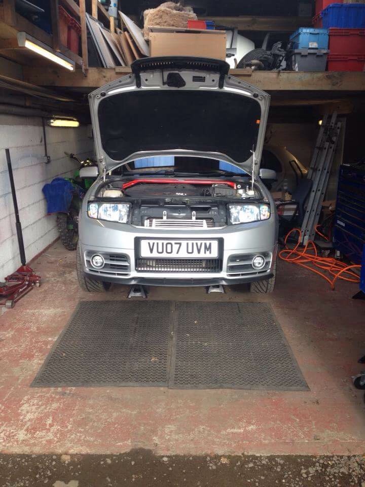

Just trying to add my experience of how I got a heavy Fabia gearbox out of a tight Fabia engine bay on the driveway without the luxury of a 4 post ramp and gearbox jack.
However the OP chooses to do the job will be up to them. HTH.

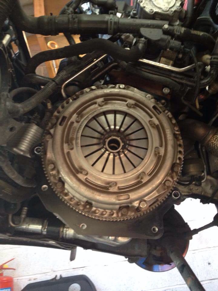

A few pics from one I've done.
