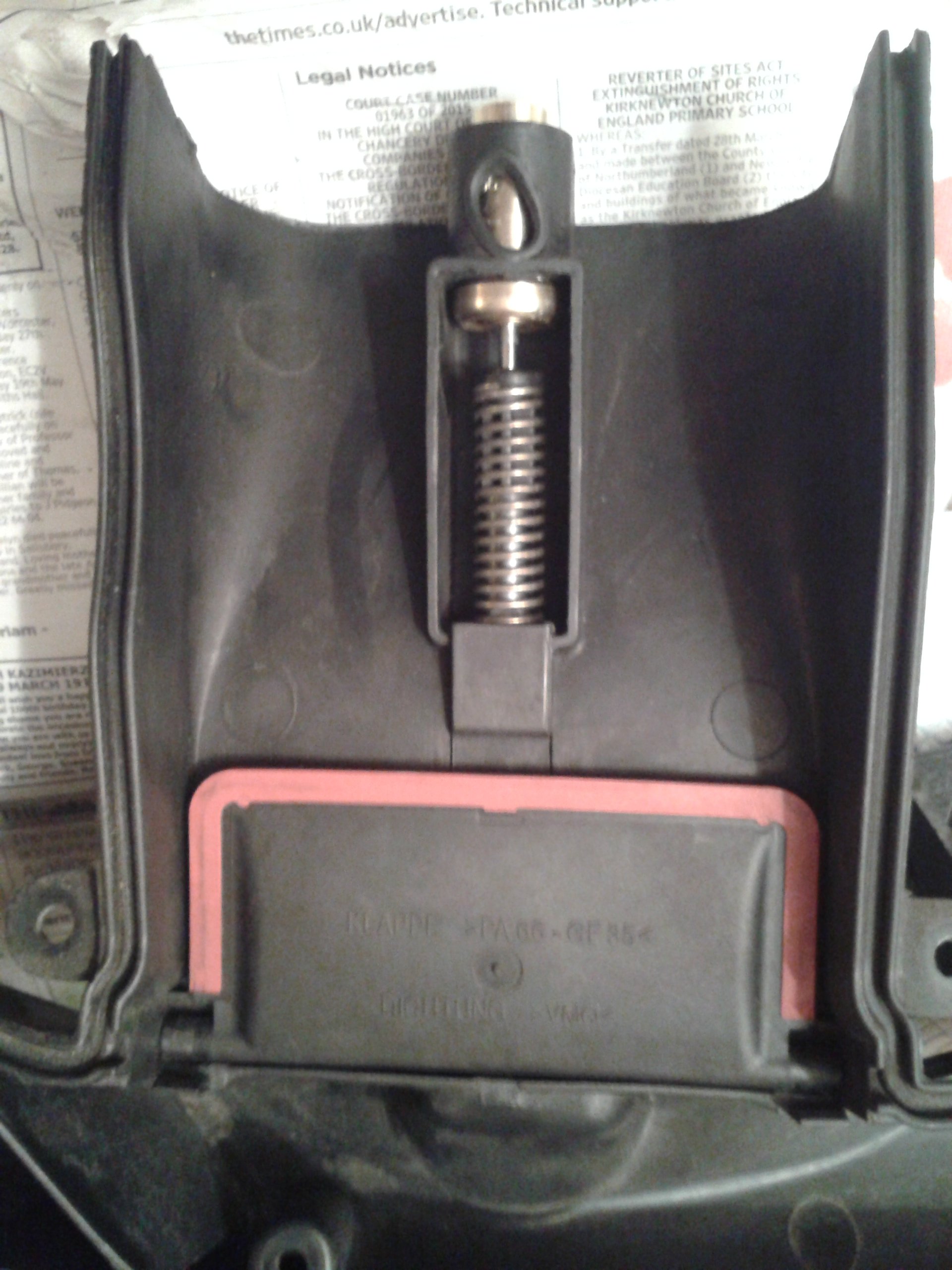

The image below shows the airbox flap arrangement in the cold-air-only position (I think!, it was a while ago now), with a working thermostat (albeit one off a Volvo, but that's irrelevant, I hope). Note how much steel pin is sticking out of the brass housing of the 'stat.
As these stat's lose wax, that pin sticks out less and less at a given temperature (this photo was at room temp, 21C or so, I think) until they don't do anything at all, and the flap stays in the no-cold-air position. Try warming the brass body with a hair-dryer etc. and see whether your pin comes out to play or not.
Last I checked my pin was inside the housing and didn't protrude at all.

Even when warmed up a bit? On my original, the only 'part number' info of any sort was a stamping on the end of the brass housing "15-23".I suspect those are the temperatures at which the pin is fully in and fully out, respectively. So it shouldn't take much if any warming for it to protrude of it's not waxless.
There is no protrusion so should I assume it needs replacing?
