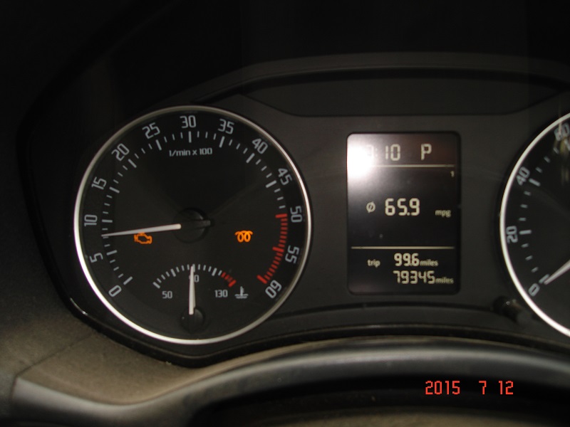

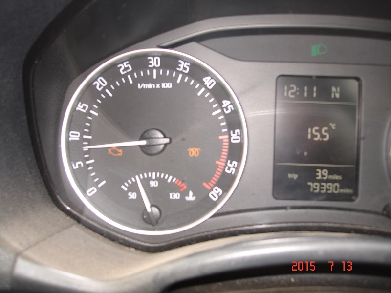

Well, well, after driving 50 odd miles to Belfast, stopping for a couple of hours and restarting, the flashing glowplug symbol  light came on,I  pulled in and captured on the camera, then after a furthur 40 odd miles the EML light came on and stayed on, along with the still flashing glow-plug symbol light, again I got it on film.
Both lights stayed on until stopping in the local village after some 130 miles, after when the EML light only re-illuminated.
So off to my local Indy Wed for a diagnostic, hopefully able to get either a print-out or a photo of his LCD read-out.

I like you even more Marcus now I've seen the build-up of dust in front of your dials  :D

bloody cheek Silver, I cleaned them special like!, cos  I was that affronted after I reviewed my first photo attempt!
cheers
m
