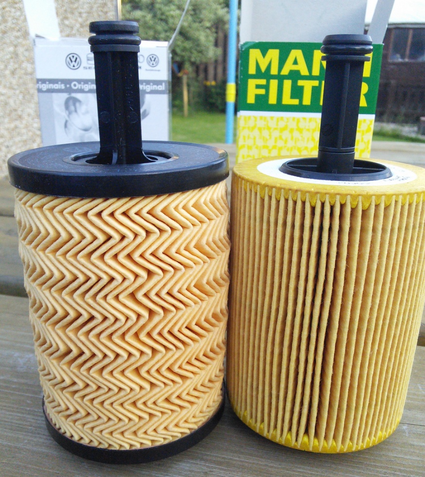

I just checked the Mann filter against a Skoda filter and the differences are:
1) The OEM filter has a zigzag fold paper element giving a larger surface area, the Mann filter has a straight fold.
2) The OEM filter has a black hard plastic top, the Mann filter has a rubber/glue compound on the top but no hard plastic apart from the tube in the middle.
3) The OEM filter is approx 5mm or 6mm longer than the Mann filter.
I wouldn't be happy using the Mann filter so will just use the Skoda filters.

Here is a pic of the two filters. You can see the Mann one is a bit shorter.

Filter might not actually be shorter. As the genuine one has a plastic top

Thanks for the picture, it appears both the filters you have shown are supplied by VWAG under part number 071 115 562 C:
http://forums.tdiclub.com/showthread.php?t=385465
From the above link it appears the one you pictured on the left is probably a Purflux filter and the right is obviously the Mann - both are OEM.
Edited by 0wl
Ah, I see. So the Mann one should also be fine.
That puts my mind at ease. I have only ever received the "zigzag" ones from the dealer over the last few years.
