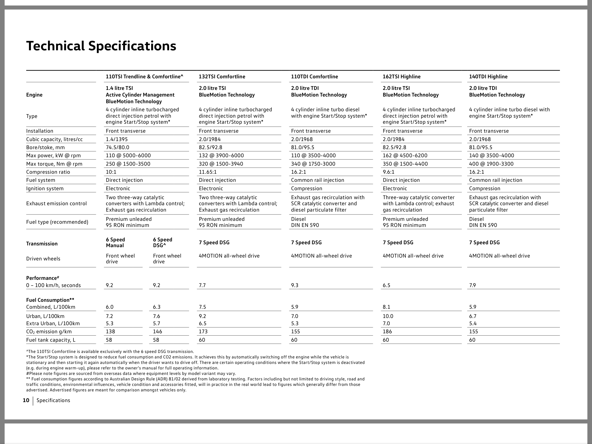

I've been looking at the 2017 Australian Tiguan's specs which, strangely, refers to SCR
AND
EGR as being part of it's emissions controls
There is no mention of any Euro standard it meets.
Euro6 is mandatory here from July, so it this sloppy editing or a transition model of some sort?.
Proberly all the reject engines they've salvaged for the United States!
SCR equipped vehicles still use EGR coolers.
  • Sponsor
Indeed.  SCR just means you have to use less exhaust flow through the EGR circuits than you would without it.

It intrigues me that they make no mention in the Australian specs of meeting any standard but they do in the U.K. one.
I wonder if they have reduced the capacity of the EGR's cooler also, due to there being a cleaner burn, and thus a lifespan no better than the old version.
So what does it achieve that post combustion AdBlue treatment doesn't do?.
Is it involved in control of blowby gasses?.
  • Sponsor
Reduces the amount of NOx created in the combustion chambers.  Prevention better than cure, kinda thing.
Reading about the supposed advantages of SCR, it seems to say that the combustion process (temperature) isn't compromised and thus the higher temps mean less particulates to deal with, higher power and reduced consumption and CO2 emissions.
The significantly higher NOx produced from the higher combustion temperature is dealt with by the AdBlue ....I thought.
Not enough I guess.
Are you sure, I was led to believe cars were equipped with one technology or the other?
If you go back to the pics of the Tiguan emissions specs it mentions both, which has me thoroughly confused as to the reason.
Nobody has an answer as to WHY.
  • Sponsor
Am I nobody? Or do you just not believe me?
This document suggests that some euro6 vehicles do have both;
Quote
The majority of manufacturers have adopted the SCR route to comply with Euro 6 standards, either solely using this technology or in combination with EGR
http://www.arvalfleettoolbox.co.uk/media/6120/euro-6-guide.pdf
Huh?
Neither.
I just want to know why there seems to be a duplication in the method of controlling NOx emissions.
  • Sponsor
Egr reduces the need for post-treatment, so that the SCR reactor/catalytic converter doesn't need to be enormous, and adblue usage doesn't have to be matchingly rapid.
I thought I'd already said that, more or less?
