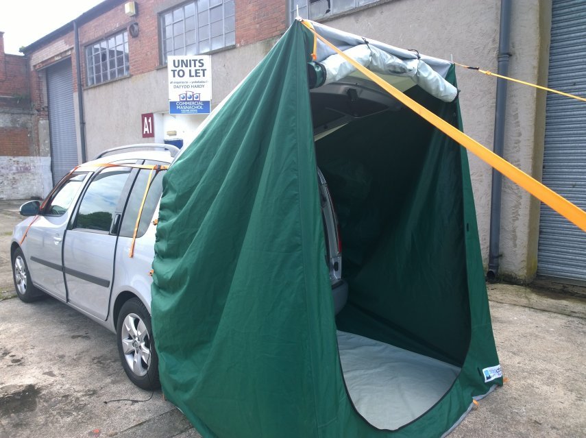

Hi camper,

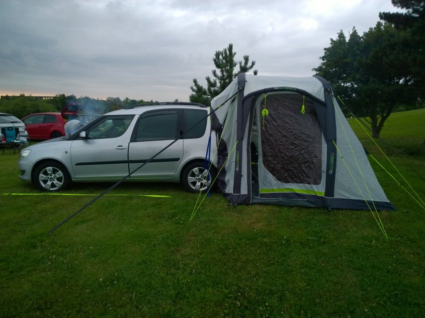

looks cool!! I used the hatch but i think it only fits because it is lowered. Therefore would recommend the original though must warn you it wouldn't add much space really.
Min my opinion you want some kind of gazebo/cook tent that you reverse right up to. Khyam do quick erect cook tents that would be ideal I think.

Hi there. Thanks for your reply and advice. It's a hard to find something as easy to use as the packashak. I would like a free standing tent so will look into that.

Hi,

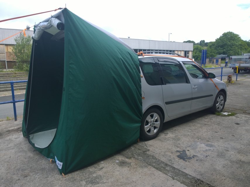

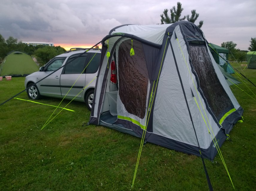

I think the Packa Shack "Hatch" is probably too small/low to fit very well. The Original is probably better.
The Amdro Boot Tent also fits (more expensive ~£400 - heavy duty cloth and a window)

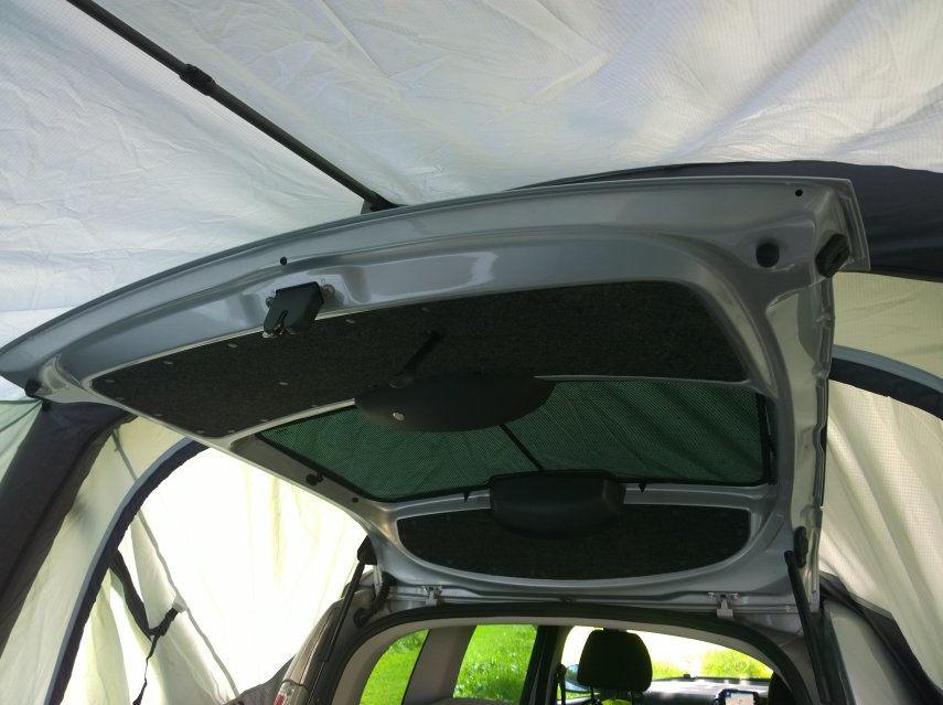

The Outdoor Revolution Movelite 2 - 2015 is great if you want more space for a longer stay (add 2 poles for extra main door awning) - Got mine for £300 on the bay.
Now called the Movelite T2 Low (very much the same as 2016 version that needs extra kit for door awning)
The Quechua Base Seconds pop up shelter also works on the side door and is cheapish, quick and small to pack ???

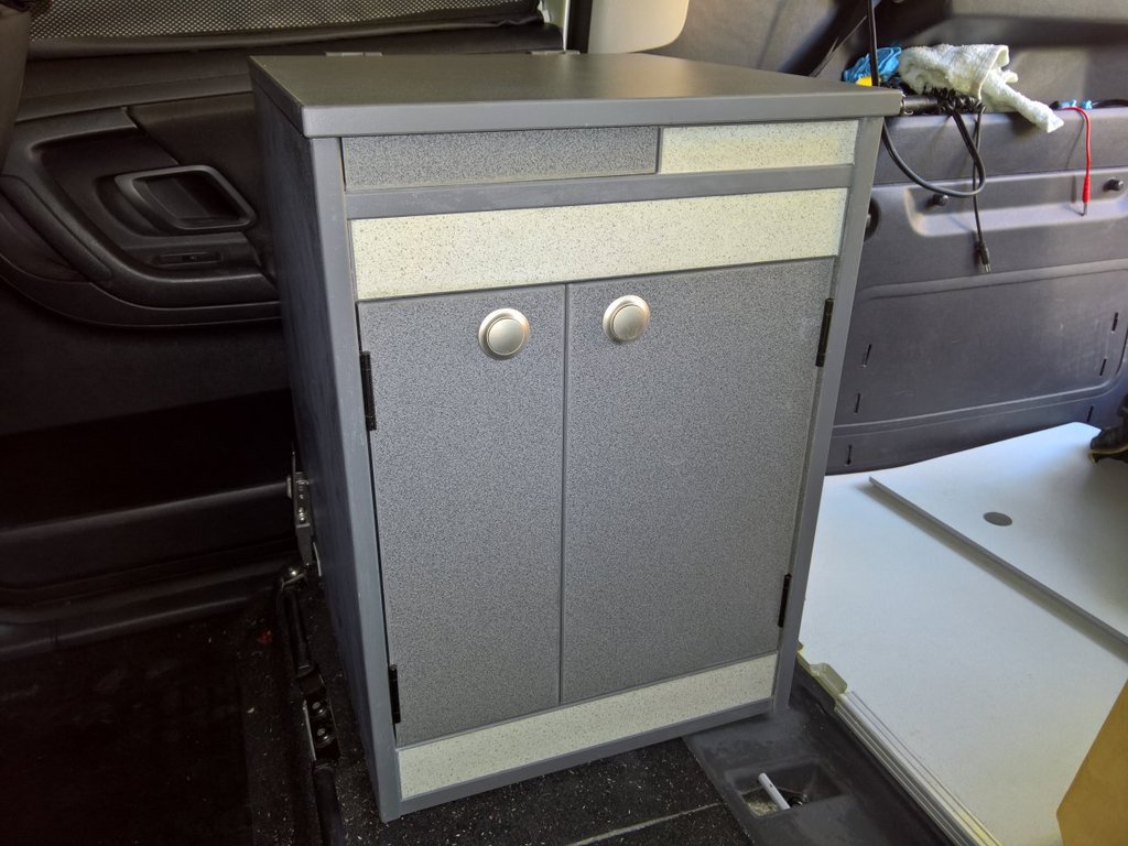

Hi,
That Peak Van conversion unit is very neat.
Nice Kit :)

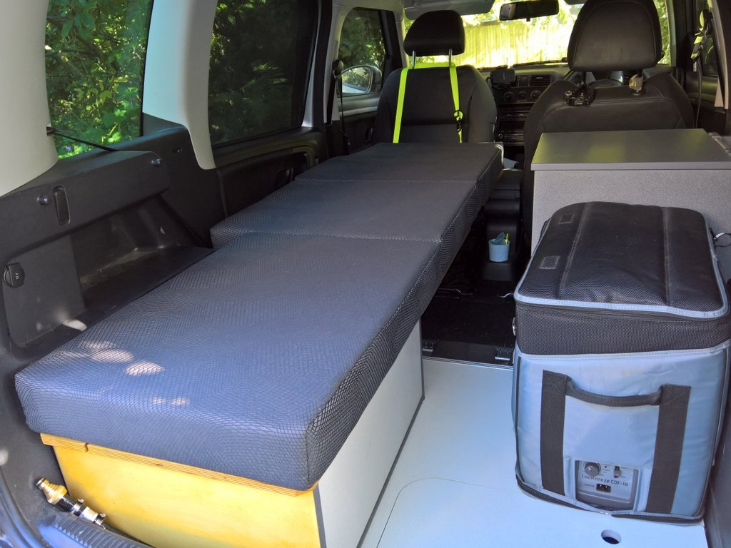

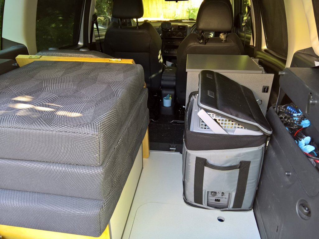

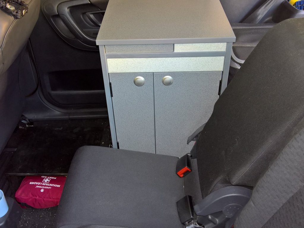

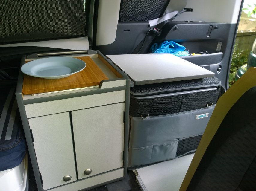

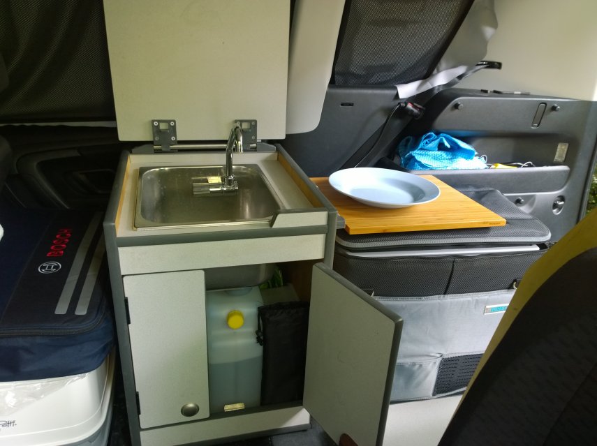

My AvonVale Mini-RV (?) is a single sleeper - Galley is used from inside (with care if cooking !!!)
Bed Out
Bed Packed
Galley Unit Closed
Galley Unit and middle seat (fold forward for access)

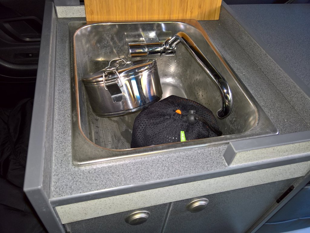

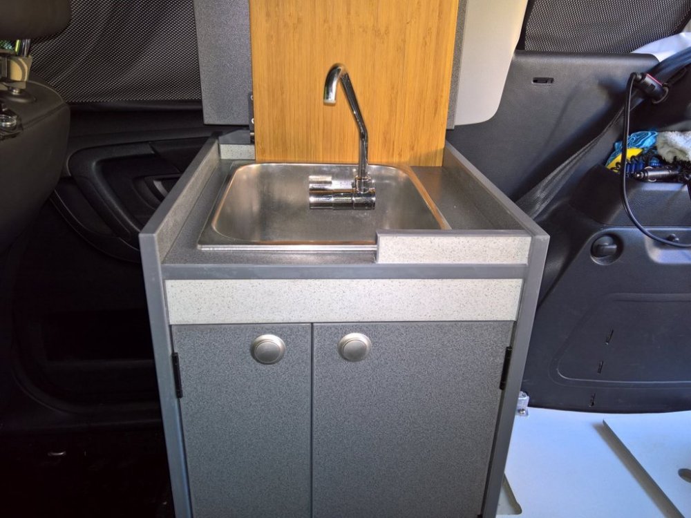

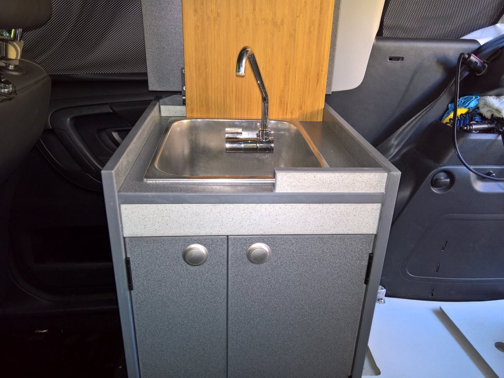

Sink

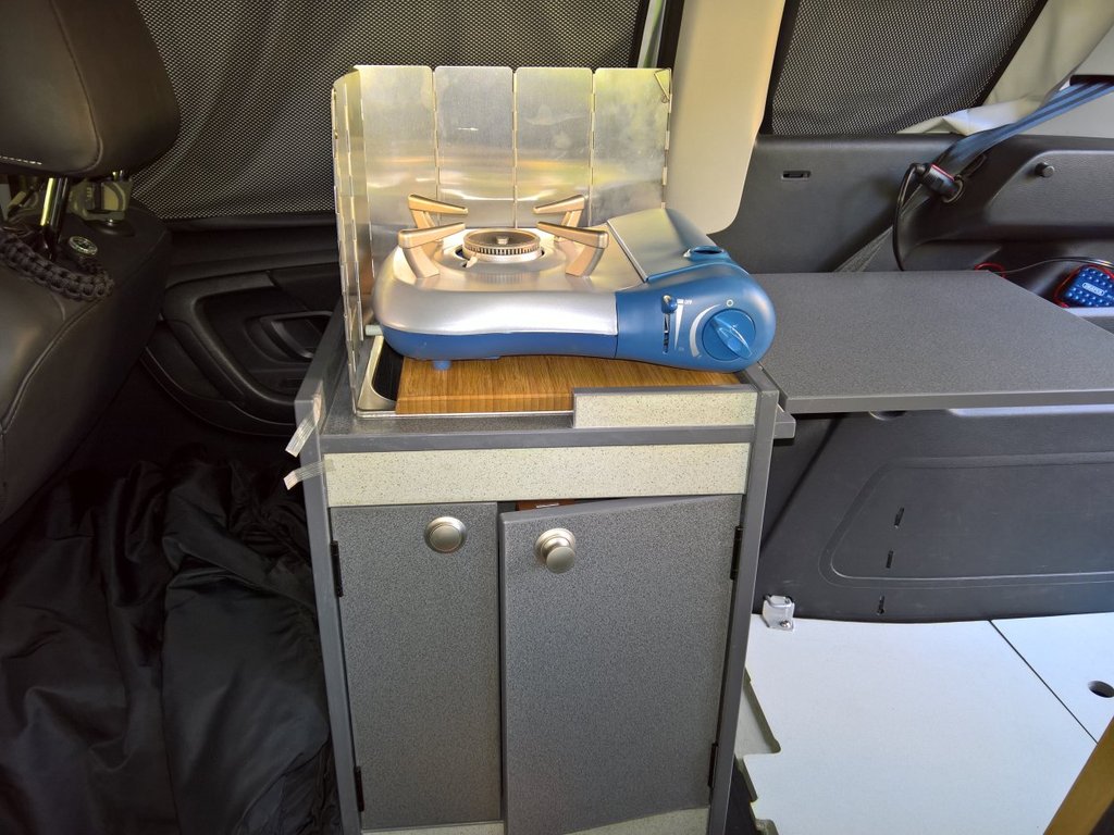

Cooker ?!?
Work Surface on the side - works with/without Freezer Box
Edited by petrev

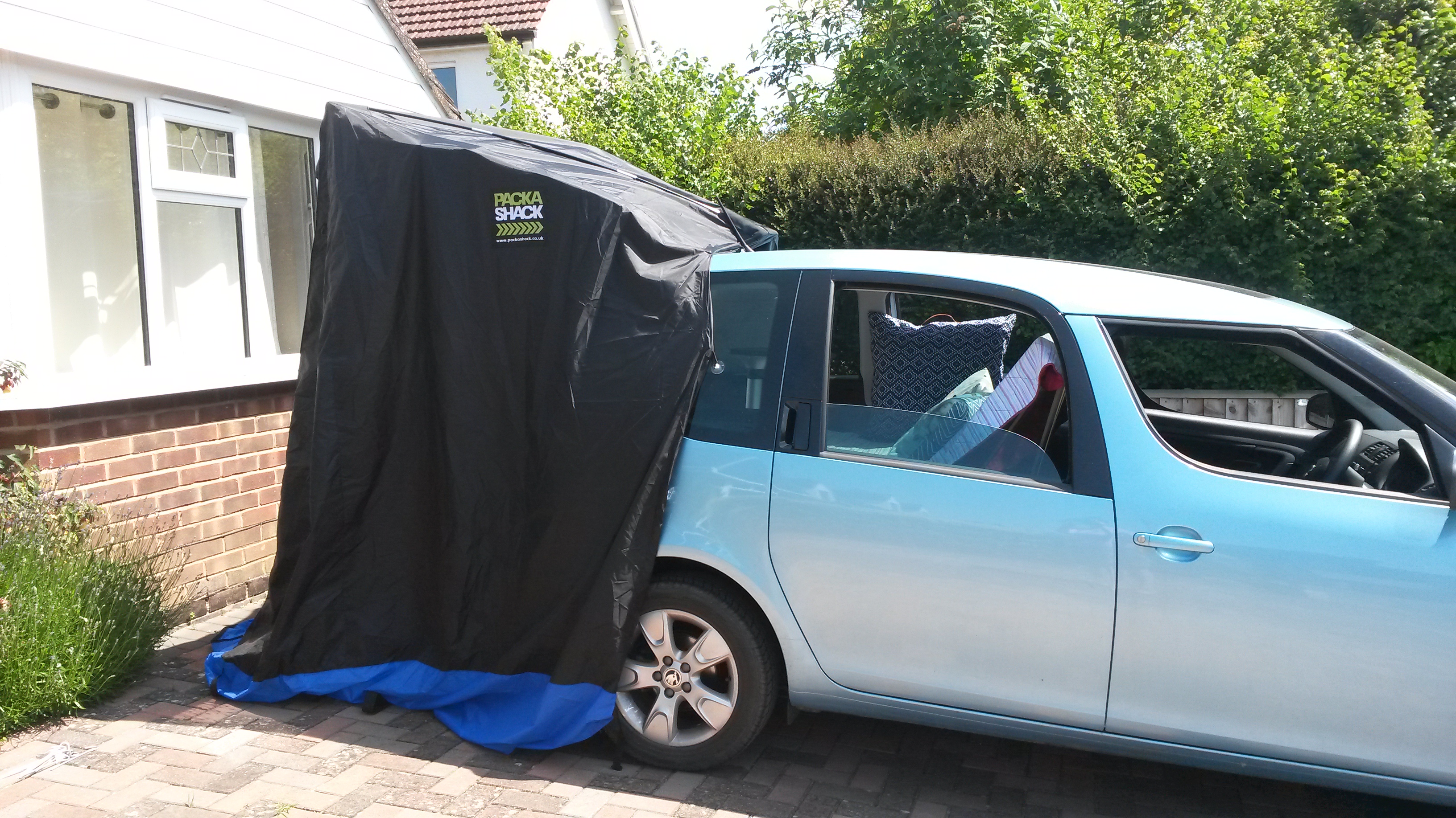

As I was unsure how suitable the packashak hatch would be I purchased one off eBay.  I am yet to go off camping with it but so far so good. I think my only drawback might be no windows and that my tailgate needs to remain up.
Bed Out
Bed Packed
Galley Unit Closed
Sink
Cooker ?!?
This conversion is amazing. Fantastic use of space. I am envious of the sink. The bed also folds away really small. It looks like you have removed your rear seats. Do you have a leisure battery or do you plug in your cool box?
Hi camper,
The "Hatch" looks perfect size so everyone feel free to ignore my previous doubts.
The left rear seat stays in and when folded flat it supports the bed. Middle rear could stay in but I prefer to leave it out unless needed.

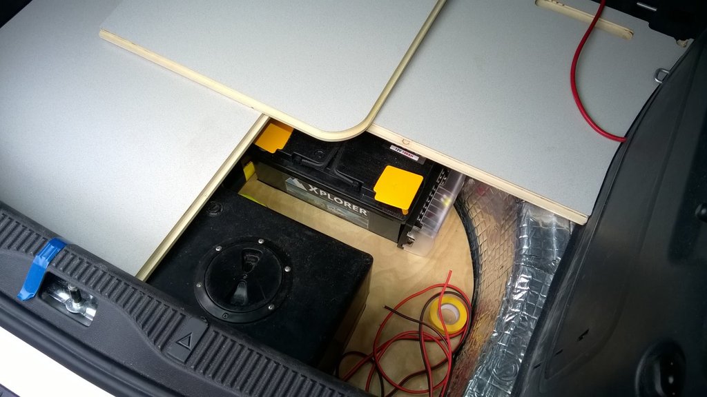

I have a leisure battery in the spare wheel well. The fridge could run off the normal battery as it has a low batt prevention cutout setting.
I also have a 20 litre fresh water tank in the well to leave more space in the Galley unit for storing pots and plates and toastie makers .....

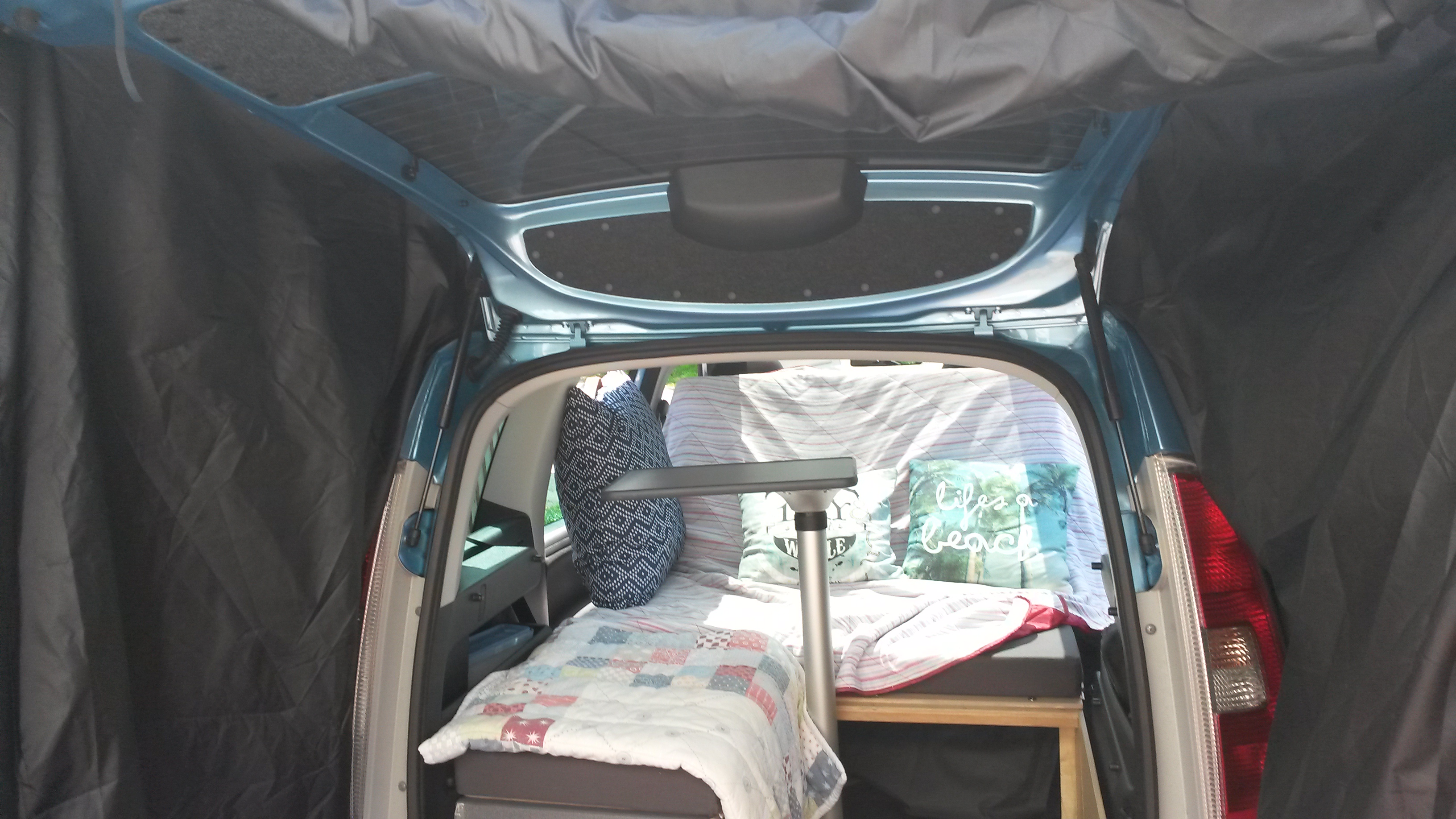

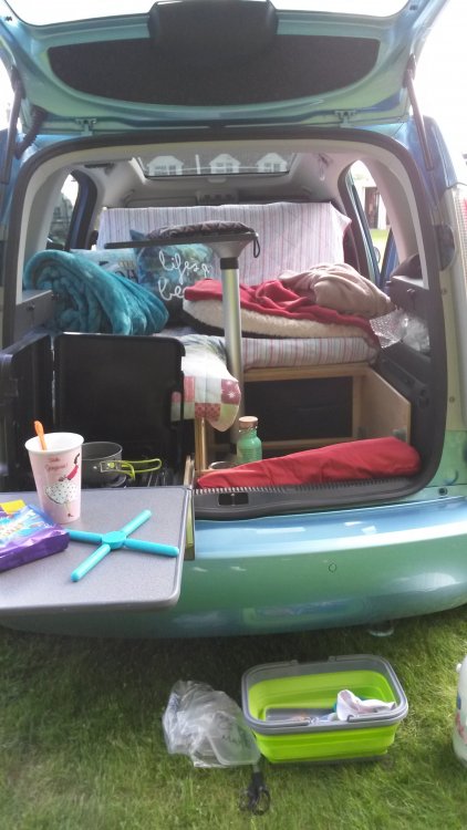

p.s. Useful addition - I have added a micro switch to open the tailgate from inside (see pic 4 of inside the awning) - it's on the wiper nacelle  - It only works when the doors are unlocked and is a simple waterproof push switch from Maplin wired in parallel with the outer hatch handle switch.
Edited by petrev
The tailgate switch is genius. I have found setting the alarm whilst in it almost impossible as it can only be done from the drivers seat. I then make an undignified mission impossible clamber to the back seats!
I came up with another option of using the interior door closed but not alarm switch under the radio area. It then enables me to use the boot opening button on my key remote to unlock the boot from the inside. I then tug the rubber interior tailgate loop handle and it opens.

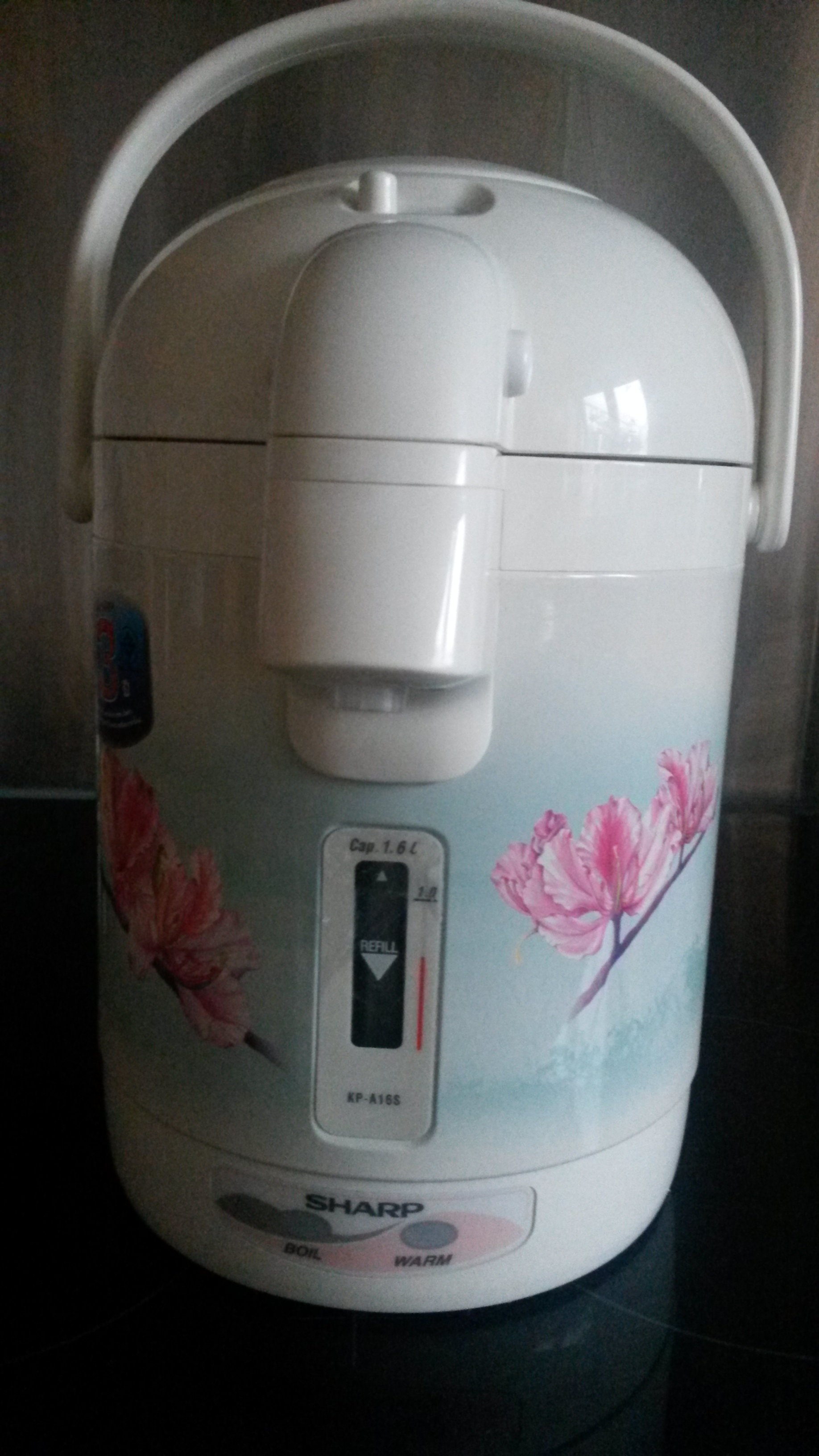

My water storage is an electric kettle 1.6lL with water pump at the top. I purchased when in Thailand and got the electric plug changed for uk. It's fine if I heat it before I set off or if I do a hook up. Definitely will look into getting a leisure battery. I hadn't thought of the spare wheel space.
My system works best with the seats remaining but I loose storage space. :(

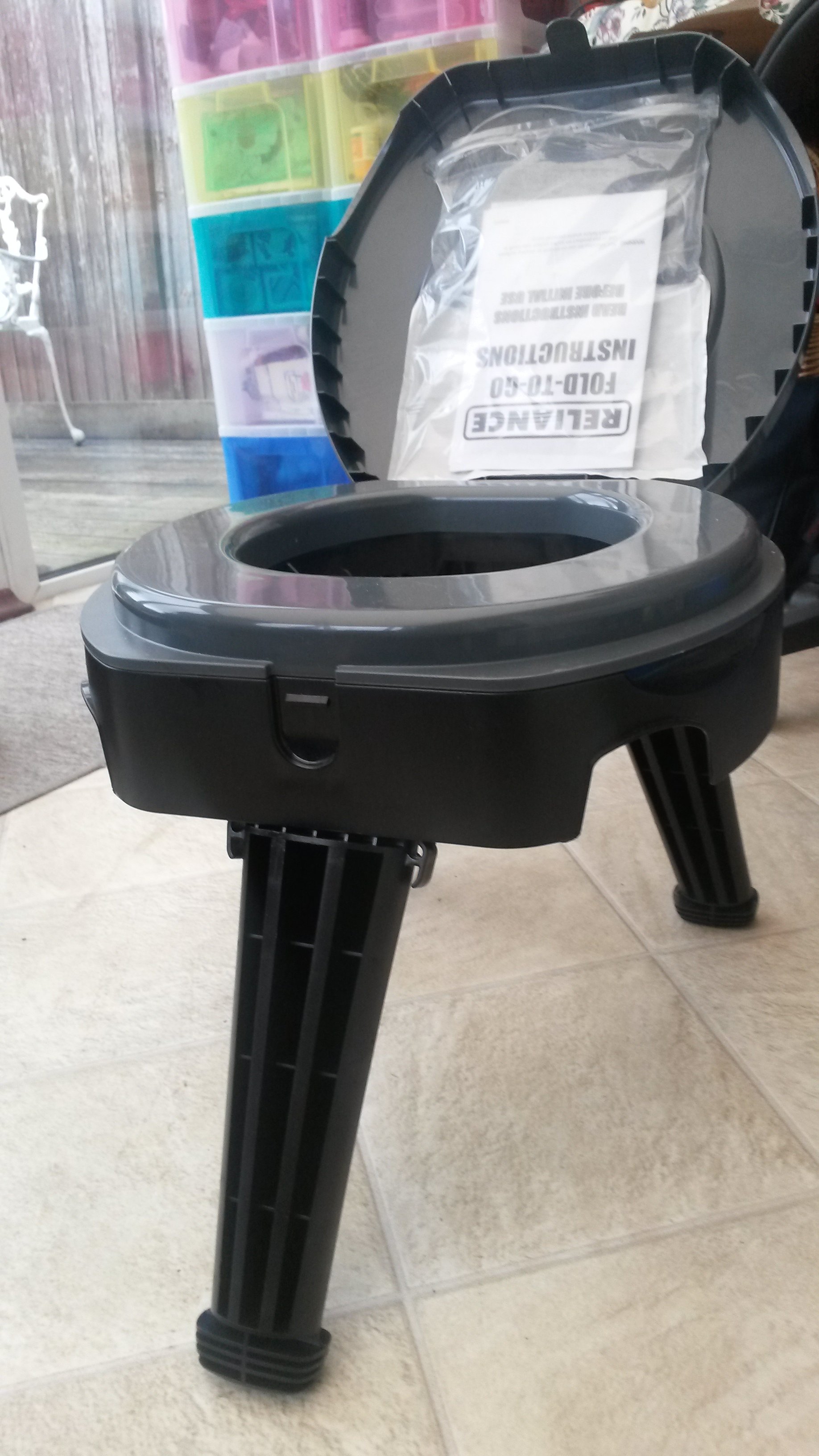

Another girlie thing I got was a reliance fold to go toilet where bags and soluble granules are used. It came from America. It's compact but only one leg folds easily!

That little kettle is neat. :)

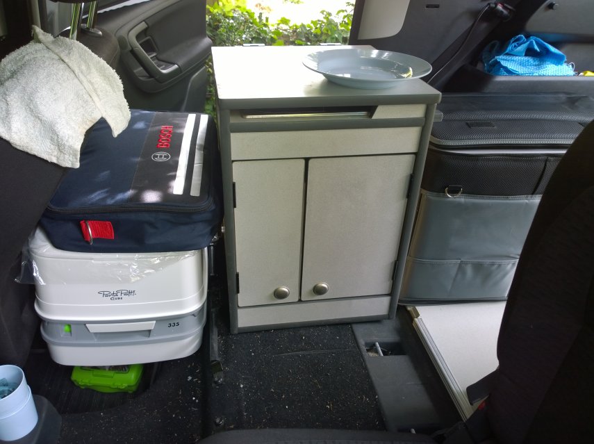

There is just room for a Thetford Qube 365 loo behind the drivers seat - I made a small shelf to bring it up 5-6 inches and it is pretty useable !!!!
I'll try to find some more photos.
Pete
edit: You can see a bit of the Qube in the last photo of the Galley.

Hi camper,
Battery (100AH) and 20L water tank in situ as they are being fitted ... (with a fuse box) ready for wiring and piping
The 15mm birch ply sub-floor is bolted to the wheel retaining point and fits around the battery and tank to keep them in place.

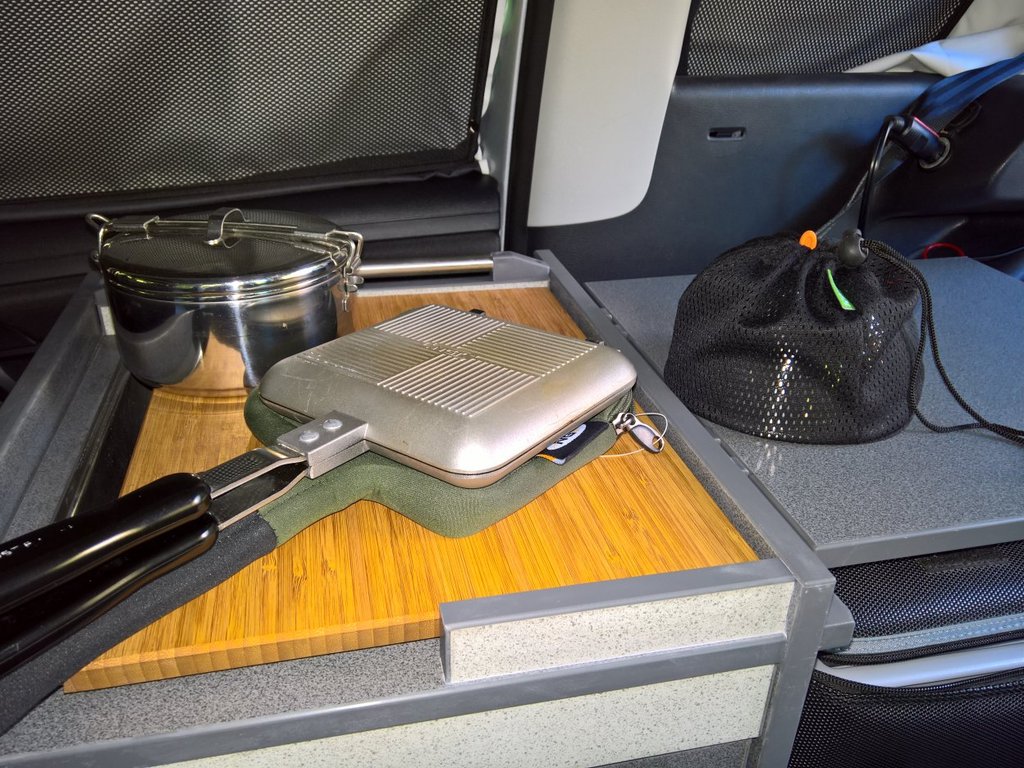

335 Qube with wet wipe storage underneath shelf ... cooker store on top !

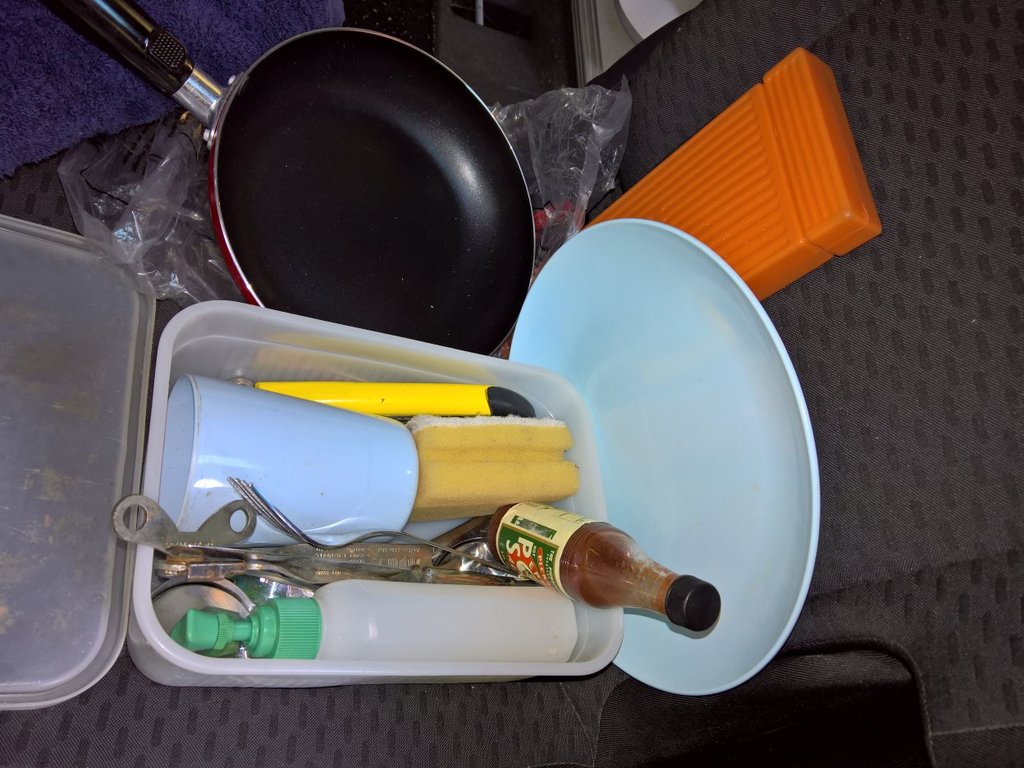

Galley storage for Waste and Fresh water - 2x12L Reimo canisters and a few plates and pans and odds ...
Surprising what fits in the little space ... Plates, box of bits (washing up liquid, can opener, hot sauce, pan scrub, Stanley knife, cutlery, cups ...) wind shield in orange case, frying pan, small towel ...
Pan and small kettle fit in the sink (need to make a bag for the pan)
Toastie Maker (with a neat little case) is a real boon - also heats up chips and fish if you have any left over from the night before's takeaway !
Pete
Edited by petrev

Hi camper,
You could try extendible King Poles or telescopic tent poles - May need 2.5m long ones, 2.2m are cheaper - you would have to measure up the Hatch Shack.
Other sites are available !
http://www.cotswoldoutdoor.com/equipment/tent-accessories/tent-poles (2.2 and 2.5m)
https://www.amazon.co.uk/gp/product/B00KDU6B96 2.8m !?!
https://www.google.co.uk/search?q=telescopic+tent+poles
If you put a Squash ball on the spike of each pole and extended them into the top corners it may well keep the awning up while you close your tailgate !!! Shack would probably have to be pegged out.
You could also use the same poles to make the door into an awning when needed.
Are  there two fibreglass poles to keep the Shack roof up with the tailgate lifted ? Both from one corner ?

Hi,
Amdro Boot Tent and Outdoor Revolution Movelite 2 2015 Pics (Direct-Links now blocked by Photobucket)
59870ee8f1d60_RoomsterRVCamperAmdroBootTent1.jpg.f153cb958e3214e4132ab88e14761567.jpg
59870f0eac549_RoomsterRVCamperAmdroBootTent2.jpg.e20cff6913973d01991d846e0b212250.jpg
5987104f33d1e_RV-InsideSide1R-ORMovelite22015.JPG.bdd988bc3f57c2d9b10886f6295812b4.JPG
Pete

Sink
598711ee3a161_AvonvaleRoomsterGalley3Sink.thumb.JPG.d7dcc43b9f7031dae6ab5642b5f8de0c.JPG
Cooker ?!?
5987124e1ee14_AvonvaleRoomsterGalley4Cooker.thumb.JPG.100fcc4cca78e9a8916344fcc607475b.JPG
