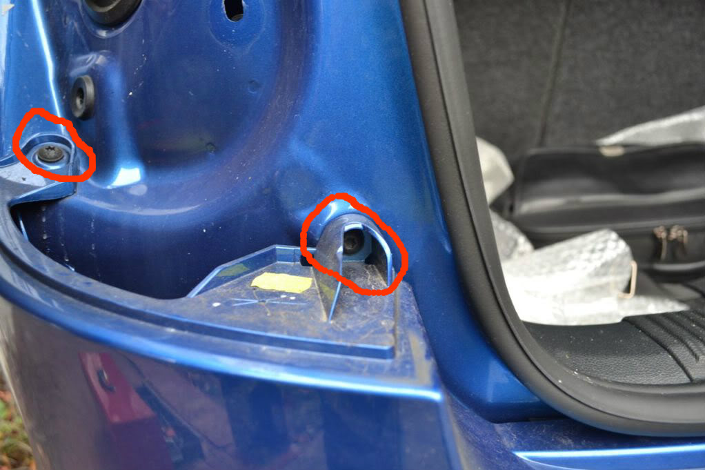

Ant-Vrs, I might be being stupid but where are these weights and how easy are they to remove?
mmmRacer, Yes I am still running stock tyres so I may try different rims or tyres in the near future. Its good to know it can get even better!
Stug they are tucked away nicely behind the bumper. Remove the rear bumper and you shall see, you can't miss them.
Brilliant thankyou LGM, that will be my next job then!
Google briskoda remove rear weights, vrspowered has described how to do it.
Thats excellent, thankyou goneoffSKion1.
Look in the technical bit I've bumped it for you
Thanks very much
