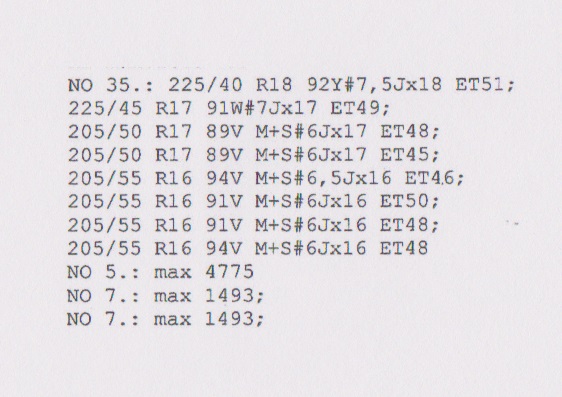

This is the section from the Certificate of Conformity for my car. You can see it shows wheel size, offset, tyre size AND speed rating.
Personally if it is written on this document I will follow it unless I apply for a change (and having done that a few times it is a bit of a pain) other cars may not have this specified, other cars may have H rated tyres on the list. The vRS will obviously have 19" wheels on it, mine does not. I do see "stretching" as relevant as the way I see it any deviation from this is a deviation, whether it be wheel size offset or tyre rating.
It may not bother most people but personally I chose to try to stay within what this says. Like I said if the worst happened I would feel confident that no-one could point fingers at tyres (or anything) if it is on this list.

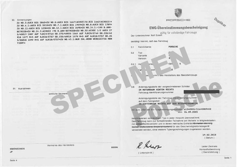

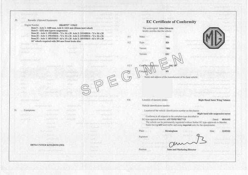

Some others I found.
This Porsche has H rated tyres approved for some smaller (winter) sizes
This MG does not have speed rating specified at all, so if you have one of them....Happy Days!
