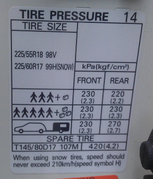

I don't know why VAG won't just do something like this which is from my Subaru and make it clear and simple. Our KIA has a similar sticker too. H will be fine on UK roads. I ran Ts on an older Polo without issue, as they're still way in excess of the speed limit (and the car's abilities).
I don't know why VAG won't just do something like this and make it clear and simple. Our KIA has a similar sticker too.
