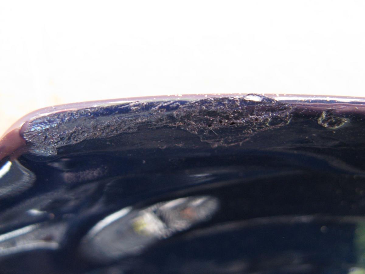

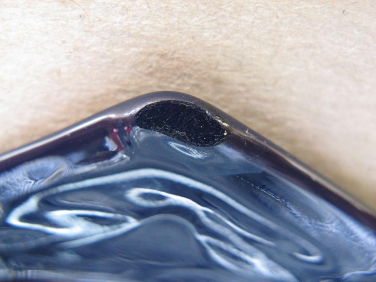

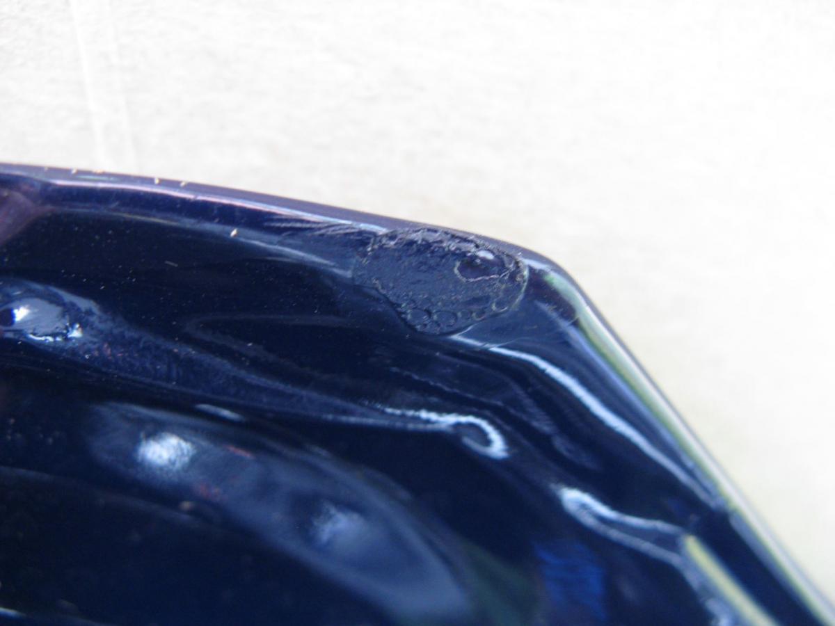

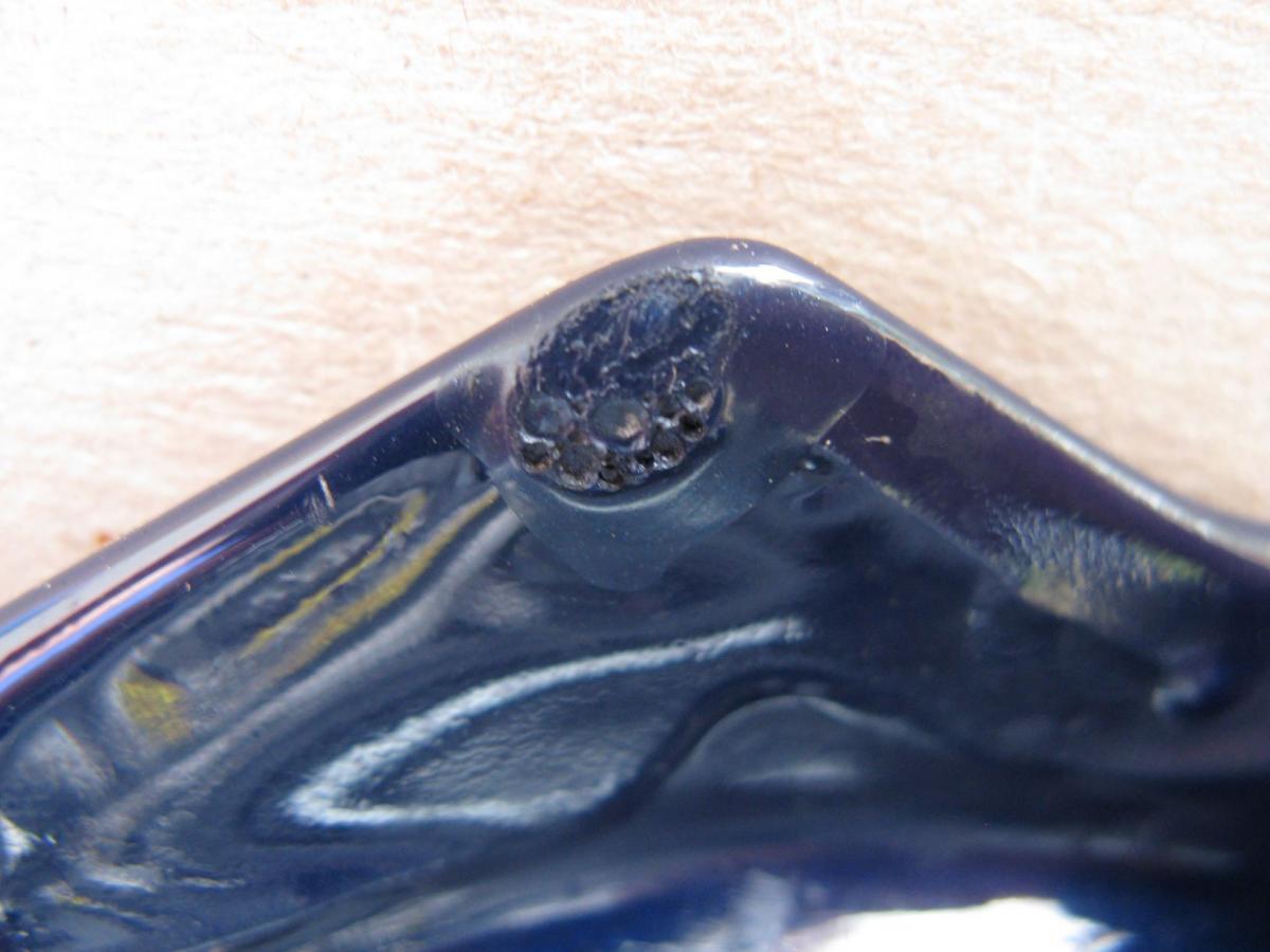

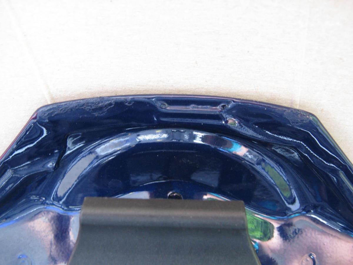

There seems to be a problem with the paint on the underside of the leading edge of my bonnet. The attached pictures are of the corners in front of the badge and above the headlights. What do you think?
Looks weird! I take it its a new problem? It wasn't there before? Has any maintenance been done on the car recently? Reason I ask is if someone had something on their hands and touched that area (hard to avoid touching when opening bonnet). But then the plastic release looks okay? So it would have to be something that just reacts with the lacquer?
Id say brake fluid could of done it, has it been serviced recently? As the technician could of been doing service on yours and changing brake fluid on another?
Edited by JoeFifty
Sorry, I should have said, it's a new car. I've had it a month and only done 300 miles.
Should of been picked up in PDi, call the dealer and send them the photos.
Looking at it its all on the leading edges, so the bonnet could of touched something in the paint shop before it had dried?
Looks like it has been put down on something when the paint was wet... Although could that even happen in the factory?
If it doesn't show over on the front edge of the bonnet, I doubt they will fix it.
It is painted so it wont rust, just not a very tidy finish. I'll have a look at mine to compare.
Looks like the seam sealer was damage while wet to me, then it's just been painted over as normal

I took it to the local dealer who had it inspected by Panelcraft UK in Swindon. They said the paint coverage is fine, but offered to have the whole bonnet resprayed under warranty. As the problem isn't visible from the outside I'm mainly bothered about the corrosion protection and I think there's a risk a respray could introduce more problems than it solves. So I'm going to leave it as it is and just keep an eye on it. If there is any rust they can respray it when it happens.
