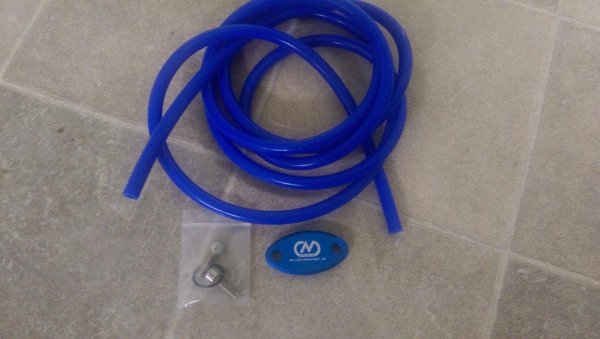

New blanking plate

New blanking plate and 4mm tubing just waiting for my resistors now

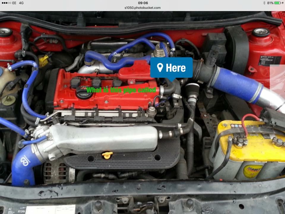

Can anyone tell me what this pipe is called and can I get a better one than standard.
Yea that's the one cheers kentphil1 . Now ordered

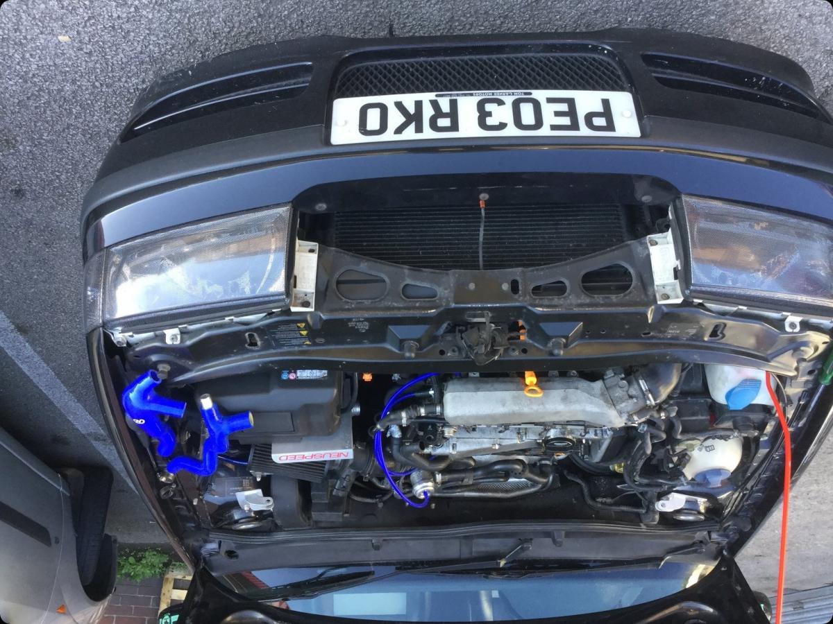

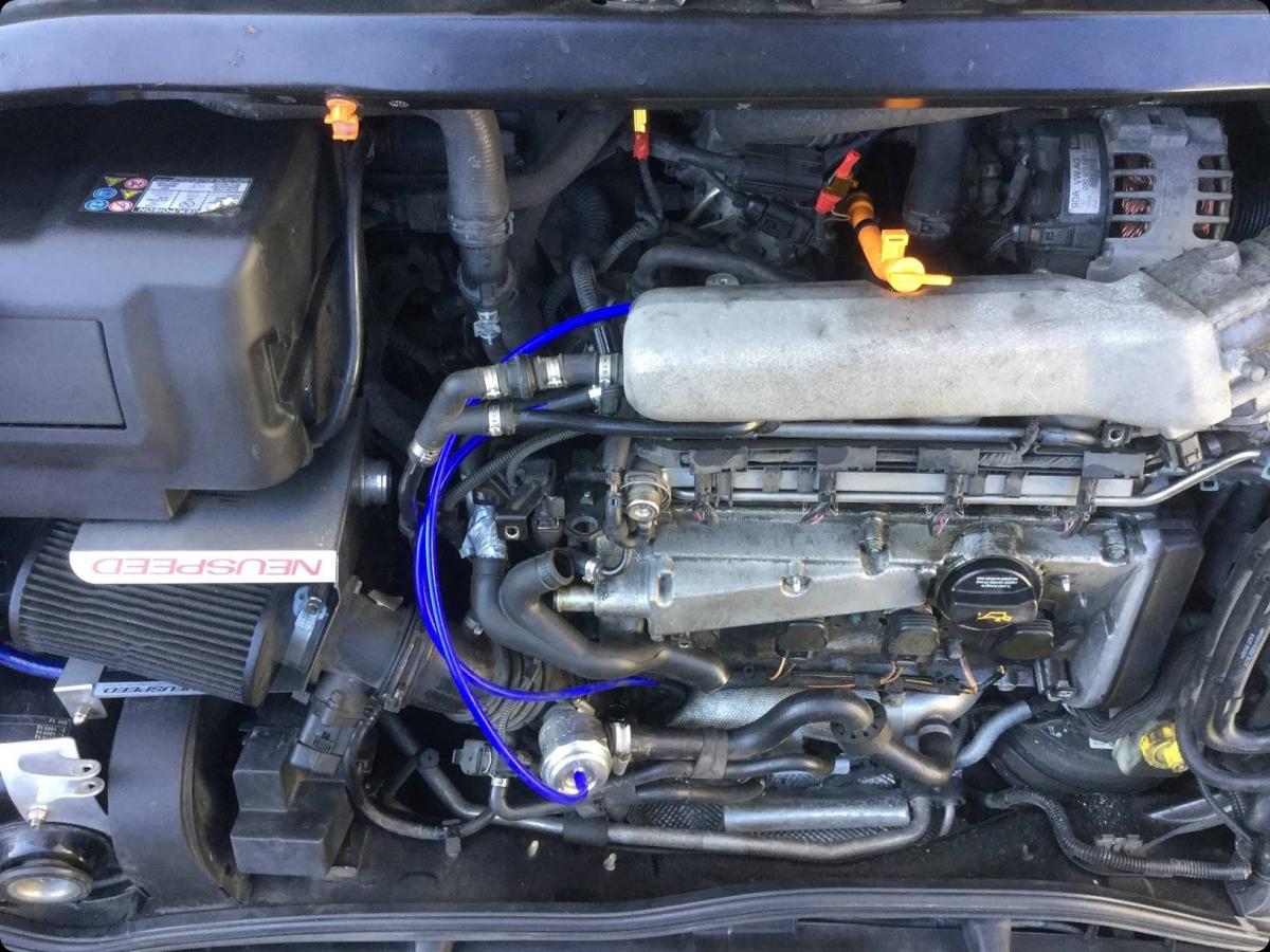

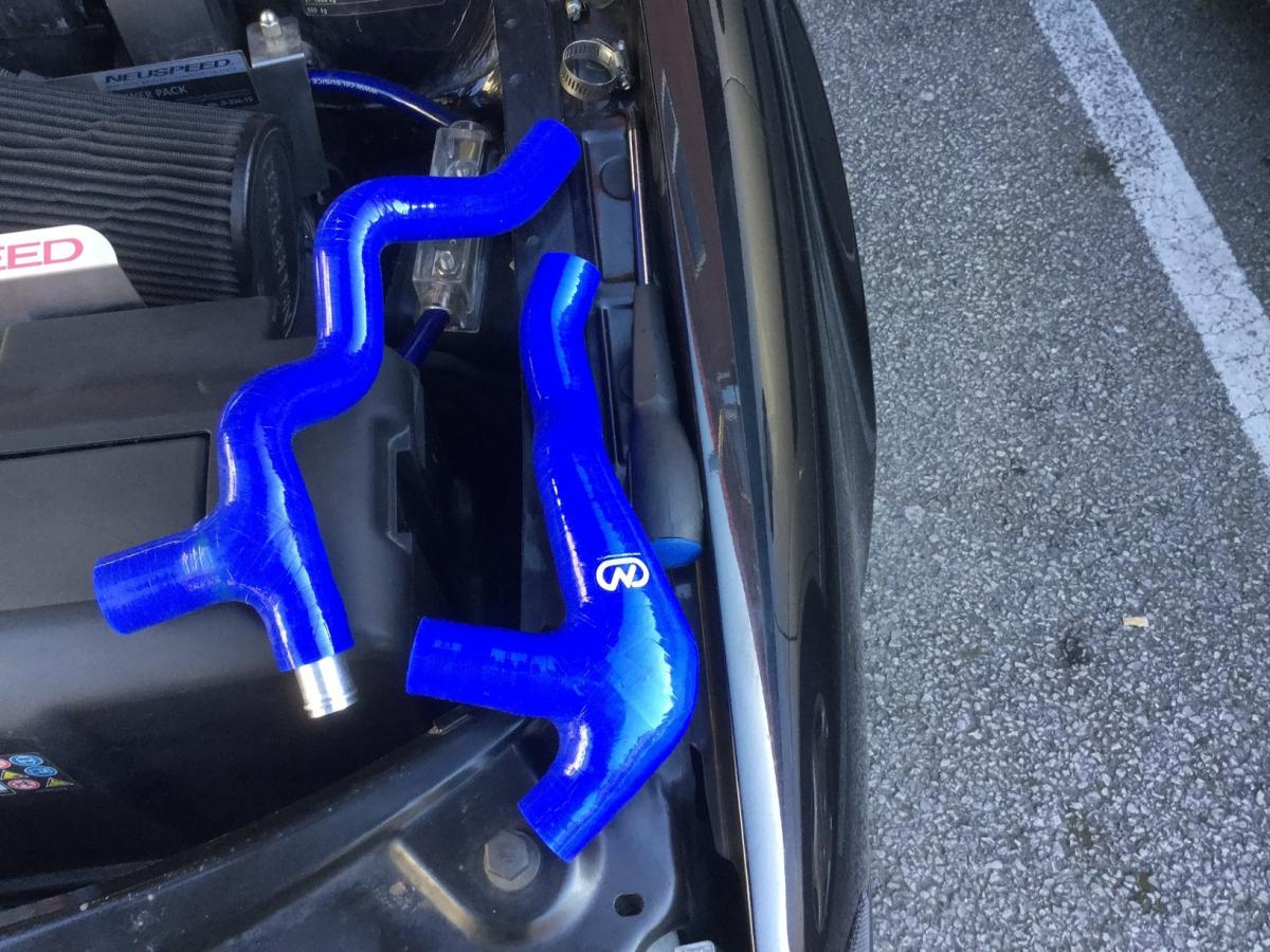

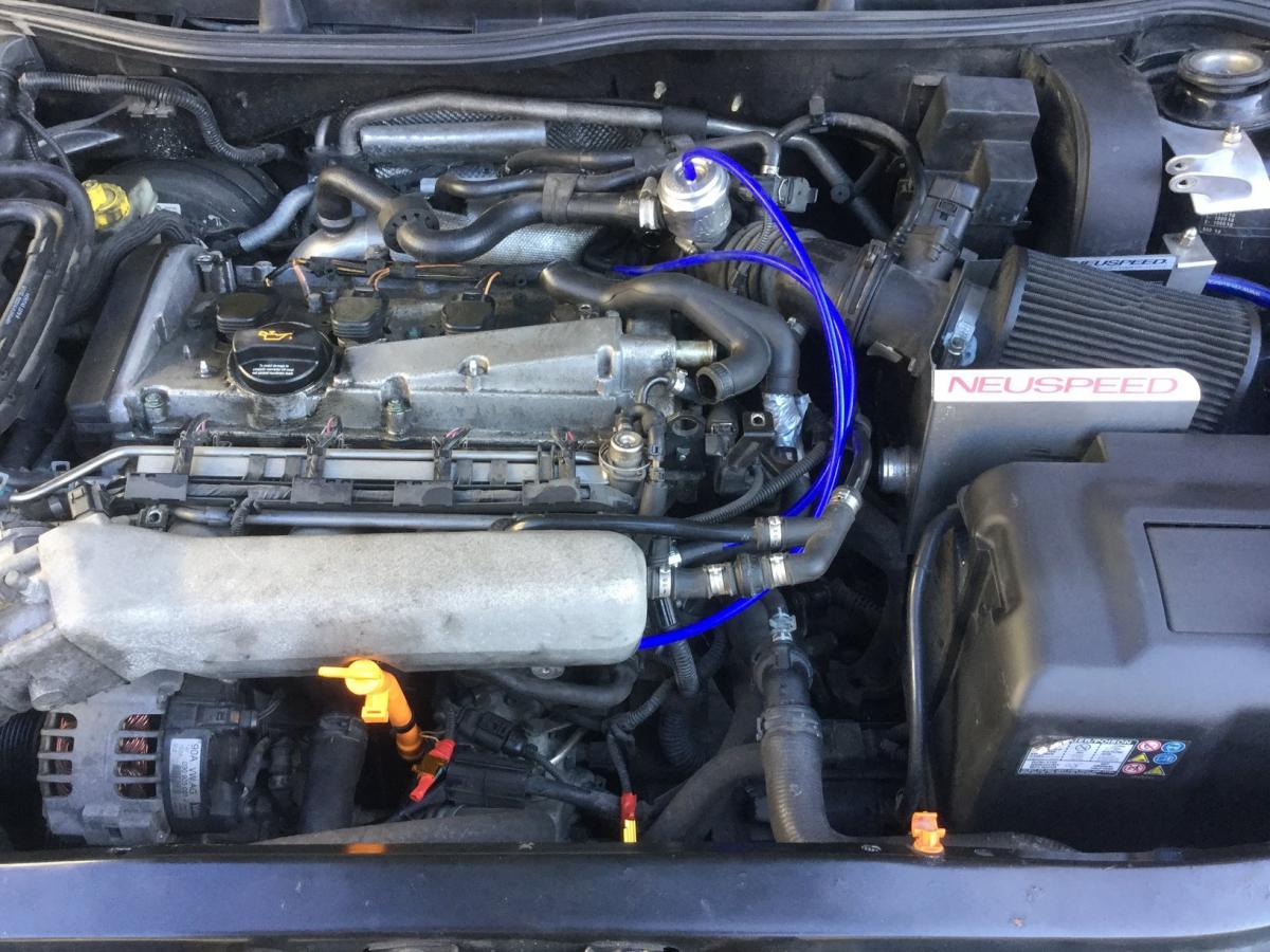

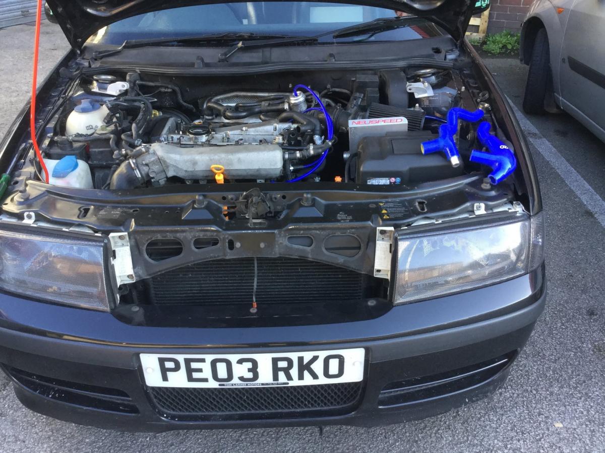

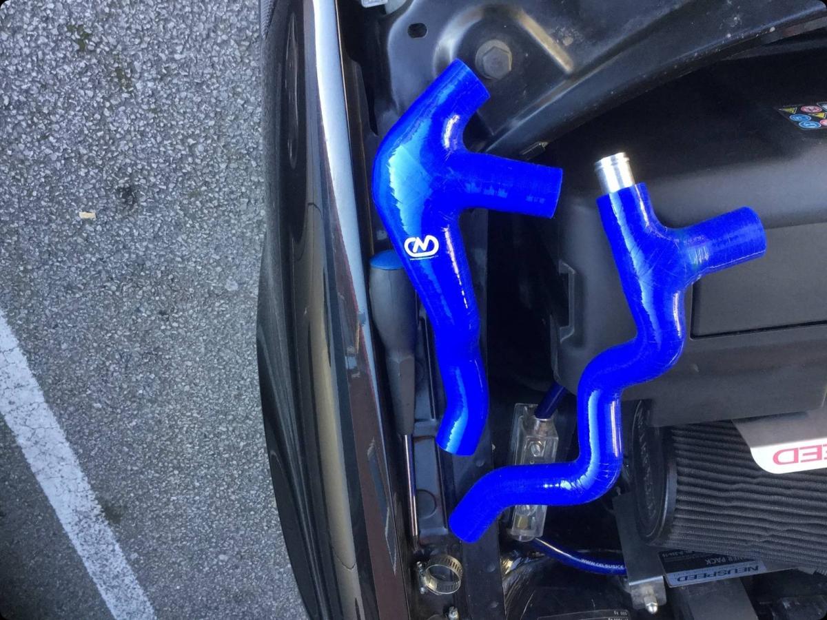

Few pics of my new breather pipes as getting things started now. Few more pics to follow as added a few more bits and about to get milltek decat fitted very soon.
