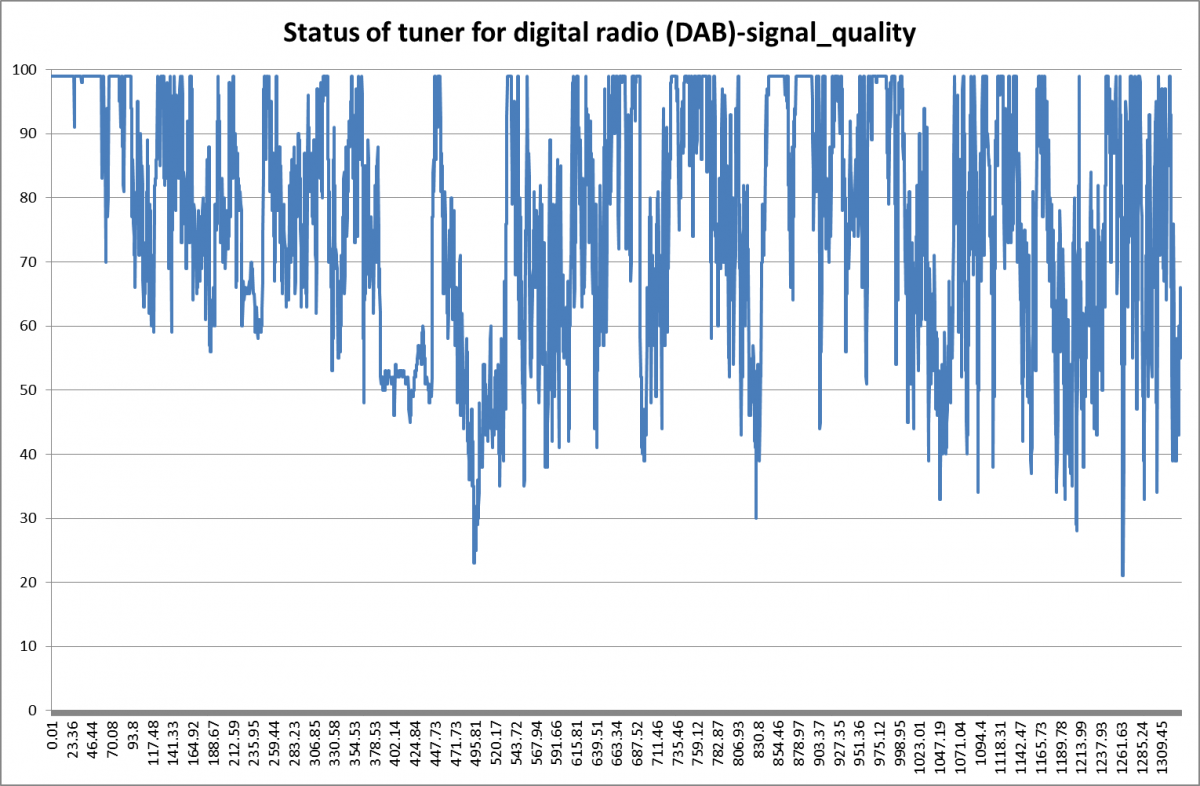

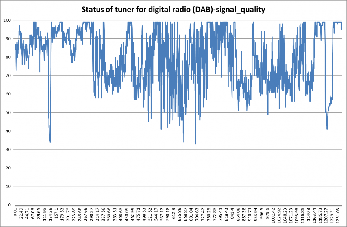

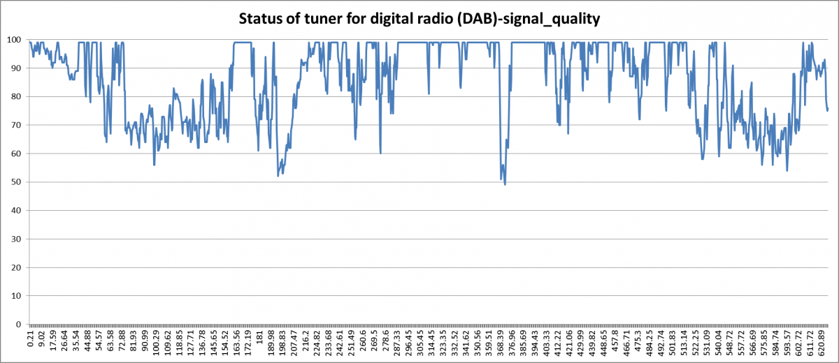

Done a bit more logging on mine, I thought I had found the problem, but apparently not as the signal is still all over the place. The only conclusion I can draw at the moment is that if the vehicle is stationary the signal quality is pretty stable at 99%. If the vehicle is moving, no matter how slowly, it jumps all over the place. Also, turning on various electrical systems in the car makes it jump about as well. This is all pointing to some kind of electrical interference causing it. The section in the middle of the graph where it is a pretty stable 99% I was parked up and turned the headlights on and off which caused the drops in signal quality.
I have removed my dashcam completely from the car including all associated wiring and reverted the LED number plate and sidelight bulbs to standard. I still have LED interior bulbs and they will be coming out next to put the car back to standard in terms of bulbs. If the graph is still as bad as this after that it will be back to the dealer again ......
Edited by andyvee

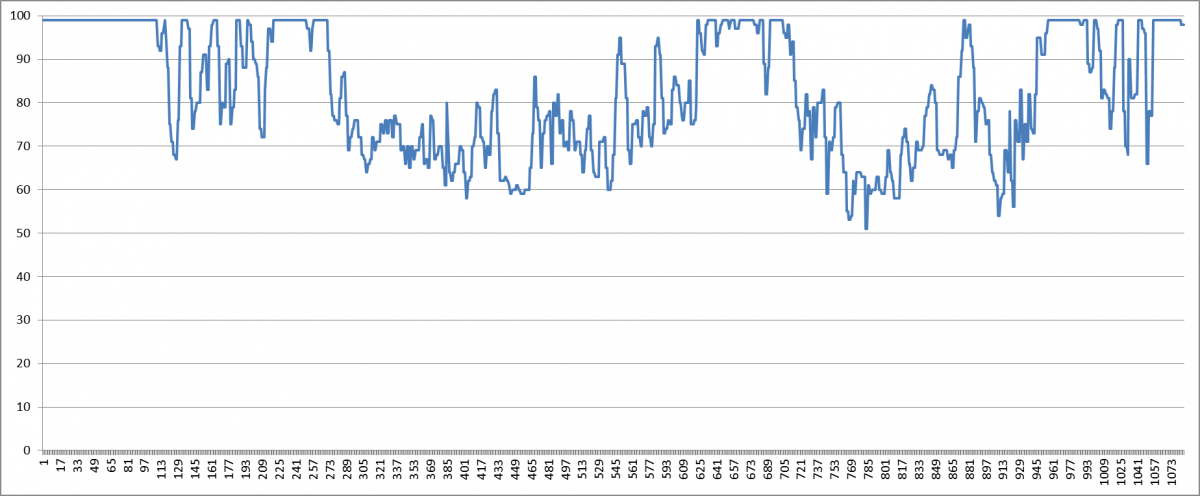

All LED bulbs removed - graph is still pants. This is on the same run as the Fabia 3 that stayed above 95% for the majority of the time. Time to book back in ..............

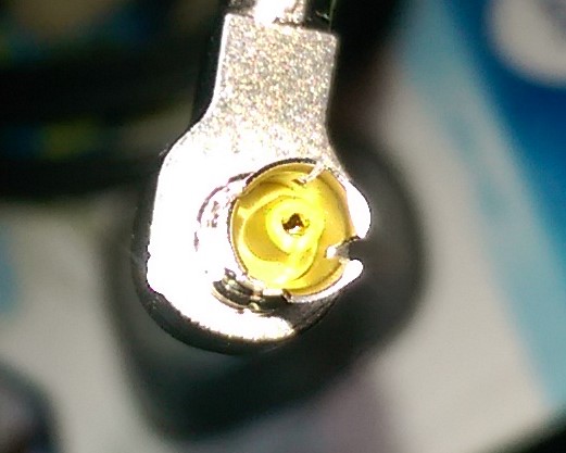

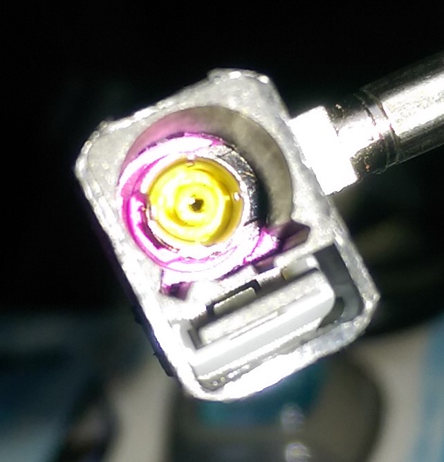

So, I needed to make up some adapter cables in order to do this, so thought I had best remove the HU to check it was a Fakra connection at the rear for the DAB, and not SMB.
It is a bit hard to tell from these photos, but at some point the dab connector on the HU end of the coax has been damaged, the outer pieces are bent (a couple of them have fractures) and the centre pin is off centre slightly, looks like it has been put under too much strain when it has been fitted and the HU slid back in to place - this might explain the fluctuating signal strength.
More worryingly, the wire that goes from the rear quarterlight (soldered to the glass) to the connector on the amp on the C-pillar was loose, it could be moved a few mm up and down where it attaches to the glass, basically a dry solder joint with the wire moving about inside!
So, it looks like I have found my problem, or problems.

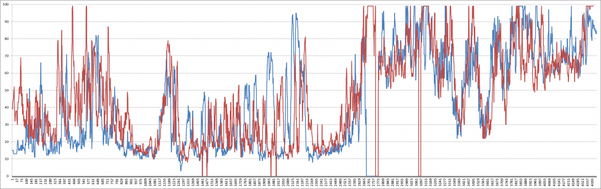

Well, it seems my assumptions about the dry joint and mangled Fakra connector were incorrect. I have resoldered the connector on the rear quarterlight so taken that out of the equation.
Here is a graph comparing the OEM setup to the cheap roof mounted antenna connected directly to the rear of the HU, so no OEM components involved (coax and amp taken out of the loop). Blue is OEM, red is the cheap aerial.
There is very little in it to be honest, the exact same route was driven back to back so taking as many variables out of the equation as possible (weather etc.)
And here is the start of the same route with the roof mounted antenna running through the OEM amp and coax - a vast improvement!
So as suspected, the issue is the antenna in the rear quarterlight (or the HU itself!)
