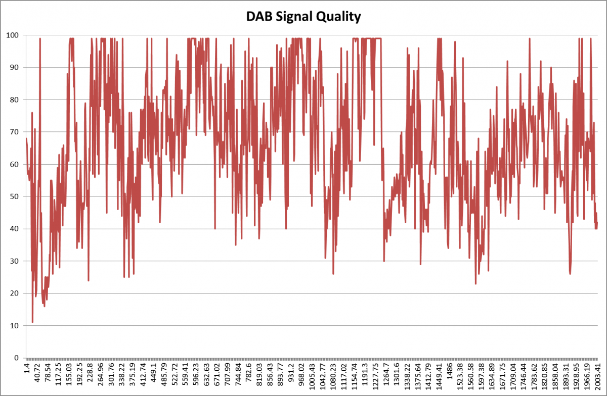

Done some logging this morning - starting from home (Rawtenstall), down the M66 on to the M62 Eastbound, off at Milnrow, and up Kingsway to RRG Rochdale. x axis is time in seconds, y axis is % signal quality. To say it is all over the place is an understatment, and there are plenty of BBC Multiplex DAB transmitters in the area to give coverage.
As can be seen at the beginning, the signal quality was between 60 and 70%

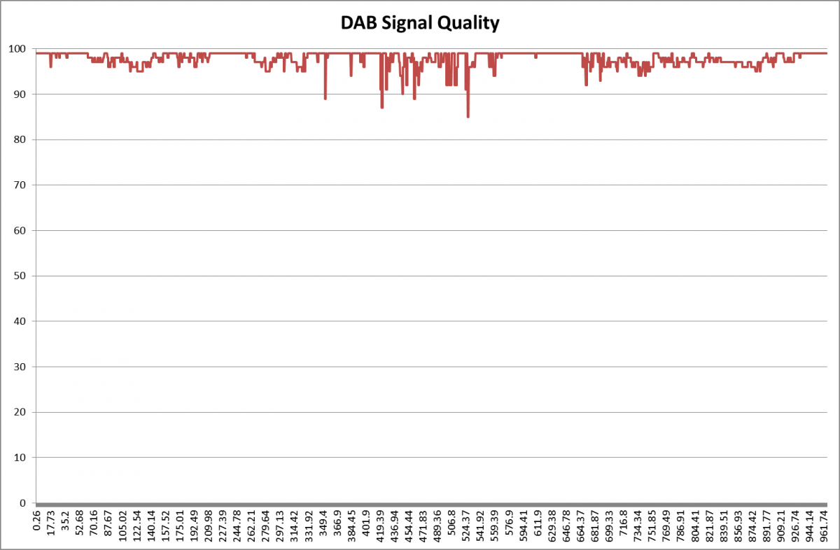

A few hours later, I looked at the signal strength for the same BBC DAB station with a O3 hatch with MIB1 Amundsen - it was 98% with the car in the same location (outside my house).
So it looks like the estate is 30% down on signal quality compared to the hatch - pretty much as I expected.

I'm going to do some logging with the Fabia 3 loaner to see if the same level of signal fluctuation is there.
Edit - Fabia 3 graph - same station, same starting point, for fairly obvious reasons stopped logging after a few miles. The only time it dropped below 90% was when I went under a bridge.
So all I need is a corresponding plot from a O3 MIB1 Columbus Hatchback to prove the point.

I really need to do a run from my house on the same route to eliminate environmental factors as much as possible, but if you can get a plot and it is as bad as mine then we know it isn't just my car, and is a design fault.
Edited by andyvee

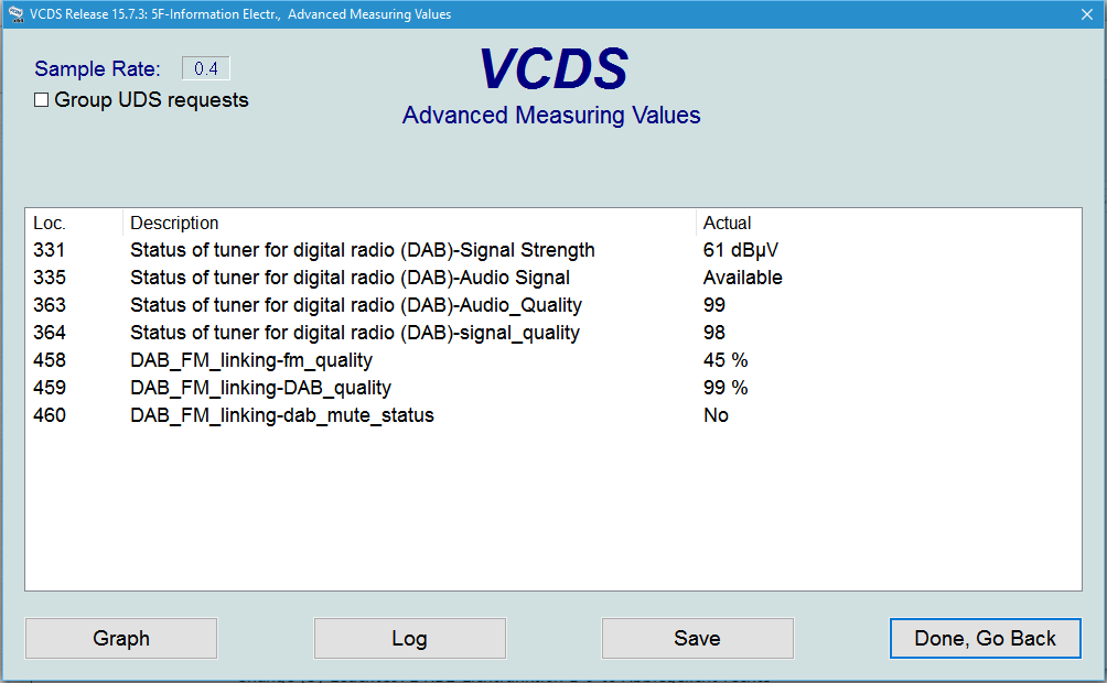

All that needs logging is channel 473 on 5F Columbus as per the below, ignore all the other ones, once I saw how random the plot is it doesn't matter about GPS position etc.
My original intention was to map out the dead spots, but the signal is all over the place, jumping up and down by as much as 30% for no apparent reason.
It is a different channel on the Amundsen, 364

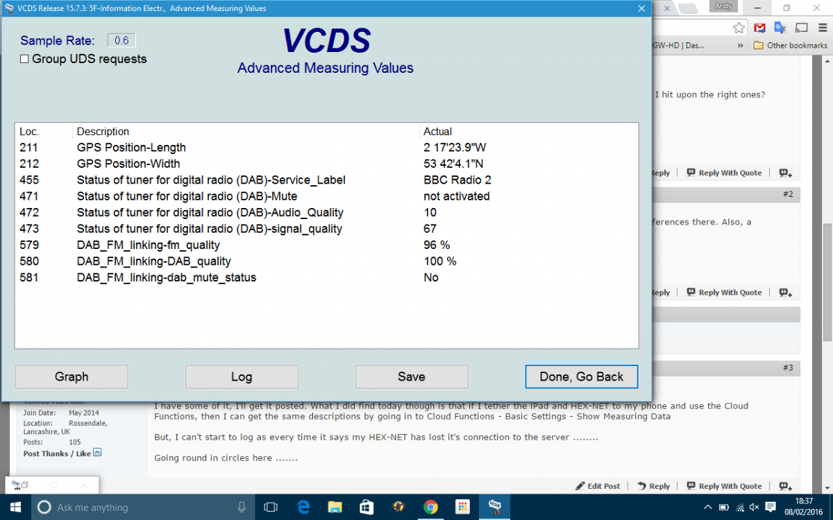

If you have access to VCDS, log some live data on signal quality.
Investigations are continuing ......... should know more by the end of the week.
The Fabia 3 loaner I am in has not dropped Radio Five Live once since I got it, including in the underground car park at Asda where the O3 Estate drops out just before you go in to it.
