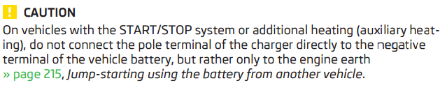

Sorry, this is incorrect advice. You should never connect a charger or jump leads directly to the battery on a car with the battery management ecu, such as the O3.
There is an earth point on the bulkhead for charging and jump starting purposes. The battery management circuitry is easily damaged, you will end up with all kinds of errors, mainly related to SS if you damage the ECU.

Which is exactly what I'm talking about. I was referring specifically to ctek chargers which I've used on cars and bikes for years now with no issues. The manafacturer does specify somewhere that their charge circuitry and monitoring facility makes them safe to use on modern cars.
Sorry, but your opening line said to not worry about damaging the ECU when the OP had stated that he had charged at 8A!
The handbook is quite clear and there are warning notices under the bonnet.
I doubt if you would get it replaced under warranty if you fry it as a fault code will be logged indicating that the battery had been charged directly.

All I am doing is referring to the manufacturers Caution statement on P199 of the manual, not trying to start an argument.
The OP and anyone else who reads this can make their own choice based on the advice given by the manufacturer, or the advice you have given.
I wouldn't want anyone else to go through the same pain as I did of getting the CAN Gateway and Battery Monitoring module replaced after experiencing multiple SS errors and other spurious electrical gremlins caused by a short in a wiring harness for the dashboard illumination. The BCM and Columbus ended up getting replaced as well. The car spent over 30 days in the workshop in a year.

If that is the case, why do Skoda say it is OK to charge the battery directly on non-SS cars, but on SS cars to use the point on the bulkhead? What difference to ease of access or safety is there between a car with SS and a car without?
As I said before, anyone reading this thread can make their own mind up, I am only pointing out the Caution statement in the handbook.

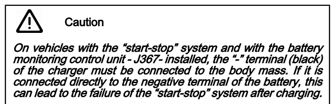

I am a member of the Audi owners club and we have actually had a number of members fry their battery management ECU by jump starting and/or charging with a rapid charger directly on the battery. The BCM is not cheap, and yes it does record faults including over current and over voltage in addition to the various stages of system shutdowns as the battery runs flat.
Interestingly I've just browsed the O3 owners manual online and on page 204 of the 2013 edition under charing it specifically states that you can trickle charge directly off the battery just like my A8, but in order to perform a rapid charge you must fully disconnect both the positive and negative terminals and charge directly off the battery. So does the O3 have the extra battery post my A8 does?

Yes, it has a point on the bulkhead for the earth if you have SS. There should be a caution notice at the end of that section, there was on my first O3 which was one of the first registered in the UK for the launch, and there is on my MY15 as well. The caution notice is as I posted earlier and appears to be a blanket caution applying to all vehicles with SS and all methods of battery charging. In other markets SS is not as prevalent as it is in the UK, which I assume is why they say you can trickle charge directly, then kind of contradict this with the caution notice.

As does the Citigo with StopStart, Fabia, Superb......etc. Not just Skoda my Fiat 500 with Stop Start also had this same warning and extra earth point for the same reason.
