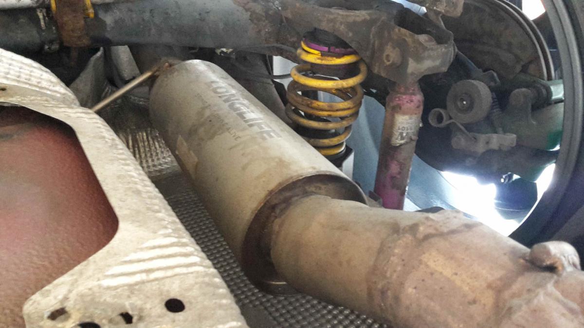

4. Currently sat in a exhaust fabrication shop having a 2.75" system made up, including a fake cat shell.

Who's doing it?
Be intresting to see if they can get it sat correctly over the rear beam so that it doesn't knock or touch anything once the car is loaded ;)
2.5 inch is a pretty tight fit over the beam.
Going to be 2.75 from turbo back? B)
Thanks Kev. Yes 2.75 all way back, it was JP Exhausts in Macclesfield, they are a really old school fabrication place they make the exhausts for all Radicals too. The brackets and flanges are stainless too which i liked. Paid £450 for it. It was fairly close to the beam so they put a flat in the pipe there so theres plenty of clearance now. Sounds really good not very loud, which again is great for me with the mileage i do and the fact i'm not 21 anymore!

What tailpipe you gone for,and what size back box?

Yes this shell is a two piece thing so didnt need the downpipe off luckily. Went for a oem looking rectangle tip its spot on. Back box is fairly big i will get some pics tomorrow. Also got a pic of my oil return or you also.

Think my back box is about 4 inch diameter.
Still quiet enough normal driving :)
