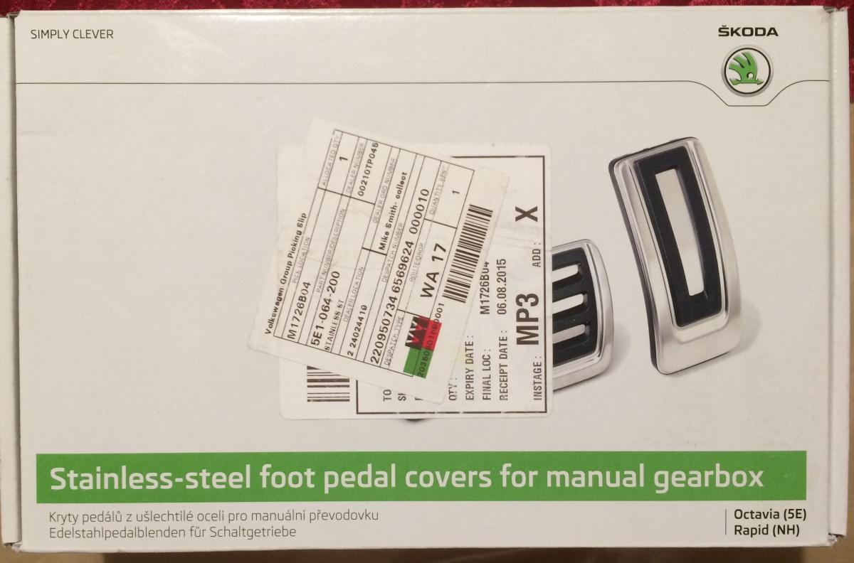

Skoda Accessory Catalogues and eshop in CZ list part number: 5E1 064 200
Super Skoda Site lists part number: 3V2 064 200

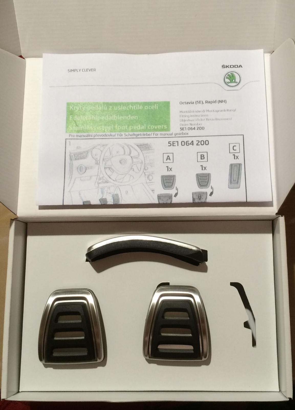

Pedals bought from TPS came in Skoda branded box, with fitting instructions

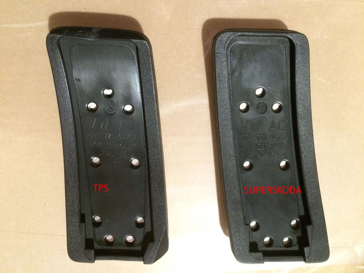

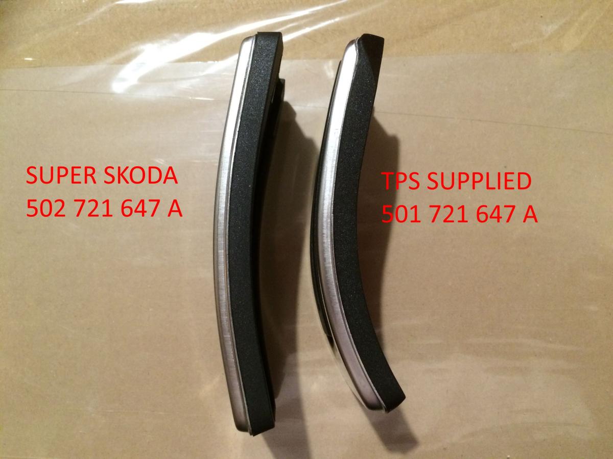

The Clutch and Brake pedals appear identical in size / shape and have the same individual part numbers stamped on them, although the ones in the box look very slightly more refined in terms of the rear plastic. On the SuperSkoda pedals the tiny circular marks where the plastic moulding was attached to something else are slightly more roughly finished but without comparing multiple sets this could just be a variation.

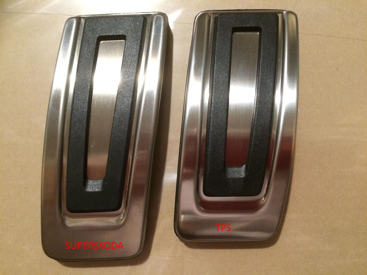

The accelerator pedals have different part numbers, subtly different appearance at the rear, are a different size and a slightly different profile.
The part number stamped on the accelerator pedals from Super Skoda is still 5E2 721 647 A yet are supposed to be "3V2 064 200"
The part number stamped on the brake and clutch pedals from Super Skoda is 5E1 064 200 (same as the TPS set).

Skoda lists no set of pedals with the same part number as SuperSkoda. Neither could TPS locate this RHD specific part number. In fact in the UK where only RHD pedals would be needed, there were 10s of the 5E1 064 200 set in stock, which strongly suggests they are appropriate for RHD cars.

If that's correct, the clutch and brake pedals appear 95%-98% similar, but the accelerator pedal is significantly different. In use they might be fine.

Could you please share the manual? (phone pics would work)
I'm interested in removing originals. Pry off with some tool? Slide new ones on top? Some Glue? Screws?

The black part is a very firm and solid rubber. Instructions attached - sorry for the delay!

Looking at the Superskoda site the 3V part numbers are their own internal stock catalogue numbers and not the Skoda part numbers. Looking at the larger image of the RHD manual seems to give the OEM part number which for RHD manual is 5E2064200 and RHD DSG 5E1064205

Ultimately IF they are of the same quality AND IF they fit correctly then does it really matter?
Personally I prefer the SS throttle pedal as it is less curved, but will this make it possible to be fitted? I can’t remember what the pedal is like in the car?

As I said its only a possible problem and the parts are extremely similar. If the SS parts had been in a box, had come with the instruction leaflet (why not at least ship that?) and had the same shaped acc pedal I'd never have thought twice.

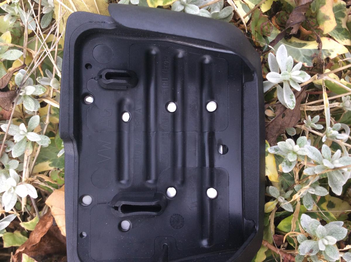

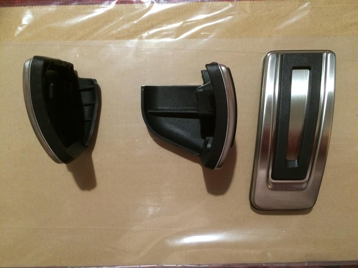

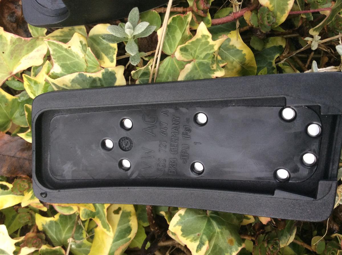

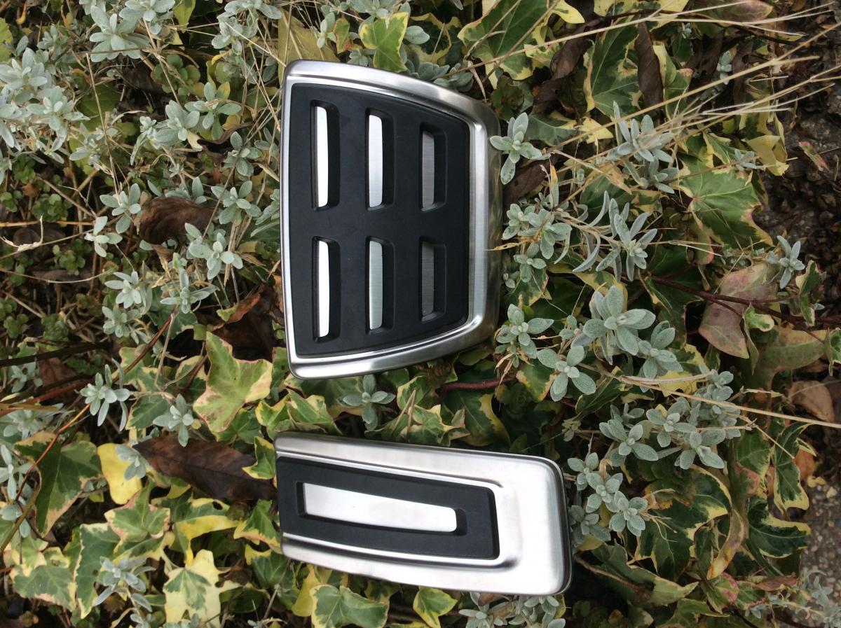

Well I had a quick look this after. Brake looks pretty straight forward but in the 5 minutes I tried no way could I get the throttle pedal on. I gave up :-D
Here's the pics make of them as you will !

Was it not curved enough then? meaning that the other one that has been pictured is probably the right one?
No it looks like the right one. It's just getting the correct technique to get it to fit I think.
I'll not get another chance to fit for a week. I'll fire a mail off to Skodadop in the meantime.

Nick,
Try leaving them in bucket of hot water for 5 to 10 minutes. Softens the rubber so easier to work with. Once the rubber cools it hardens again.
Thanks rufu I'll give that a go :-)
