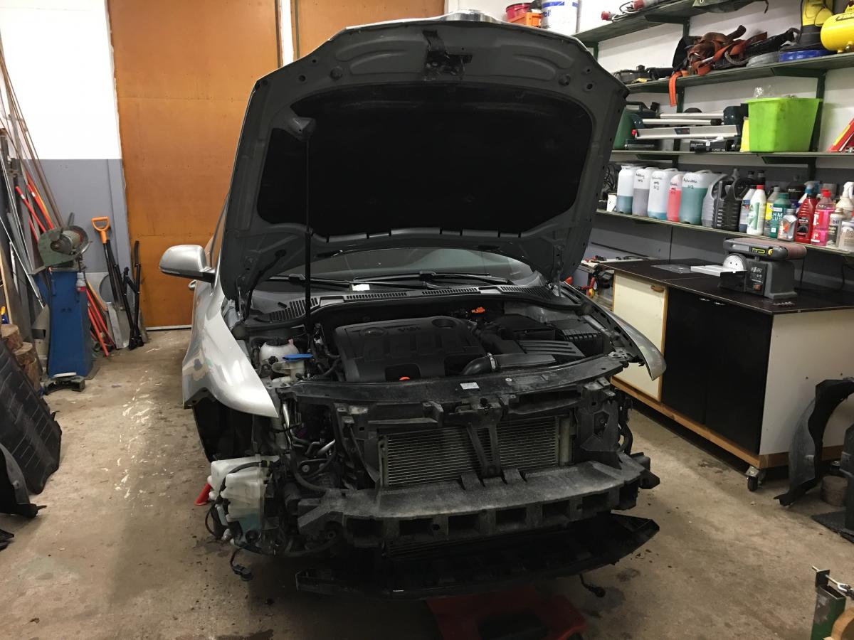

Something happened yesterday...  :p
You hit a moose!?
Seriously, hopefully that front bumper is off so that you can respray it, that patch of missing paint really stood out  :D

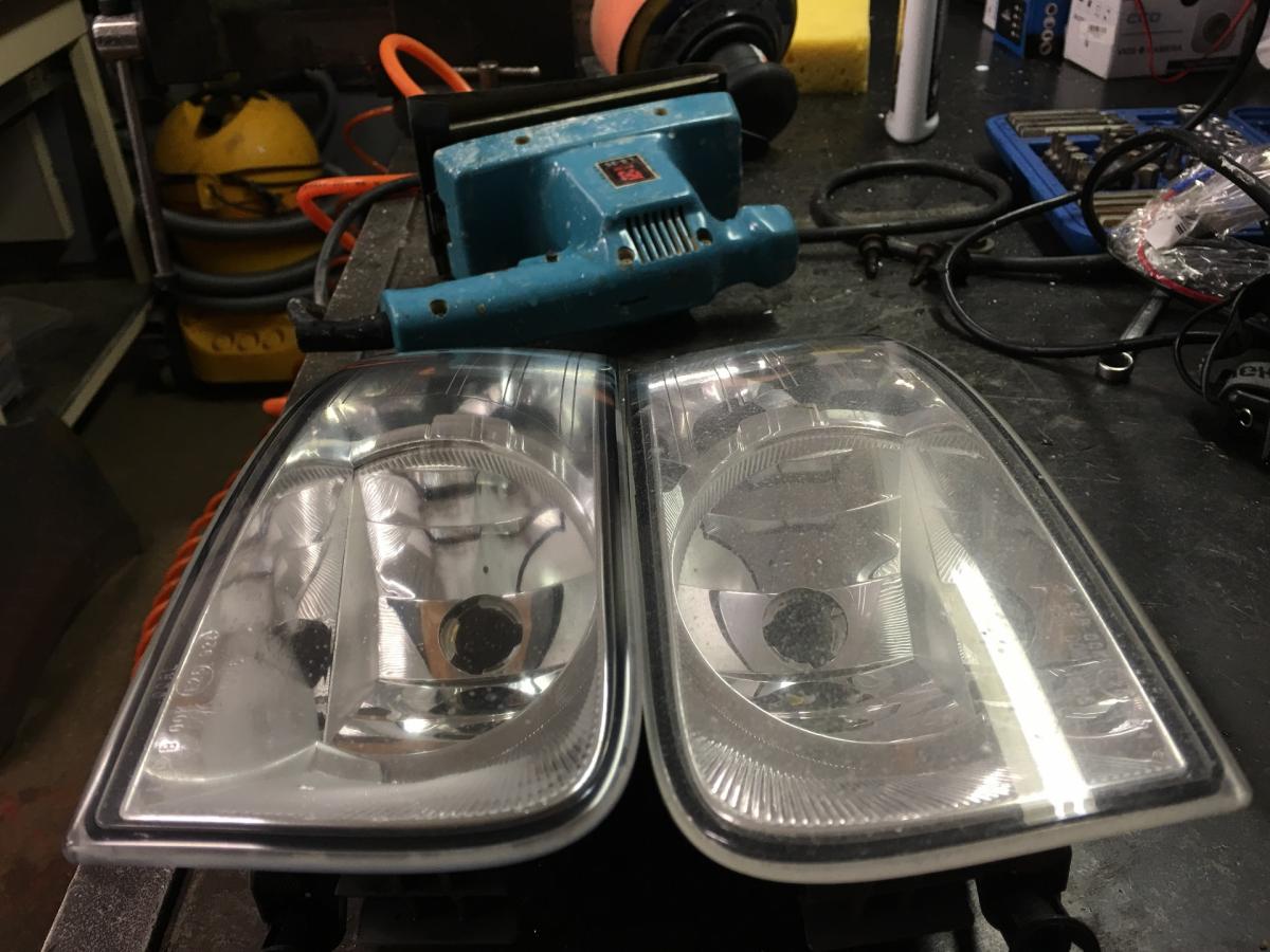

No. nothing like that. I just got tired of the lights looking like crap being chipped by stones.
I have now started sanding and polishing them, have done one of the fogs and the results are very nice!

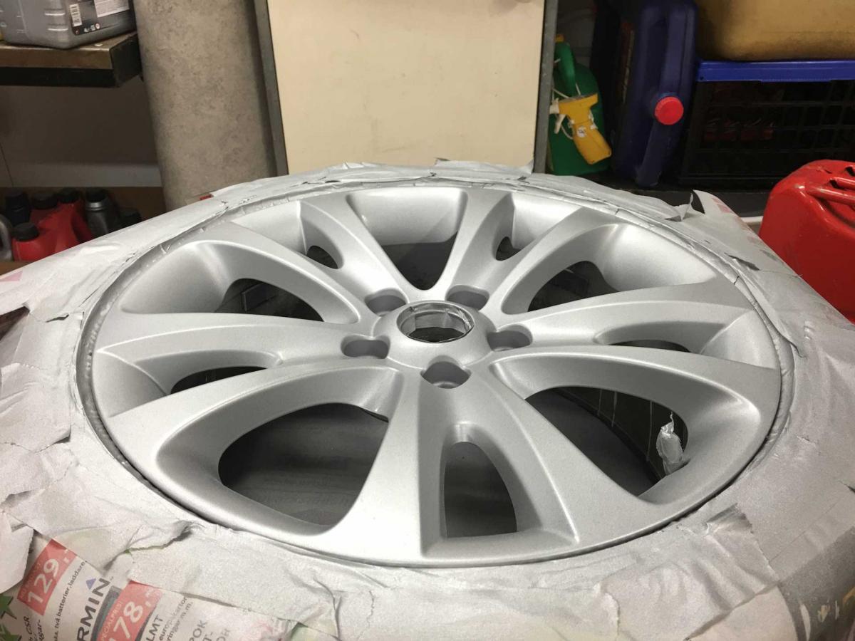

Two of my rims were a bit scuffed, one in particular. So I tried to refurbish them myself! Bought some good filler, tried to find some matching spray paint and some clear coat, took out my sanding papers and started sanding...
Here is what the wheel looked like after sanding and filling was done. Now it was time to paint.
After 4 or 5 coats of paint, this is what the wheel looked like.

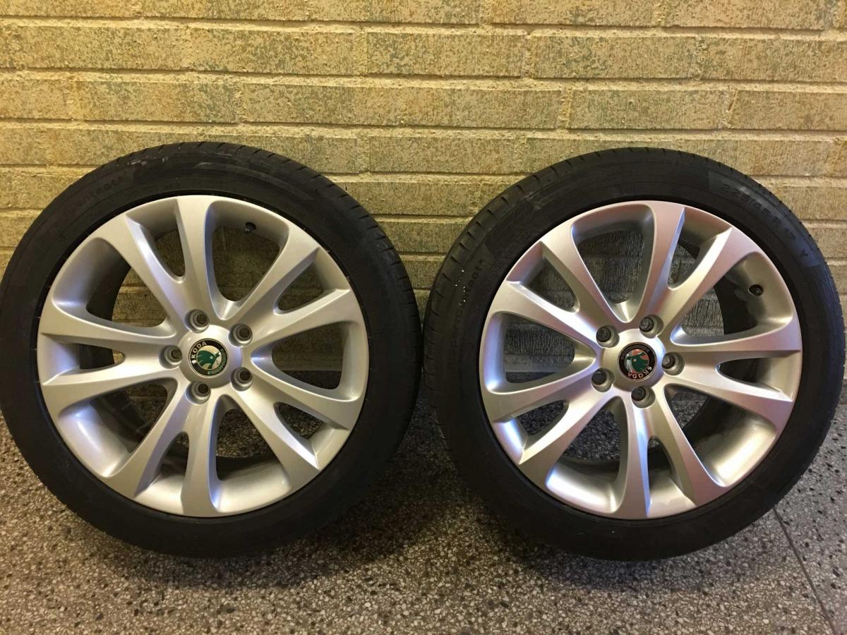

And here is the result. One of these wheels is the one I fixed, and the other is stock. Can you tell which is which? There is a bit of a difference in the paint job up close, mostly because the surface got all "prickly" after the last coat of paint. Didn't have time to wet sand it before I put on the clear coat, so I could probably have done a better job if I'd have had more time...
Still, I'm quite happy with the result. It looks a lot better than before, and didn't cost me more than about 20£ or so. Will have to see how the paint job fares over time, maybe I'll have to respray them sometime but, that'll be a later problem.

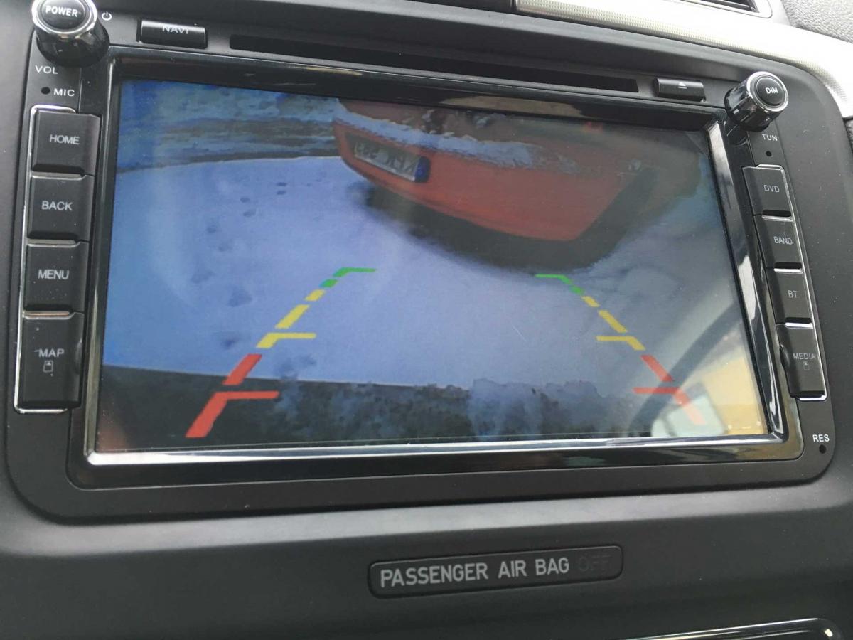

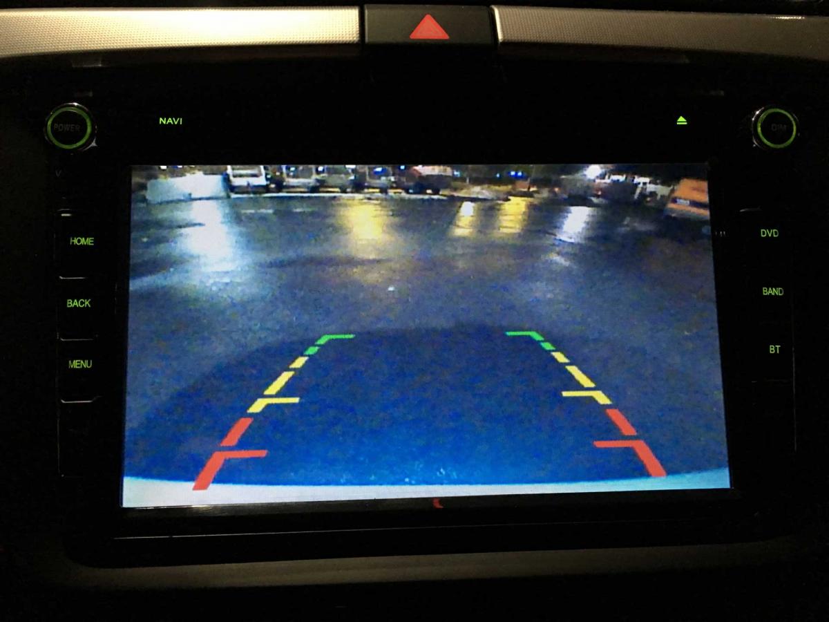

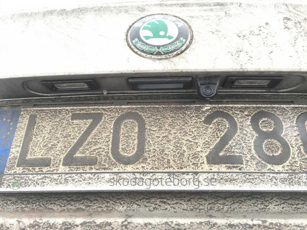

At the same time as I was doing the wheels, I also finally installed my rear view camera. Trying to route the cable discreetly was the biggest problem, other than that it went like a breeze! Here is the camera:
And here is what I see:

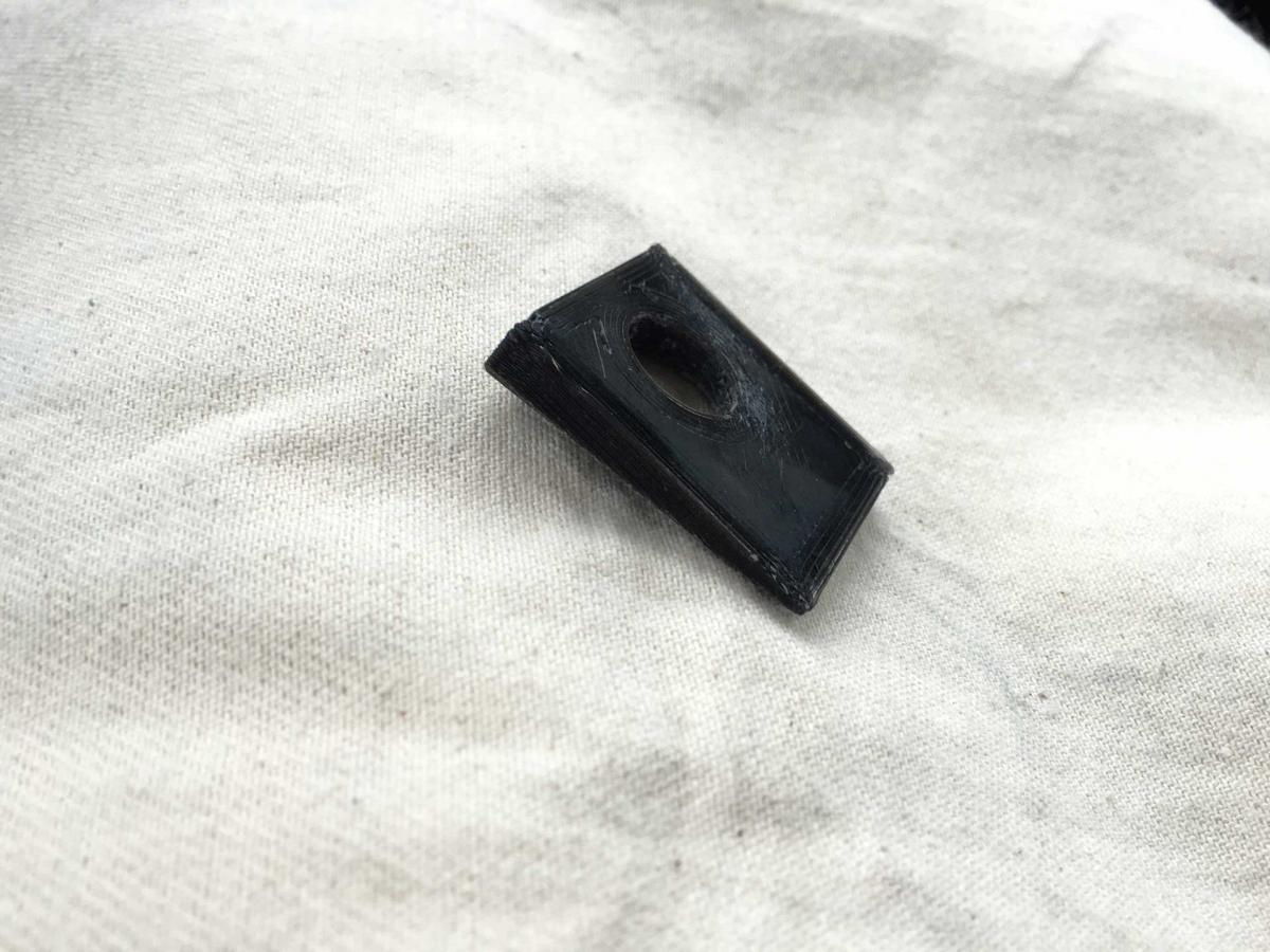

Unfortunately, the camera is angled a bit too far down for my taste. I don't need to see my entire rear bumper! Luckily though, I have a friend with a 3D-printer, so I modeled up two different "spacers" in solidworks and had him print them for me. Haven't had the time to try them out yet, will report back when they are in place!

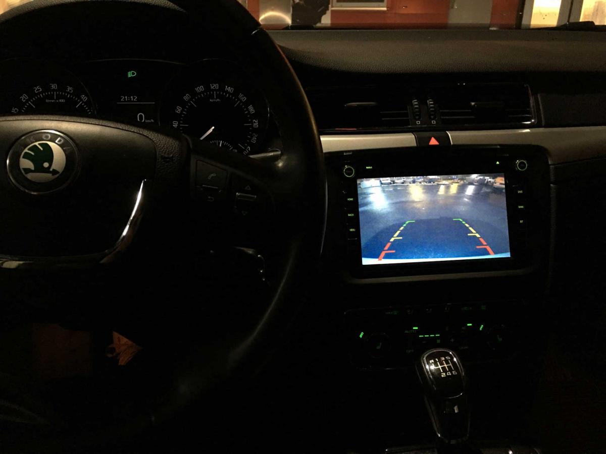

Overall, I'm very happy with the results. Even in the dark I get a good picture (will post one later), the only thing I would like is more wide-angle to see more to the sides! But hey, for the price of 13£, I won't complain! :)

Gave the car a thorough wash tonight, and at the same time I decided to fit the plastic "shim" my buddy had 3D-printed for me and my rear view camera. Now, the camera sits at an almost perfect angle! I would like to see even a little less of the bumper, but it's nearly spot on. I think I'll be happy with this. :)
If you were to draw a rectangle around the car, touching the edges of the sides and the front and back bumper, the corners of the rectangle are pretty much exactly where the lower corners of what my camera sees. So even though I initially thought it wasn't such a wide angle, it indeed is! It really shows you what is behind your car.
