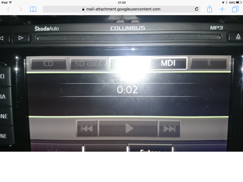

In the picture you can see that in the media section, it's giving me the option of bluetooth, but it won't allow me to select it.
Hmm. Generally that means the device (like KDI, AUX, or whatever) is coded and connected, but not available. No idea why it would do that with Bluetooth as it's a seperate module, unless the coding for the unit has been reset and Bluetooth is no longer coded?

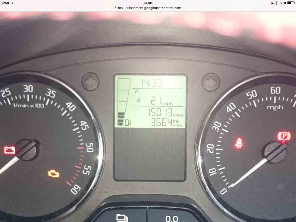

Easiest thing.....turn the car on (doesn't need engine running) and post a pic of the instrument cluster.

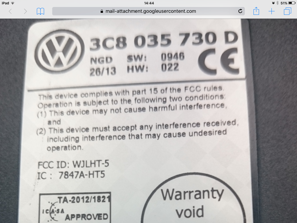

Also be handy to know what phone you have and which bluetooth module you fitted.
post-128056-0-15588900-1446821228_thumb.pngpost-128056-0-54258900-1446821265_thumb.png
Phone is a Sony Xperia z2
You don't have maxidot.

The pairing between phone and car is initiated through a menu on MaxiDot. MaxiDot instructs the BT module to go into pairing mode, you do the same on the phone, they see each other, a quick PIN code and everything is set in stone. Every time you start the car, the BT module looks for the phone. You can also see on MaxiDot who is calling, and scroll through the phonebook,
The BT symbol on the Columbus means that Columbus can see the BT unit. It goes solid when the BT unit is paired.
