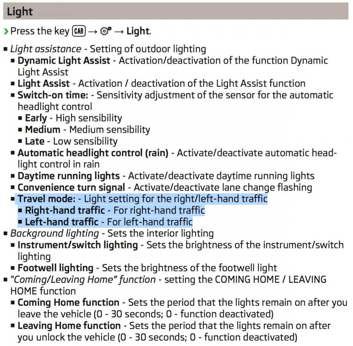

Nor do they operate (pg75 of the manual) in 'travel mode'. Realy unhelpful as all that says 'travel mode, which you can change in the infotainment'. And BTW...doesn't every car have 'travel mode'. Isn't that the point of a car :notme:
The Smart Light Assist functions as normal Light Assist in Travel Mode, so it switches between high and dipped rather than adjusting/masking the high beam.
Travel Mode in the manual is a misnomer as that's what it was called in the Superb II.
In the Superb III it's the driving on the left/right option in the infotainment Lights menu. Selecting driving on the right in a RHD car flattens the normally raised nearside portion of the beam.
It only works with Bi-Xenons and removes the need for masking when travelling abroad.
If you have factory Navigation the car should switch / adjust the lights by itself as the GPS & Nav can tell it's s in Europe.
It might be worth asking the dealer to check that they have correctly deactivated all of the delivery mode settings as they do often miss one or to. I once left the stealers in my a new motor without windscreen wipers or climate control and only noticed 15 mile away when it started to rain. It was a fun drive back in the rain, not!
20min later dealer had corrected everything and apologised. Worth asking them to check though.

The only difference between the two is the option has now moved from the maxidot, where it was an on/off setting, to the infotainment where it's a right/left setting.
Superb III and mib2 Columbus manuals...
