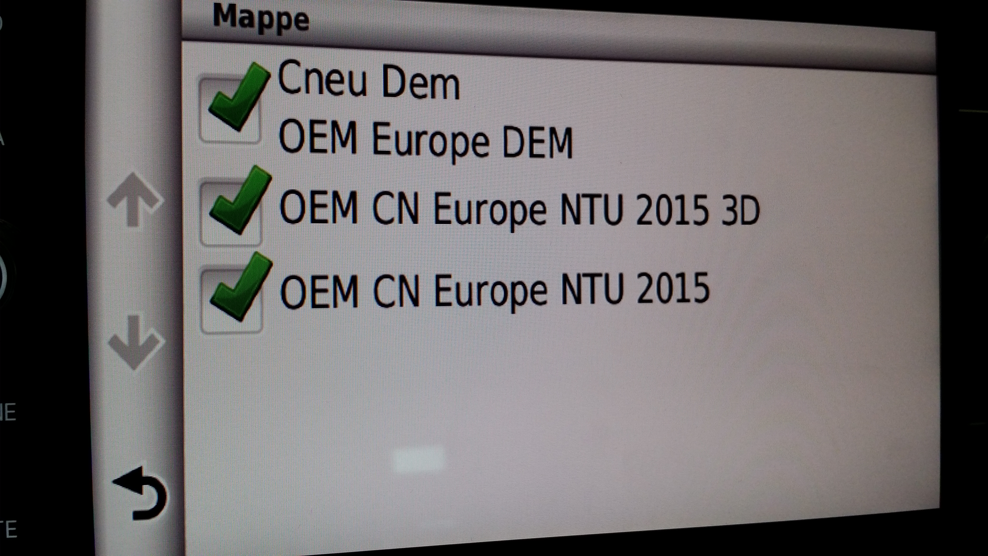

Now i have this version on maps....  very OLD

  • Mine didnt come with a card either, just an empty slot but it does have a set of maps (2015 i think) pre installed as default.   I've managed to install latest updated maps on mine using an SD card

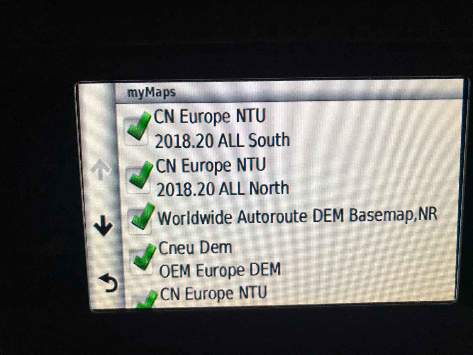

* As reported by other users, the name of the map you require is called Kenwood SD28E EU NTU 2018.20.  Google seems to like a search on this term "Kenwood KNA SD28E Map Update - CN Europe NTU 2018.20 gps"
* You can load both the extracted update, GVN60,KWEU_270, and your new map onto the SD card and your GVN60 will both update and give you access to the new maps.  This takes several minutes.

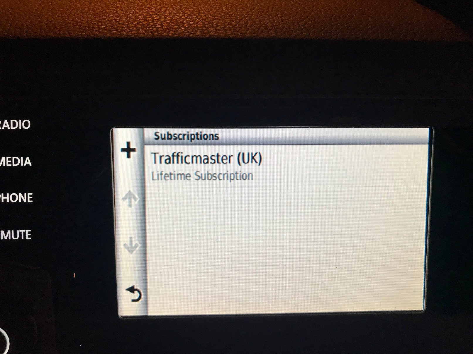

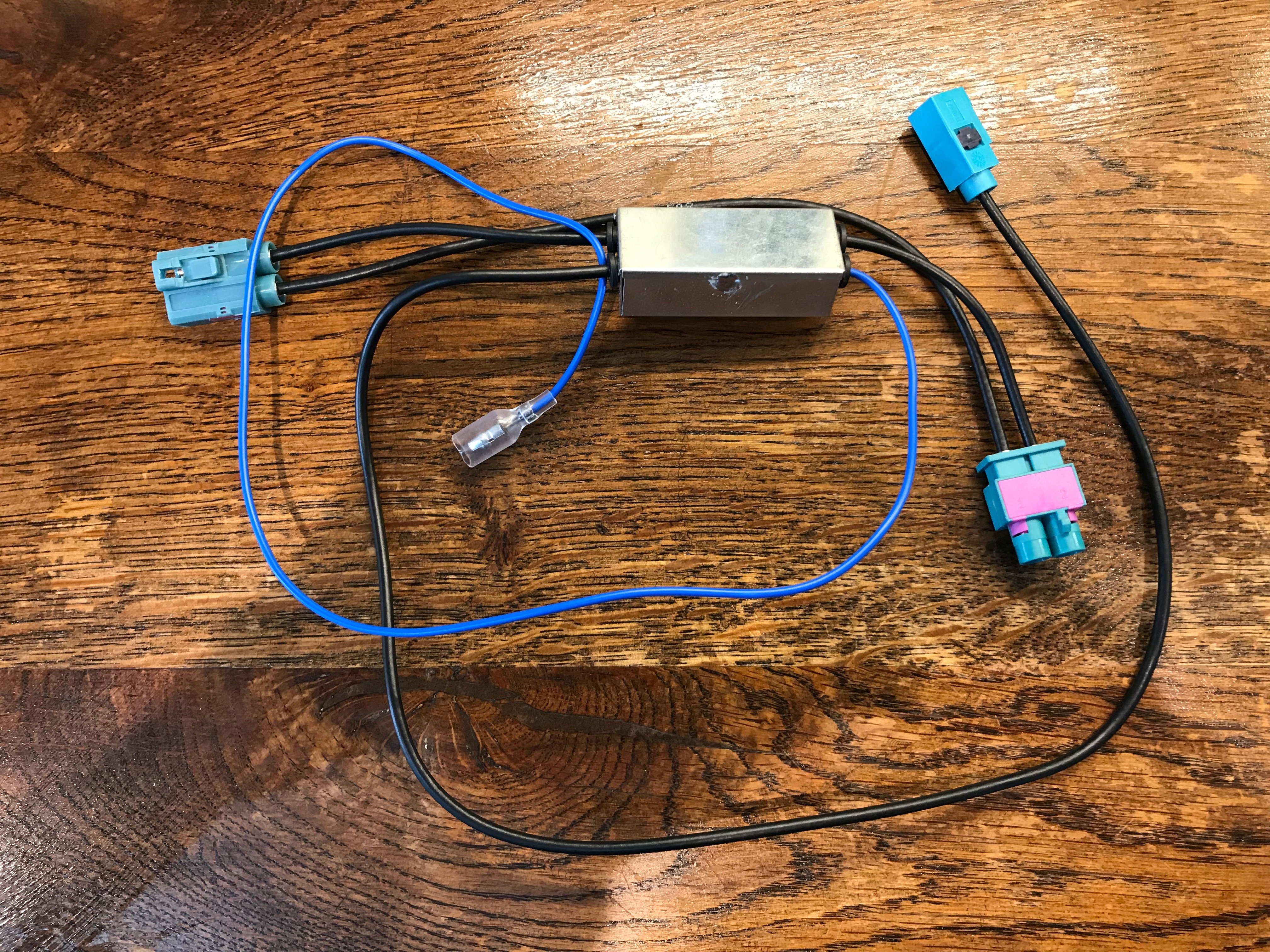

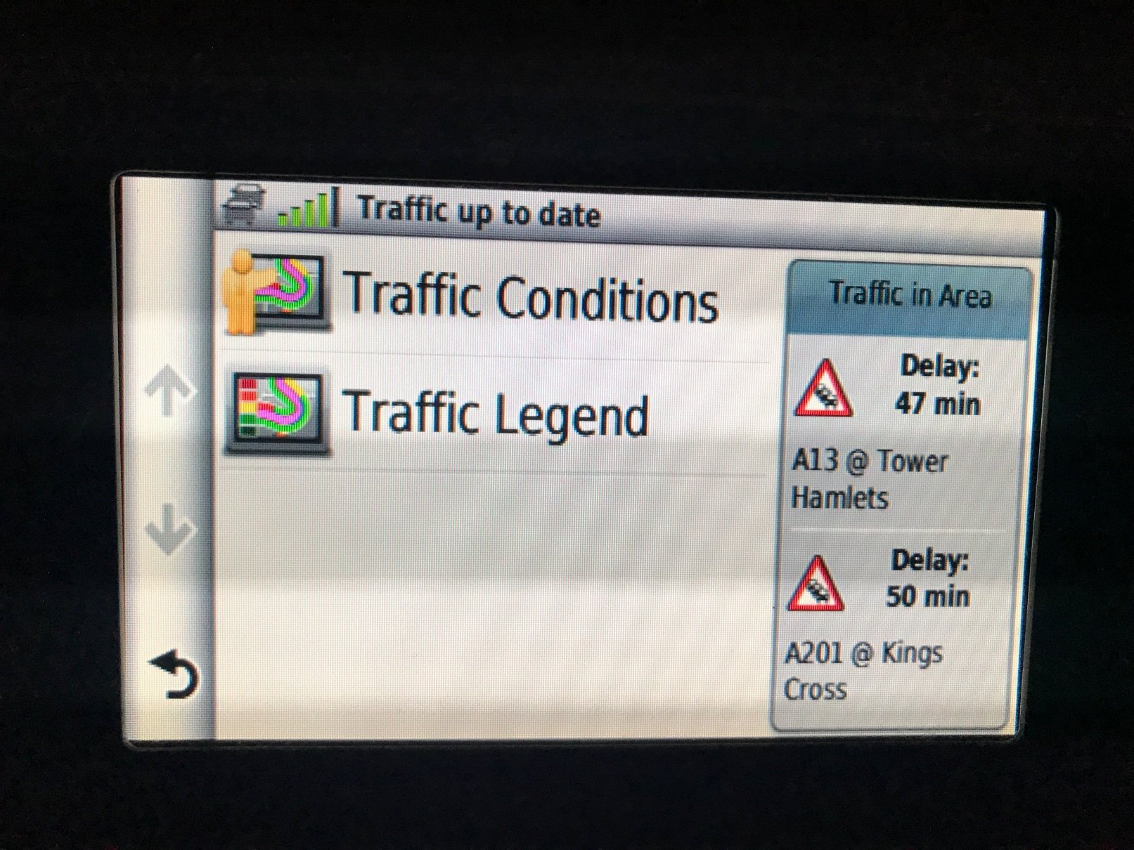

In an attempt to get the TMC traffic working I emailed Kenwood for the antenna booster and they sent me one for free (see image - note this is for a 2015 Golf Mk7) which I also fitted today.  I also opted to take a traffic subscription via the Garmin Express £45 link above, but this was a mistake and did not work.  Still no traffic subscription and no signal - will let you know if I resolve this.
Hopefully useful for somebody to know that this does all work!  The Garmin traffic subscription purchase took a few hours to process their end but it eventually appeared in my Garmin account and I could register with the ID of my GVN-60W.  As soon as the traffic subscription was in place the traffic started showing, so the antenna booster above obviously works well.

I updated the system ok via SD card, then added latest maps to SD card. Done! I then removed the SD card to see what maps were there and it reverts to system (?) loaded 2016 maps. All good with card loaded. Makes my Mio stick on the screen satnav look advanced. Garmin overdo the countdown to the next event (roundabout/junction) starting at 1.1 miles or more, the Mio states 'in 500 yards'.....
