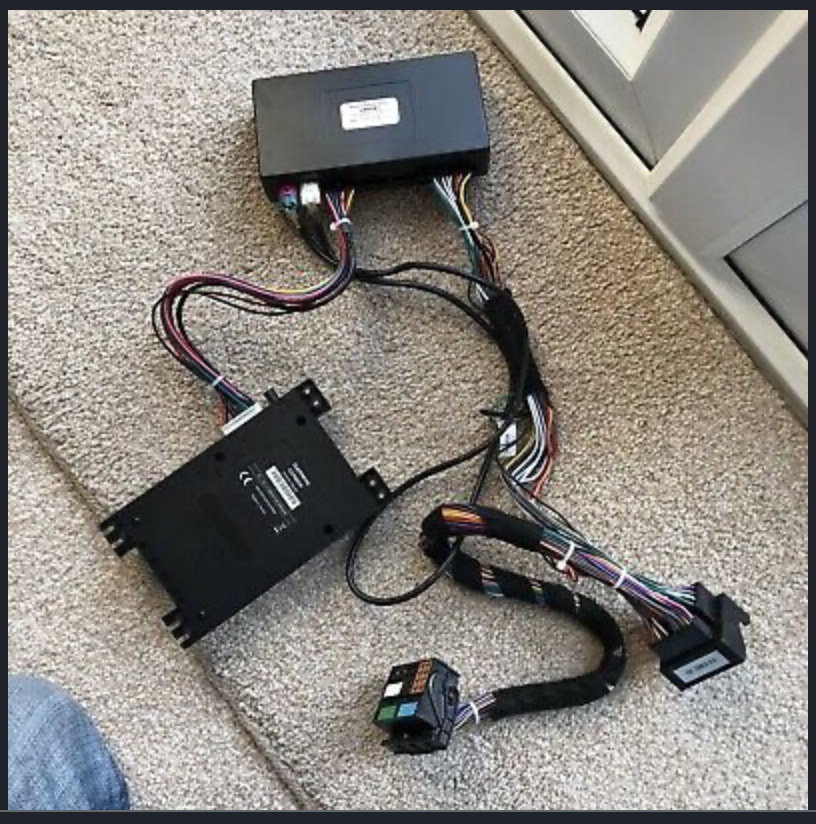

Finding the SatNav
I cannot pretend this will be comprehensive as where the SatNav itself is located depends on how your dealer / garage installed it. But I will give some tips that helped me find mine.
  1. The SatNav unit is actually two bits of hardware linked by wires - I found the below photo helpful to know what was what. The bit at the top is the video unit; the bit on the bottom left of the photo is what you need to find - it contains the all-important SD card slot.
  2. I first removed a T20 screw on the panel on the centre console in the passenger side footwell (if you sit in the passenger seat - it'll be to the right of your right shin).
  3. This allowed me to pull back (slightly) the plastic trim; some people have had the SatNav unit fall down from behind this. So the unit could be here.
  4. Mine wasn't - but I did find the video unit. I couldn't pull it out but could identify it by touch. I felt where the wires were going and worked out that the SatNav unit itself was actually behind the USB / cigarette lighter panel.
  5. You can pull this panel off (from just below the climate control buttons) - press your thumbs outwards on this panel (just to the left / right of the USB port / lighter bit) and quite firmly pull down. It's a bit stiff but I did it multiple times and didn't break it!
  6. I could just see the top of the SatNav unit poking up from further down in the centre console. I could just get my hands behind where the USB port was and feel the top of the unit; luckily the unit was the correct way around to allow me to access the SD card.
  7. To access the SD card slot, I squeezed the sides of the top of the unit I had access to and popped open the door.
  8. I then felt with my fingers and (hallelujah) could feel the SD card slot.

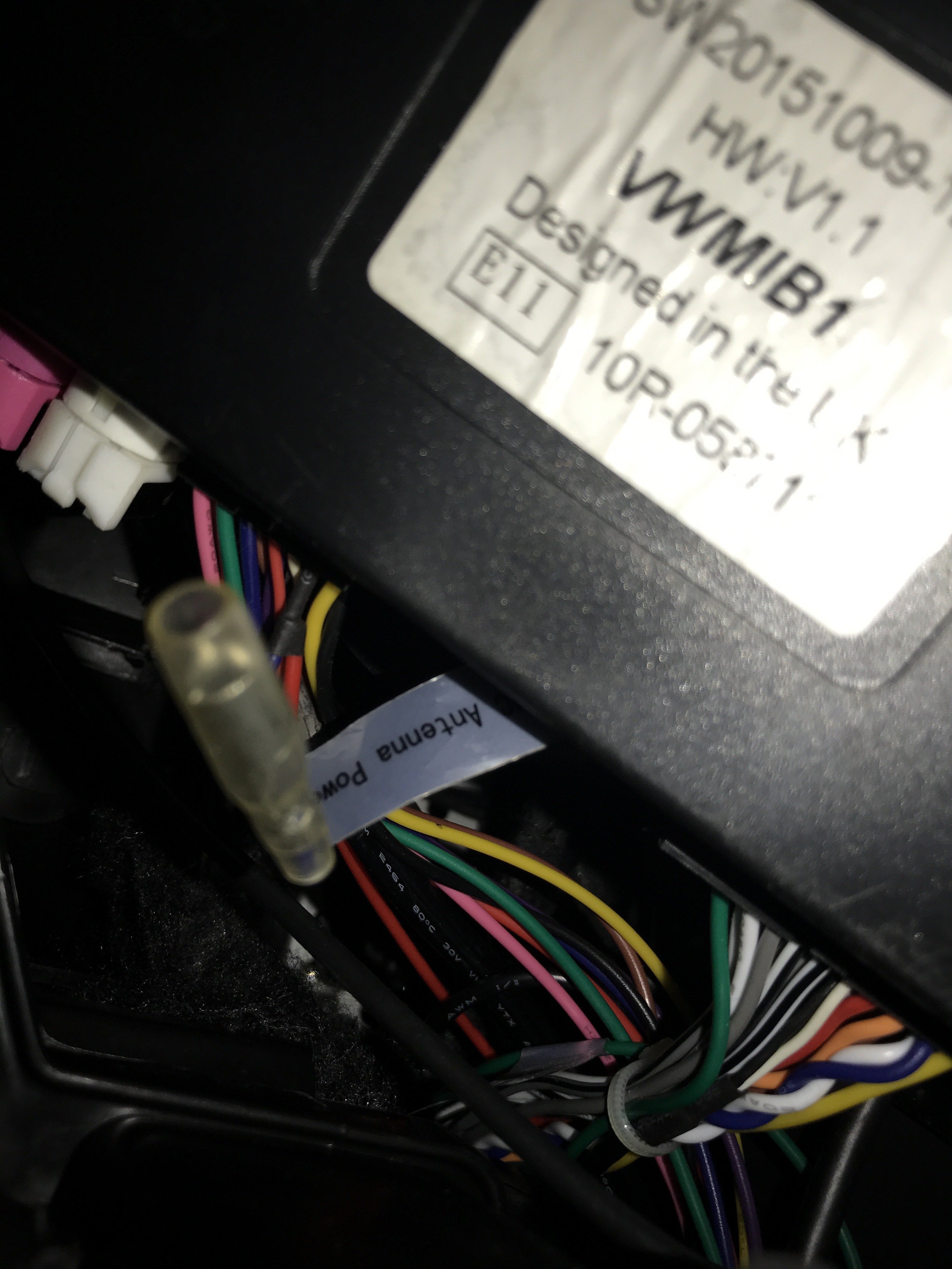

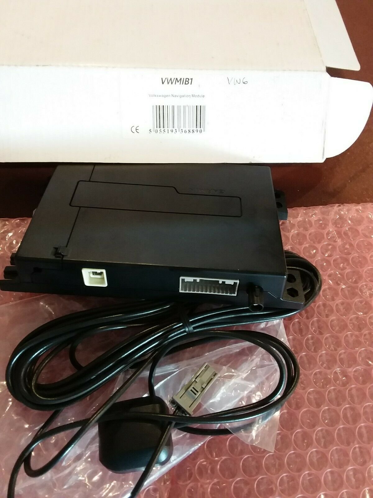

I just installed one of these that I just picked up for £90 from Partshaus in my Golf SV.  Good for the money.  A couple of notes as this was the best thread I found on these and they might be useful to other bargain hunters:
1) Don't bother wiring up the traffic antenna, or contacting Kenwood or Garmin for traffic unlock code.  There is no traffic service anymore, Trafficmaster have shut down their FM broadcasts.
2) Given the above, you can remove the Traffic button from the main map interface in the settings, and replace it with a reroute button instead, which will be more useful.
3) You don't need an SD card extender if instead you get a USB cable, as you can install the SD card in the unit and the SD card is then mounted as a directory on the PC over USB.  I got a right angle USB cable, which looked temptingly like it would allow the door over the USB / SD card to close (even looks designed for it with a little cable exit) but no chance.  So I just popped the door off.
4) The units in stock seem to have 2017 maps installed.
5) I tried to do the good thing and buy a map upgrade via the Garmin Express app  (£50), which detected it and took my money, but seemed to fail to download anything, constantly claiming there was no content for my device..  After wasting a bunch of time with Garmin support I just got them to refund me, and "found" some map images online for something claiming to be "City Navigator Europe NTU 2025.10".  Half an our later I had the unit updated.
