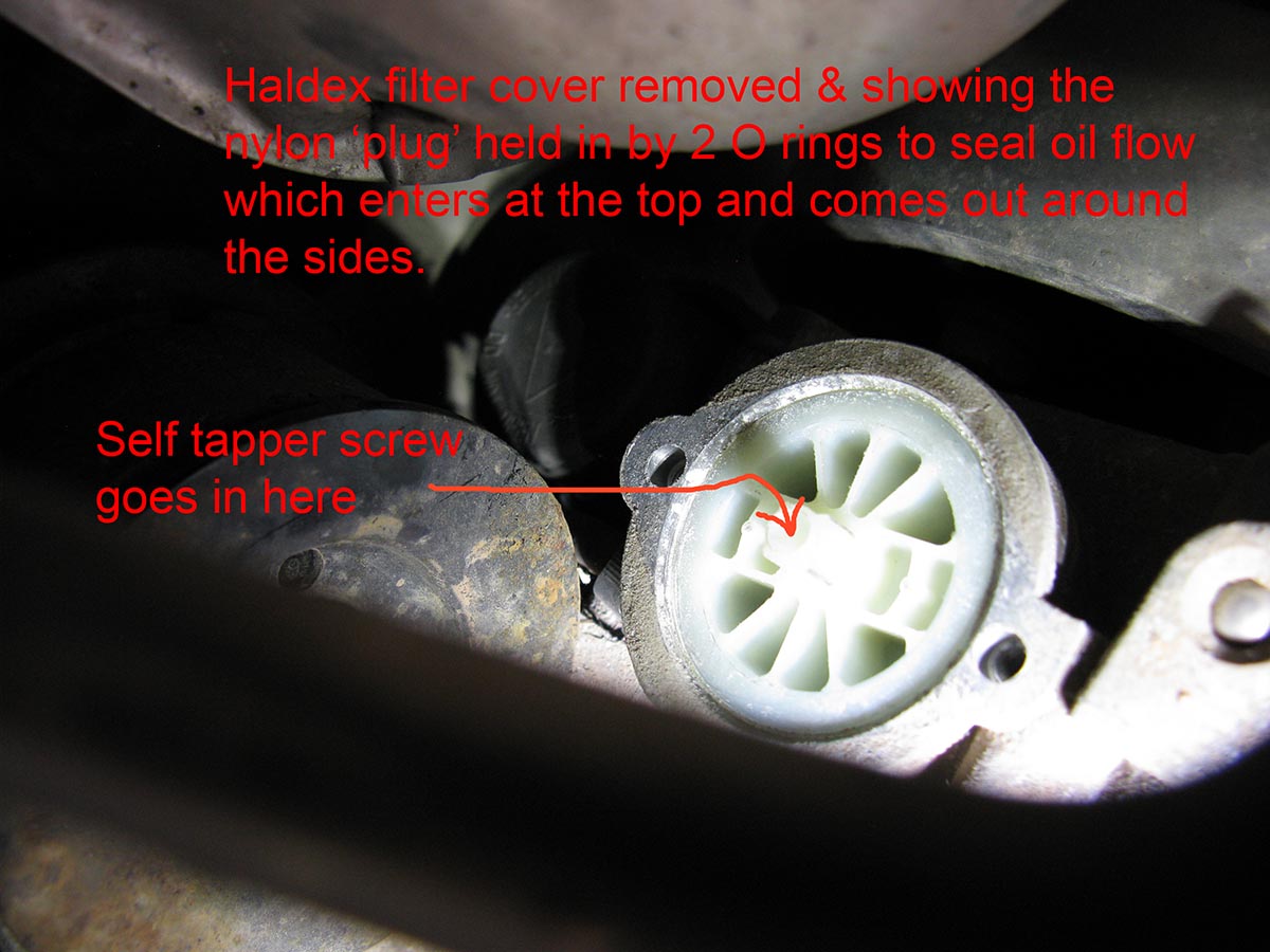

Locating the filter cover is easy and only a torx bit is needed to remove 2 screws and lift the cover. You do not need to drain the oil if you are just inspecting the filter. Due to the silly prices charged for this filter when we are told they are 'fitted for life', I decided on inspection first to see what I had.
The first problem after removing the filter cover is getting the 'plug' out which is pushed in and held by 2 O rings.  The plug is actually the seal and directs oil flow down through the centre of the filter and out through the sides. The centre entry point on the top of the filter isn't obvious as it is a sprung flap with a one way valve behind. You don't need to remove any other parts after the cover to gain access. The plug has deep triangular slots and a raised centre spigot.  There may be cheaper alternative options for buying the filter, but it may not come with the same cover and plug. Don't  take the chance of destroying the nylon plug by grabbing the spigot with a grip wrench - you will probably need to reuse it!

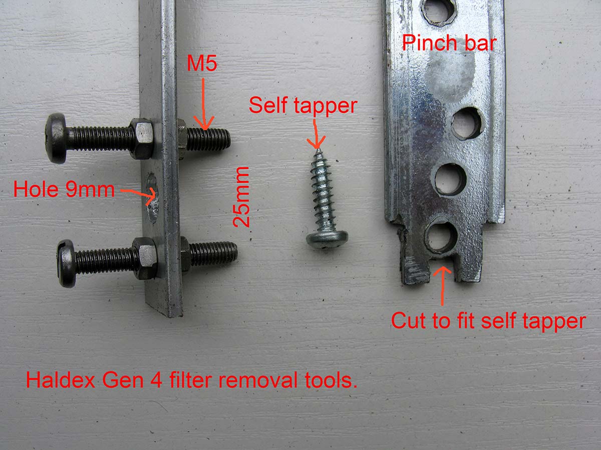

I made a couple of tools to help 'extract' the plug without damage. They are rough and ready using some scraps of builders tie bar, but the photos show the idea. You start by rotating the plug back and forth with the pin tool to loosen it. Then fit a self tapping screw into the centre spigot as far as it will go and use the pinch bar under the screw head whilst wiggling the plug back and forth. Slowly the plug will rise upwards first O ring clears then finally the second. Have a clean oil catch tin underneath because about 4-5ml of oil will come out. It isn't a lot but if you don't change the oil, that is what you need to put back.

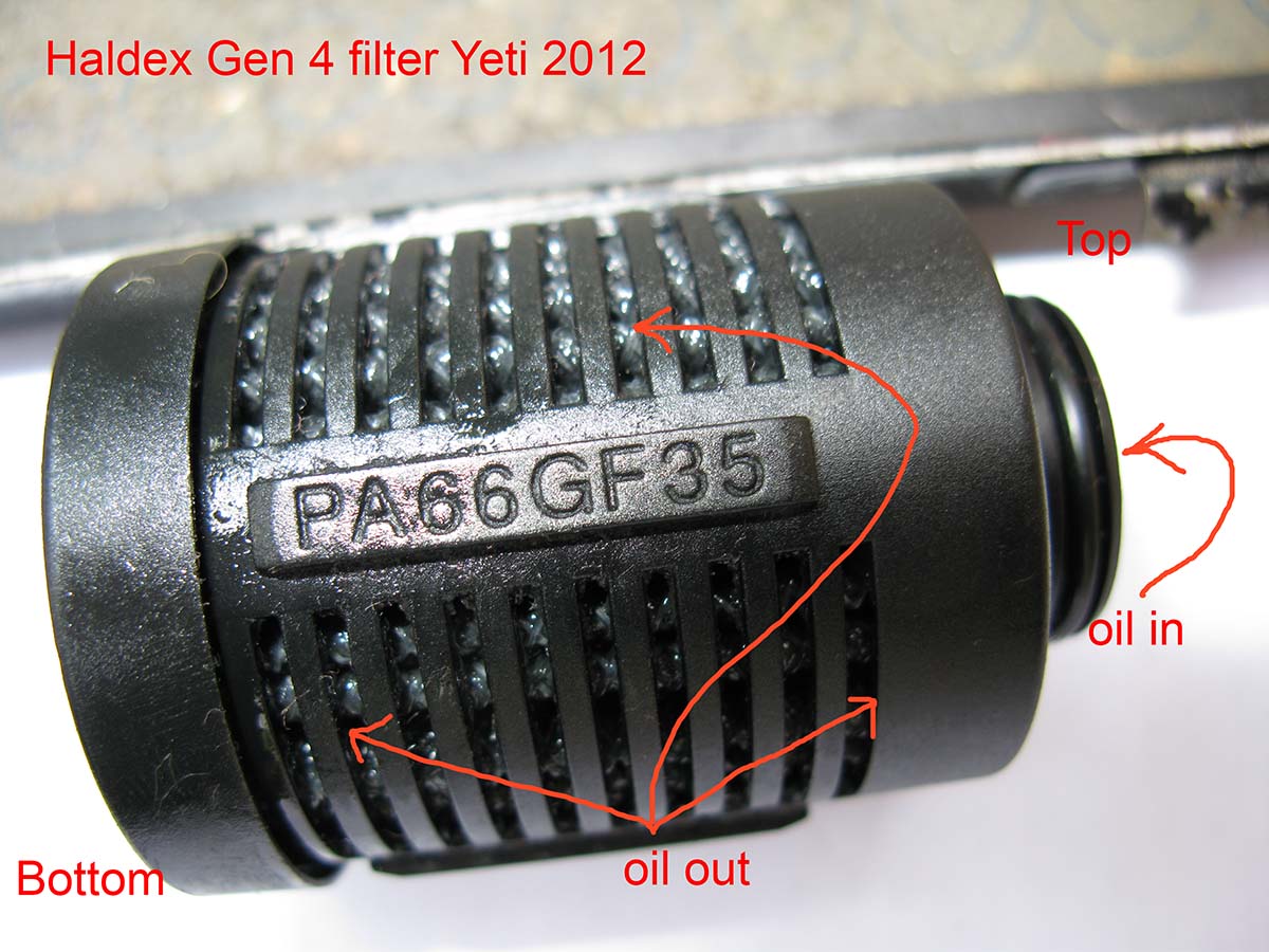

Once the plastic plug is removed you can now fish out the filter. Mine was marked PA66GF35. Finding them is like looking for hens teeth and some kit sellers are making a killing. I suspect because they are supposed to be a lifetime item and are bespoke to Haldex, no body else is offering an alternative. I am going to look at the Land Rover part LR032298 which is supposed to be the same filter  but a different cover and plug price about £40.
For now I wanted to just pull it out and look, but then I decided to give the old filter a good back flush and see what came out. I'm not advocating this as the way to service and reuse Haldex filters!  I did drain the Haldex oil, it is a greenish colour and was very clean. With the filter removed I dunked it in brake cleaner. The inlet is through the centre with a one way valve behind it. It must be inlet coinciding with the valve direction. I was able to open the flap valve then used my airline blow gun and a hyperdermic syringe to push brake cleaner through in both directions. At first I just a got a graying into the cleaner but after several flushes it came through clear.

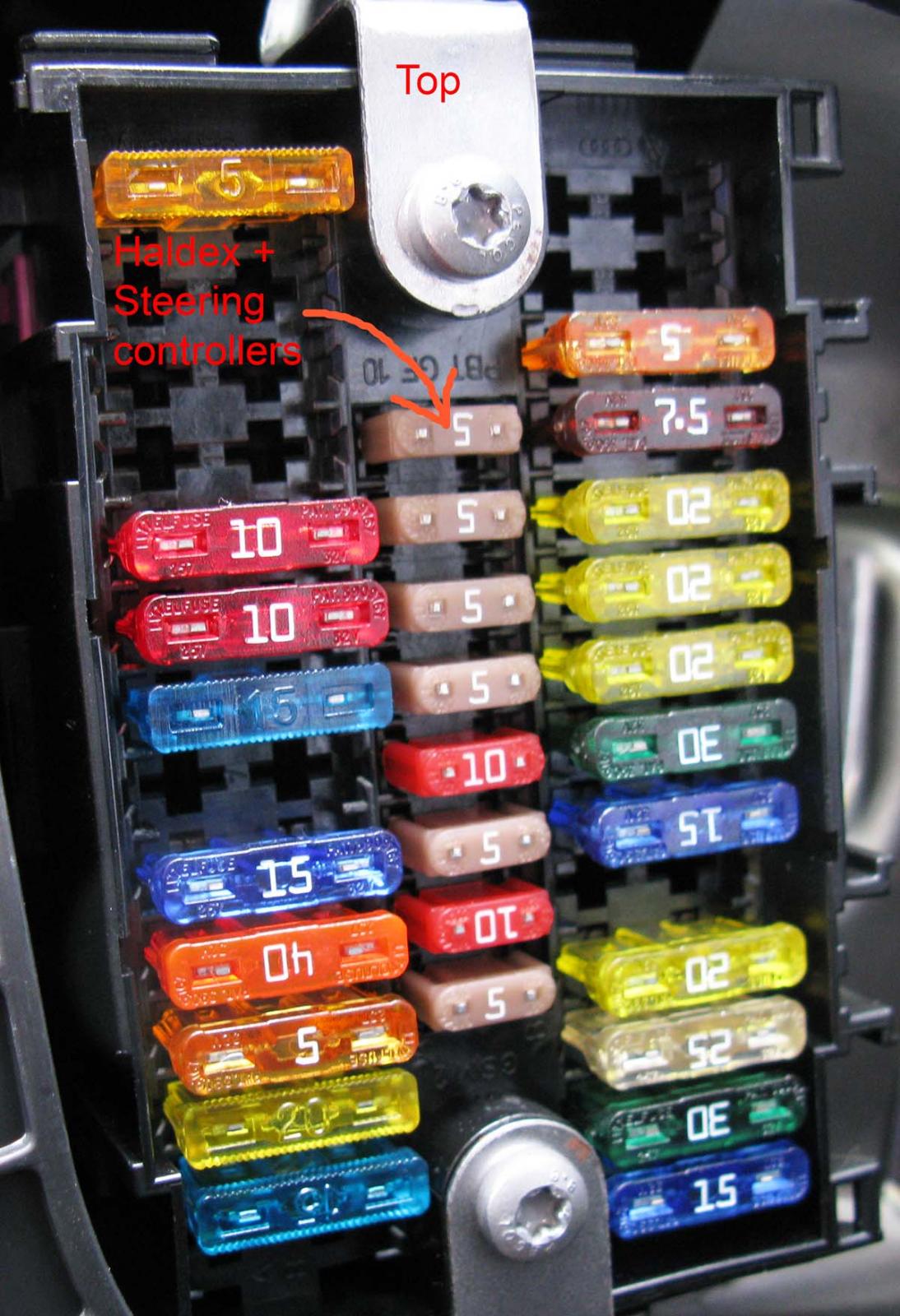

Next on to the electrics. According to some wiring information I've seen, these Haldex units can be wired to share other items on a 15 amp fuse. This could be a disaster if there's a filter clog when the pump motor current rises dramatically. From what I can tell of MY12 fuse layout, Skoda have put my Haldex unit and steering controller on a 5 amp fuse (centre top). The Haldex pump takes about 3.5 amps normally, so I'm happy with that. It has occured to me that if the Haldex motor blows this fuse, then I should get a steering control warning. I need to look further into that. Although I haven't actually replaced the filter, everything looked clean and I'm prepared to go back for another look.
