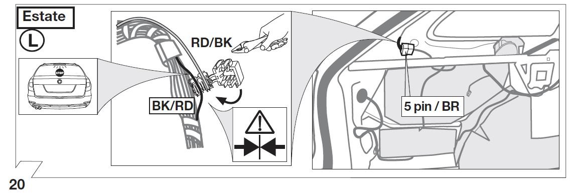

The Brink wiring kit needs to be scotchlocked into the high brake light feed - a Black/Red wire - and the instructions show this:

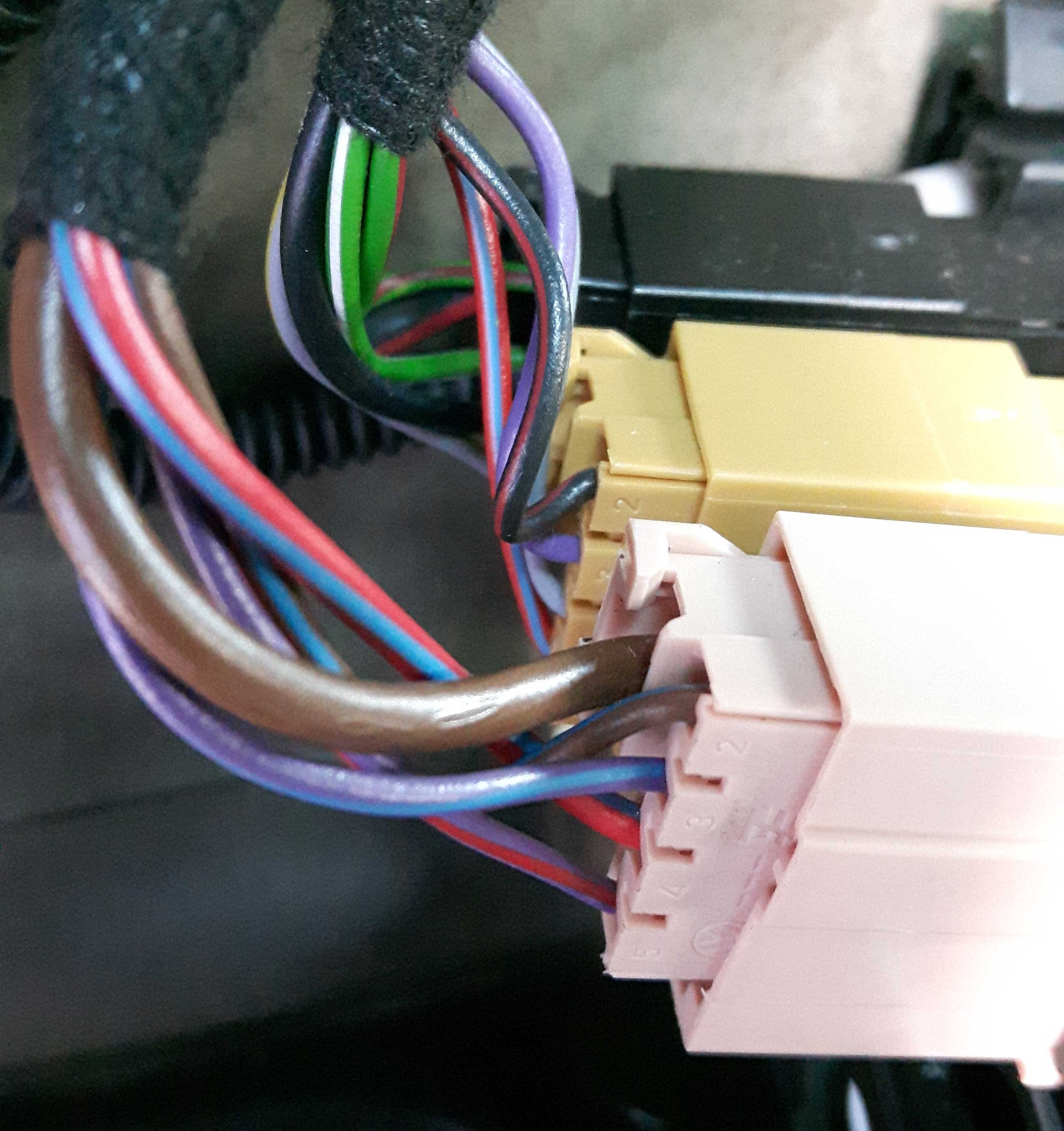

BR apparently stand for 'Brown'. So far so good but I have three blocks at that location - these are the rearward sides (presumably outputs):
Now the middle one seems to be Brown. It has 5 pins but only has 4 wires. The black one at the back also has a Red/Black wire.  Which has made me question what I was about to do (i.e. connect to the middle R/B wire).
Being super-cautious I want to make totally sure I attach the kit to the correct one. Any help gratefully received.

I would say it's the wire in the middle brown plug. I would not use a scotch lock though, I'd solder it on.

Anyway, thanks for the advice, will go with the RB wire in the brown block. Hopefully no more issues.
On reflection, I have a crimper and some crimps - might use those instead of the scotchloks in the kit to splice into the R/B wire.

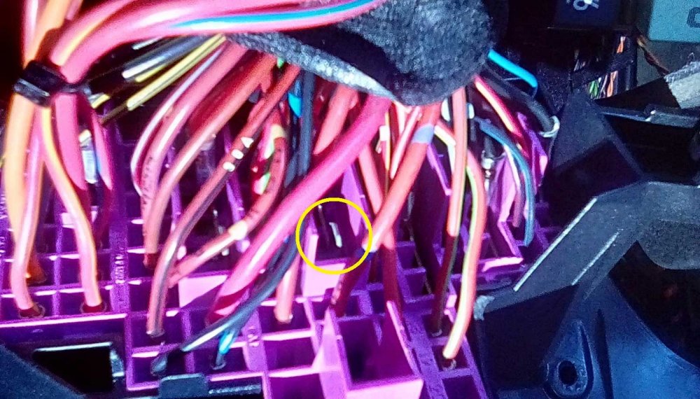

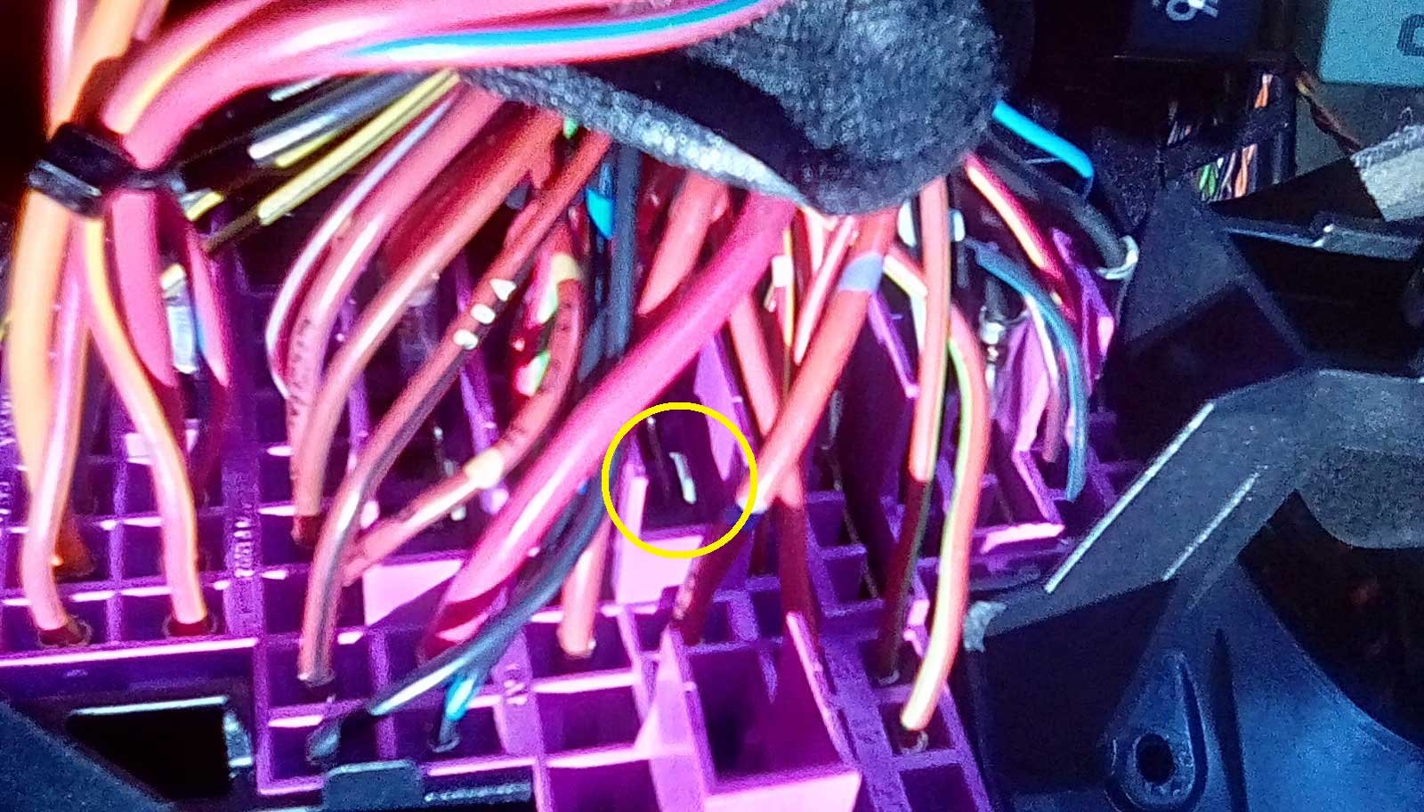

What you're basically doing with the 3 into one cable is taking the feed from the spare permanent live terminal in the rear of the fusebox and feeding the fuses in 43,44 and 45. The spare male blade can be hard to see in the mass of wiring but it is there.

That's great thanks, I think I've found it - there's a spare tab and behind it a thick wide bar/rail with a thick red wire coming off it. (Sorry for the crap tablet photo):
Is that the one?

Yep that will be it. Just check it's a permanent live mind.

Yep, it's a permanent live, thanks again.
