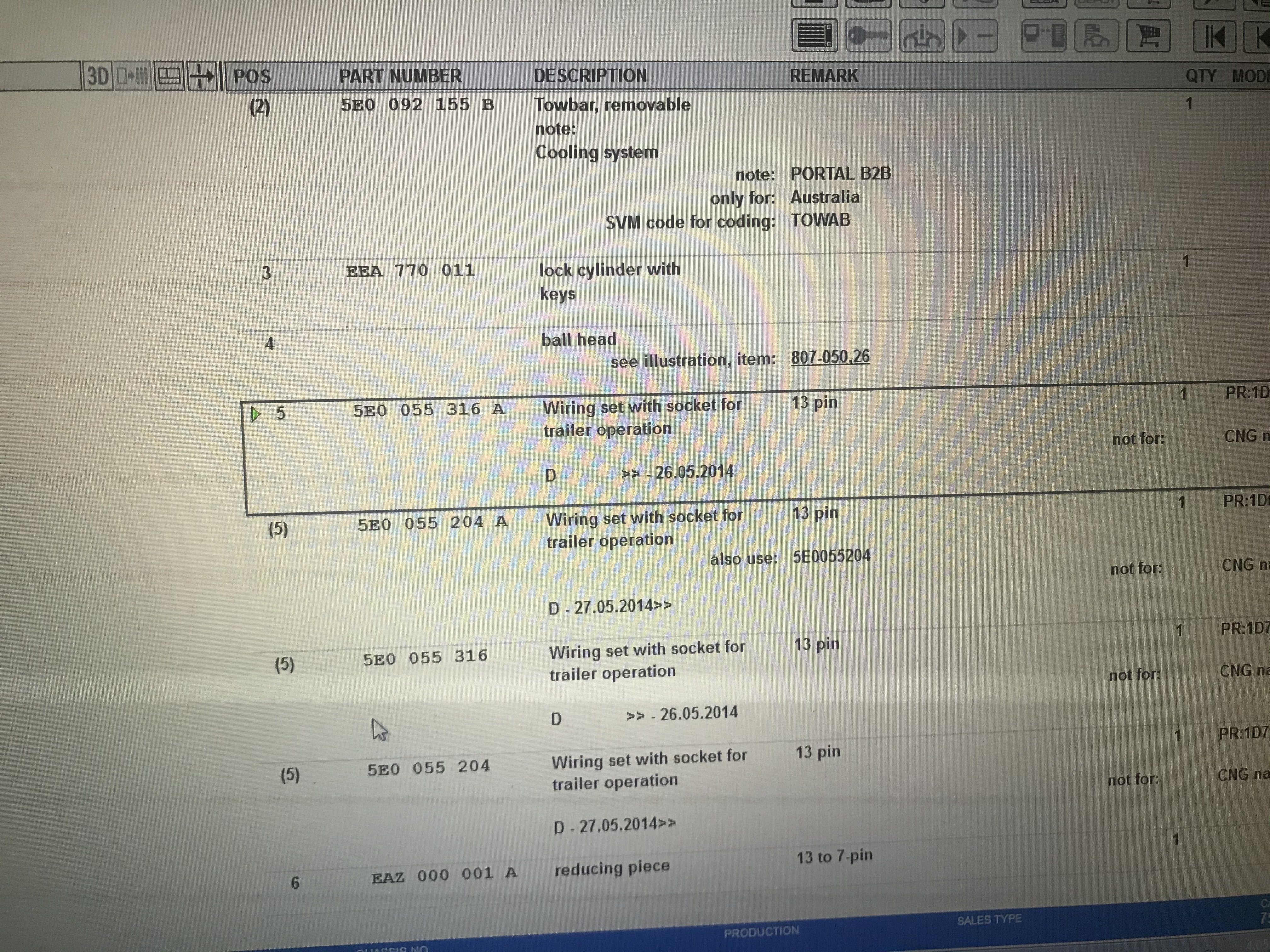

Pretty much every decent towing electrics kit comes with a 13-pin socket these days, even if it's the simpler '7-pin' setup. The Skoda 13-7 pin adapter is really cheap if you need the older style 7-pin socket.

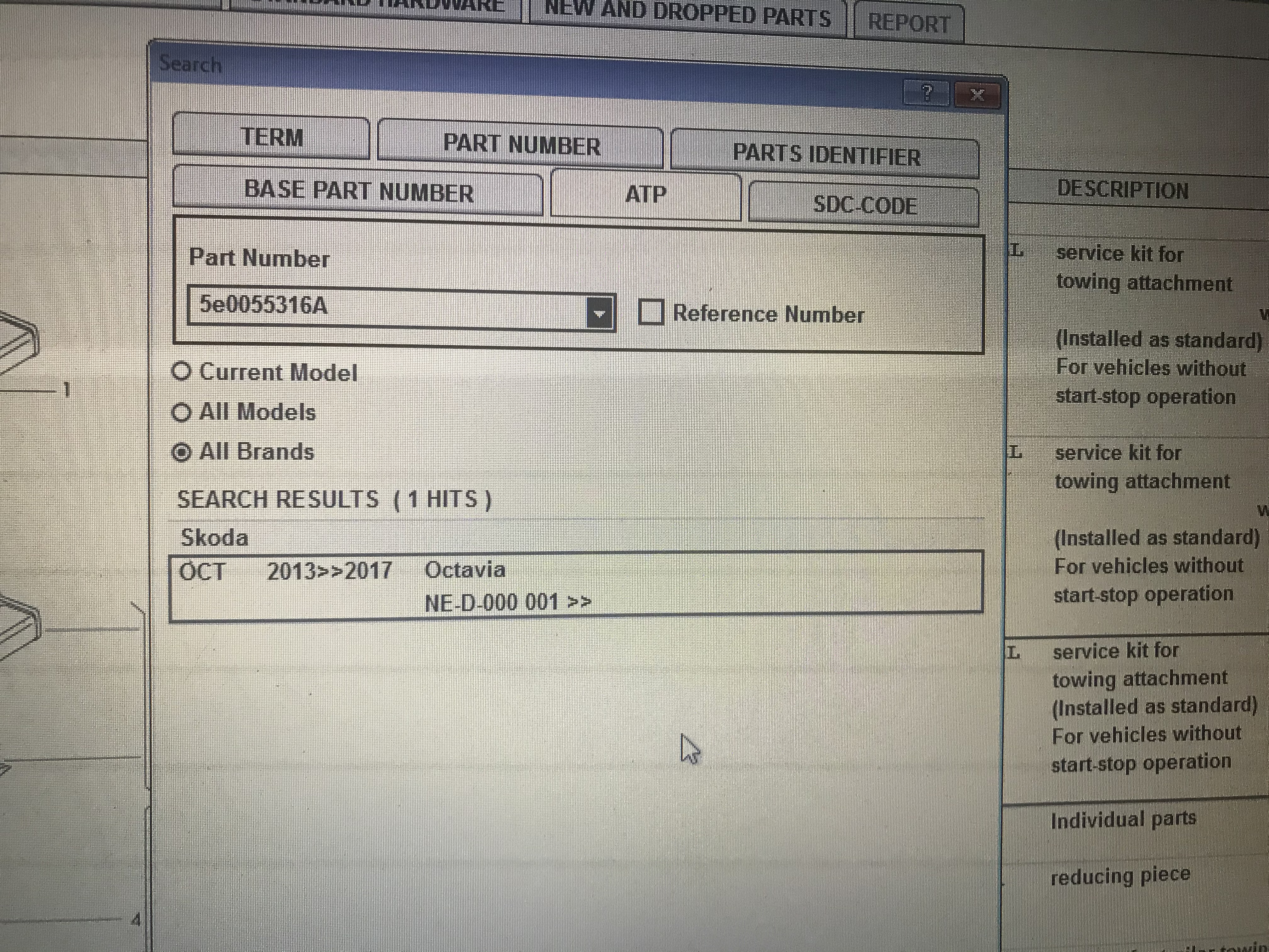

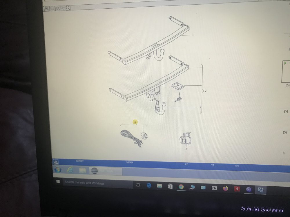

E1880024-7629-4B88-8F2B-E5C19D165B45.thumb.jpeg.364c45672478e4eb21d8d536484b0498.jpegI searched the part number for the Octavia loom via ATP on ETKA, it only comes back as Octavia so may be a bit risky getting that one.
Edited by 3T51704x4
Given the length of the Superb and the fact that the loom has to run from the fuse panel to the boot along the driver's side & then across the boot, it's unlikely the harness from any of the smaller cars will fit.

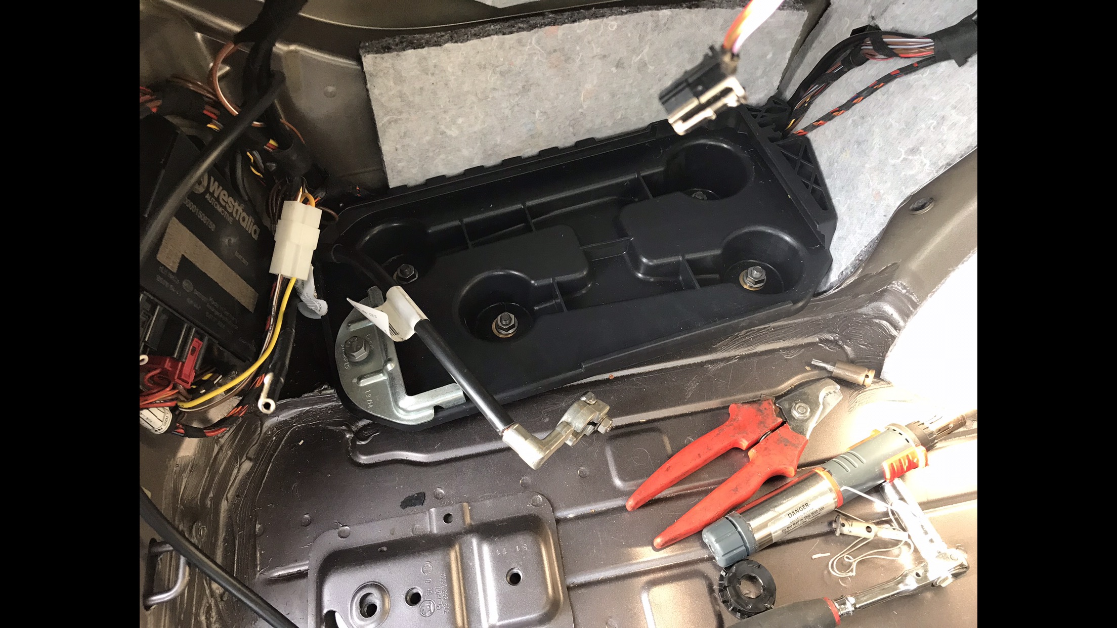

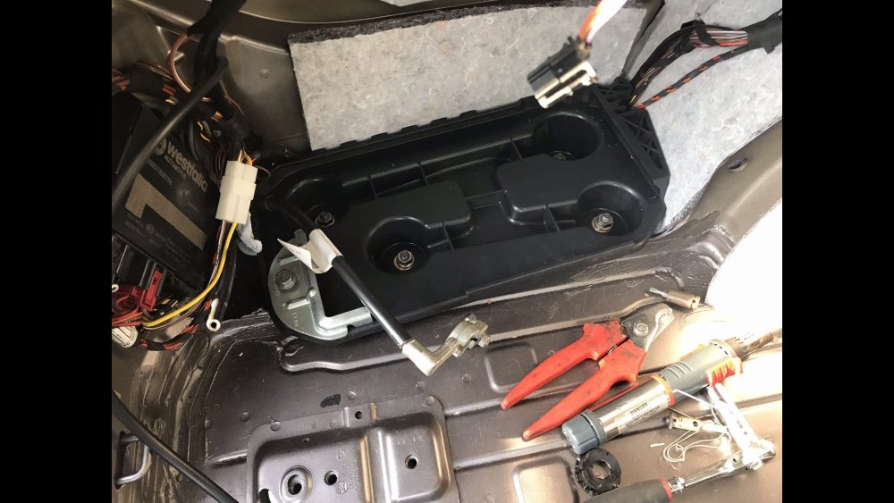

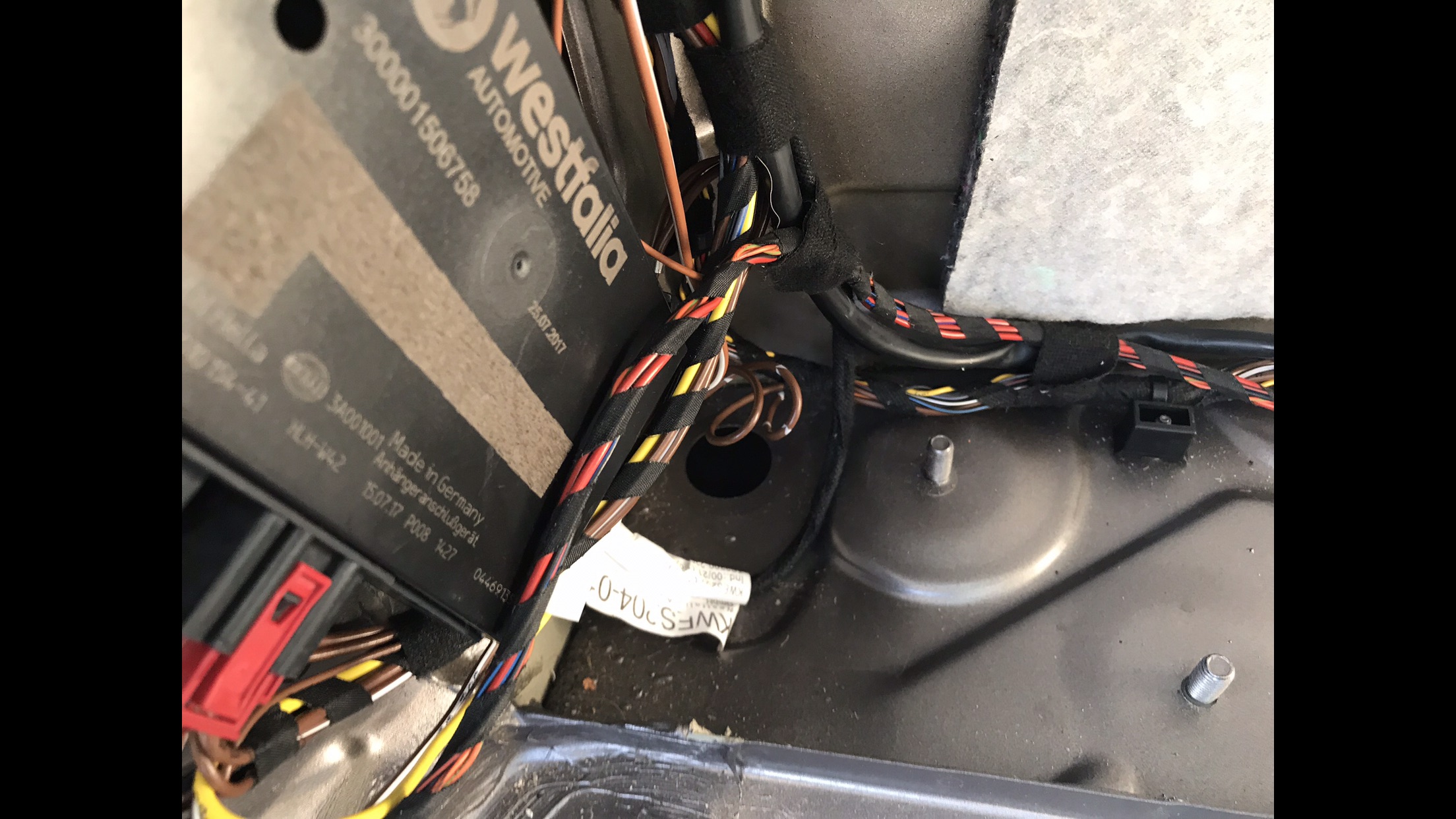

I've fitted loom from VW POLO to superb estate - no problem - long enough.
I suspect there was a lot of hacking involved, and I get the impression that @mushroomnris not interested in a non-standard install. Care to post details/pictures of how you did it?
I don't mind to extend cable, but I think I will stick to dedicated one which I have found on german website, I just need to confirm that this will fit UK version.
All plugs, terminals etc. are the same in Polo and Skoda loom. you just need to extend 2x2.5mm power cables. One to fuse board and one drom trailer plug to the module box.
Like I said - I paid 10quid for brand new loom with module, so it would be rude not to try it :)
Mine was a rebranded OEM ecu
What about the CAN Bus & brake line connections at the BCM?
All there - like in superb loom.
I will put some pics tommorow.
