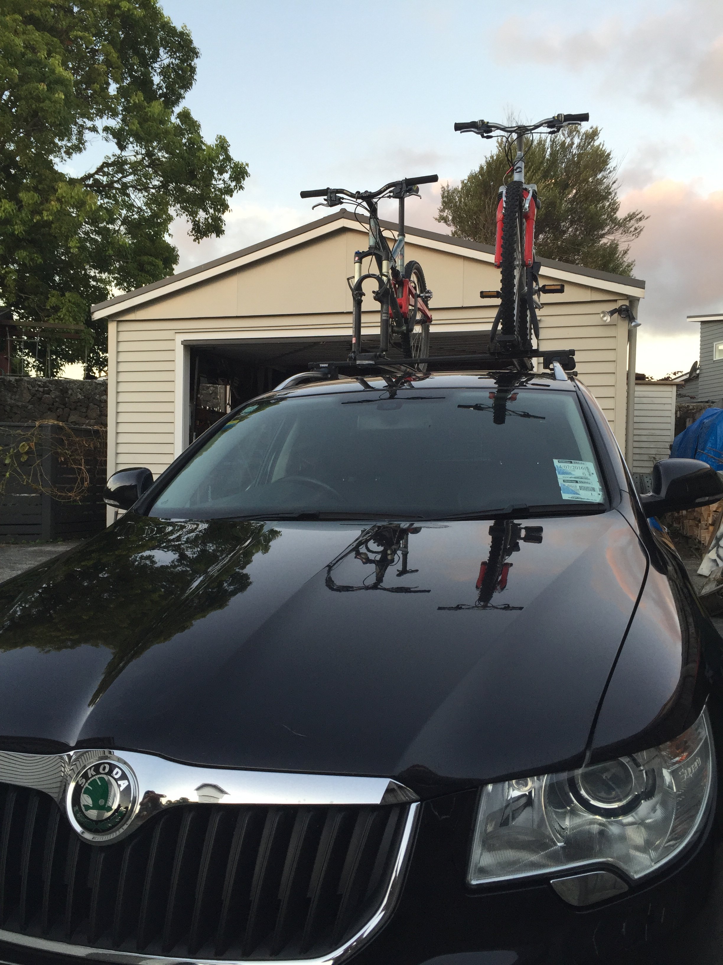

I've tried all the options over the years, and there are so many variables. If you cycle a lot, your bikes are light, and you are fit, roof mounted options are great. But they are not the best or cheapest option for the average person, or taking the kids to the park a couple of times a year. I hate the boot mounted options as they are complicated to setup (at least the first time), can damage the car where they attach to, limit access to the boot, and if the bikes move in transit they can hit the car too.
