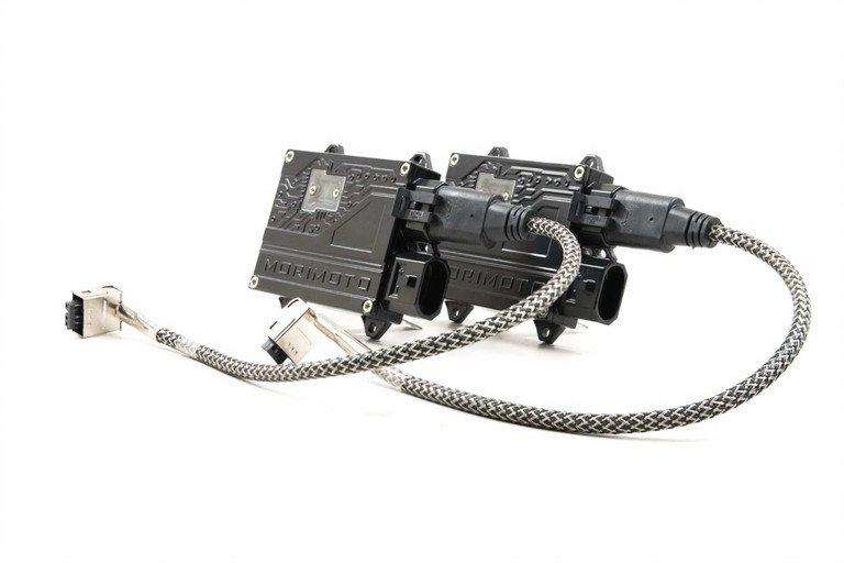

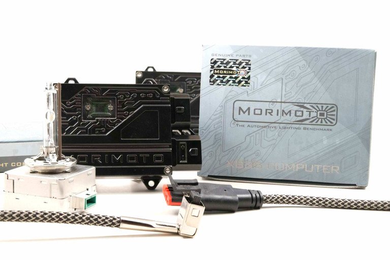

  • Ok so they have arrived from the US today, setup is: Morimoto XB55 D2S connections Morimoto D2S 5500k bulbs Right is the XB55 and 5500k setup, left is OEM setup. The beam seems significantly
  • It took a while but finally the 45W ballasts arrived and I fitted them yesterday. The result is fantastic, let the comparison pictures and videos talk. :) warm up dipped beams high beams activati

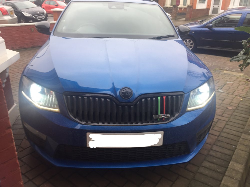

warm up
dipped beams
high beams
activating high beams

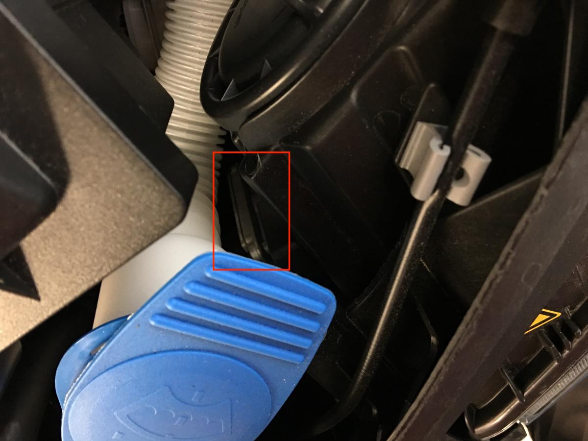

To be able to change the ballasts you have to remove the headlamps and that is impossible without removing the bumper.
I spent some time with checking other possibilities but there's no other way.
Bumper removal is well described here (thanks xpower).
Removing the torx screw behind the headlamp is a serious pain in the :moon: . Thank you Skoda!
I ended up removing the wheel liners as well to gain some access to the screw. Once it is loosened you can rotate (and remove) it by hand as it is a metric screw not self tapping like all the others.
Some advice: mark the beam pattern carefully on your garage wall before removing the headlamps. Also take some photos of the fixing screws. Then you'll be able to put them back in their original position. You can't ruin the height adjustment but it's possible on the side adjustment.
Replacing the ballasts is a 5 minute job once the headlamps are out...
I did the whole thing alone and it took 4-5 hours. Yes, worth it. :thumbup:
And note that the color temperature will shift a little bit to the yellowish side as visible in my pictures. If you are a fan of cool white light you may have to buy new bulbs (Osram CBI for example).
