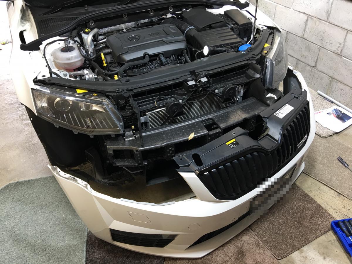

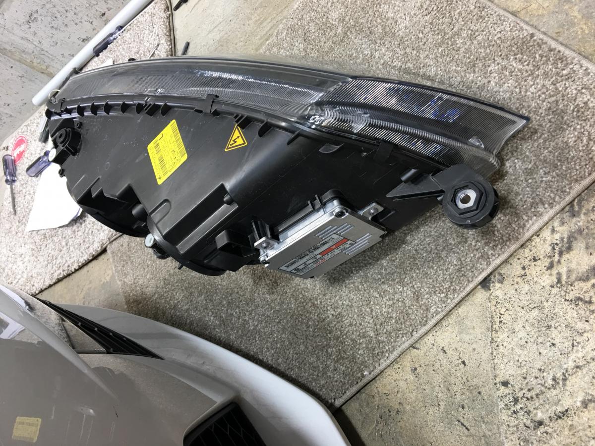

Right, got the 45W ballasts fitted, after a long treacherous battle with the two metric bolts in each corner of the bumper. What a terrible place for them!
I learned a few things which I thought I'd share. Firstly a HUGE thanks to xpower for his quick responses to my late-night questions, you're a champ.  Thanks also to aki78 for his advice on marking the headlight pattern on my garage wall; it was literally invaluable.
If you're doing this yourself:
  1. Buy one of these, it will make removing those hard to remove bolts a little easier (they are still bloody annoying and make up for 60% of the time it took to do the job. If they weren't there the job would take all of about an hour, maybe 2.)
  2. The bolts are T25, not T20. Once I realised that all was well.

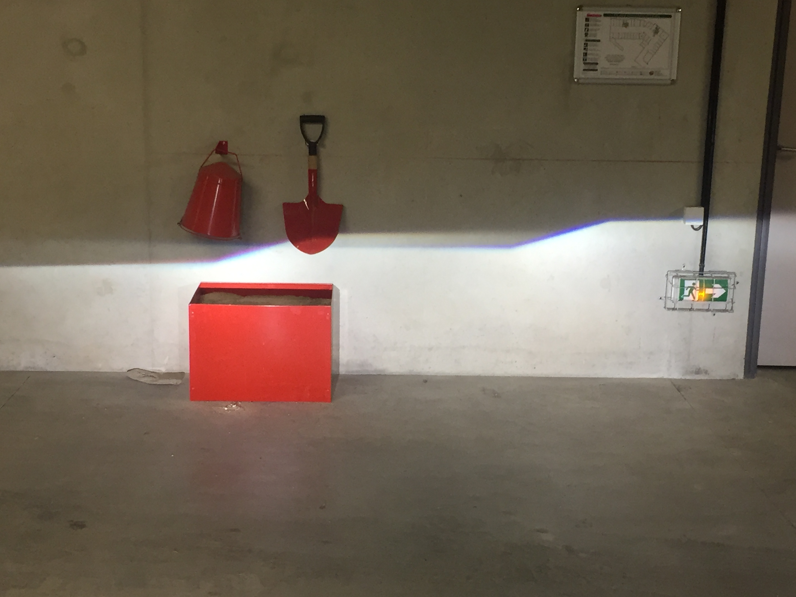

  3. Mark your headlight pattern (the entire beam pattern including the bumps) on your garage wall. It will make putting the headlights back easier as you won't need to try and remember where the bolts were, as you'll have the pattern in front of you.

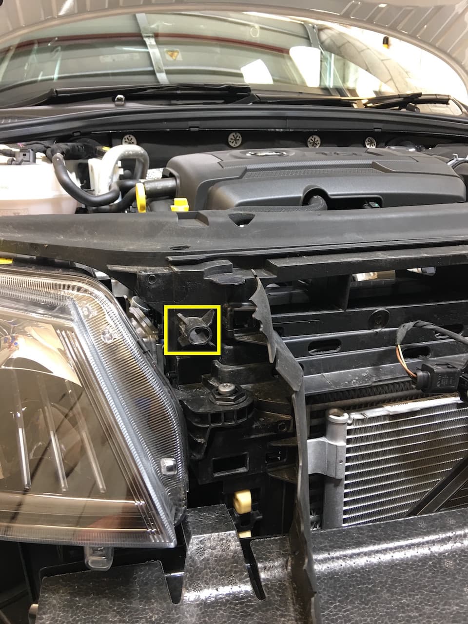

  4. The two clips in the centre of the bumper which 'hold it on' and act as some sort of a guide, I was concerned about breaking. Note, you will need to press them with a medium amount of force (whilst simultaneously pushing the bumper slightly inwards, then pulling it out (pushing inwards relives pressure on the clips so they can unclip)). I've included some photos below of the clips for illustration purposes.
post-143076-0-43929000-1484963339_thumb.jpgpost-143076-0-81889000-1484963353_thumb.jpg
This is what you're pressing down on to release the front bumper clips.
The clip goes inserted in here when the bumper goes back on.

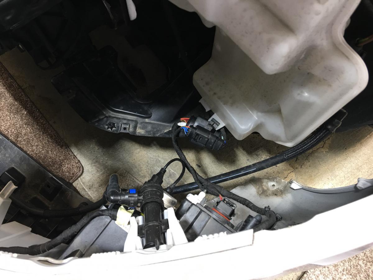

These are the two plugs to disconnect which hold all connections going to the bumper. Mine were on the passenger side (RHD). I couldn't actually get the connections apart but there was enough slack in them to just let the bumper sit on the ground close to the car, and obviously enough room to allow me to remove the headlights.

  • These pictures are from the german forum I linked earlier. They were taken with fix white balance so you can compare the colors. Maybe around 4500 K? I have to say that I am fine with the factory b

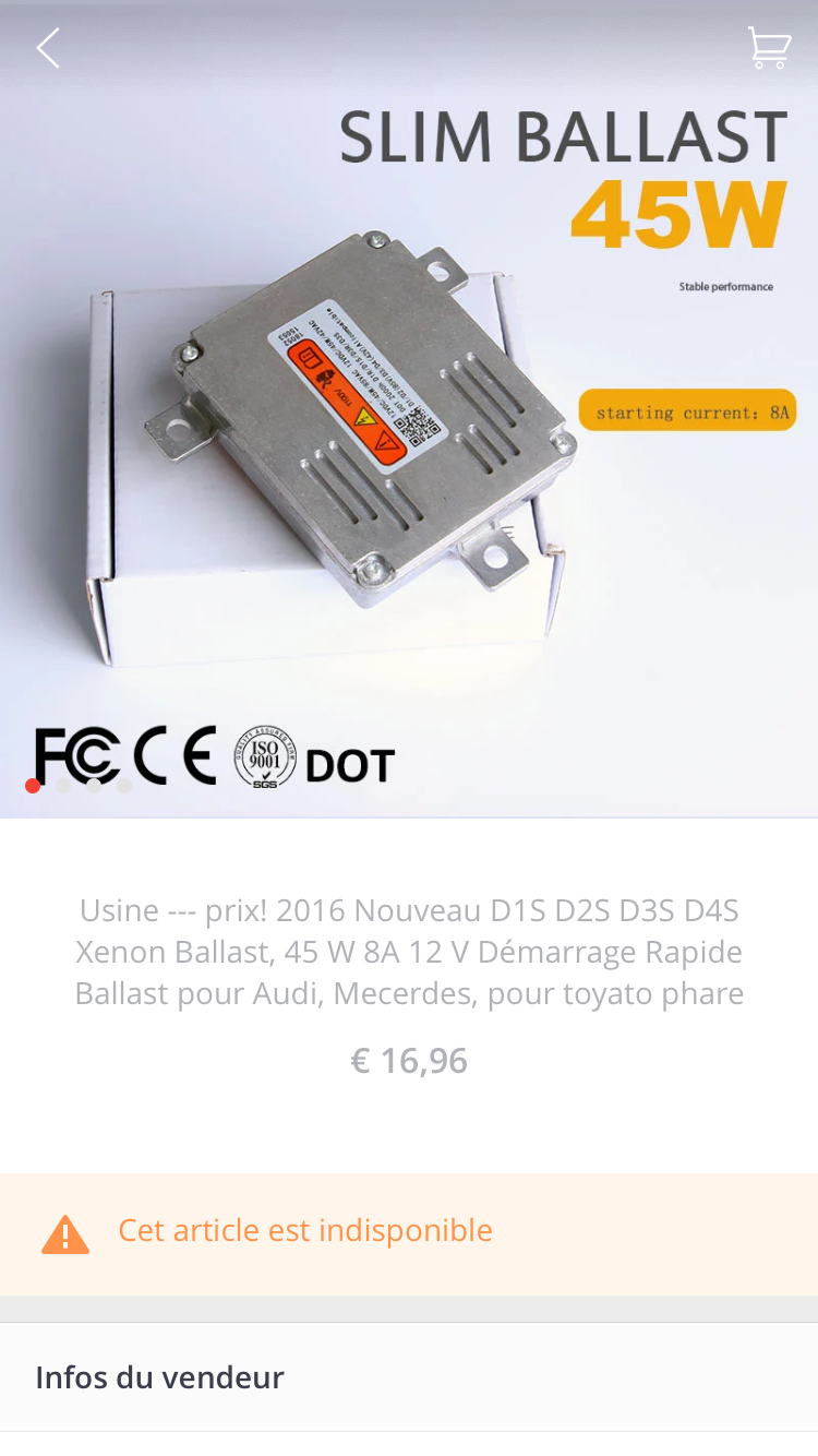

Hello friends. I also mounted the ballast in 45 but I do not see any difference ... on the picture, left the original ballast in 35, right on the 45w ...
Interesting.....
Have you ordered the correct ballast?
What bulbs are you using?
Osram night cool blue intense 5000k
website: see picture

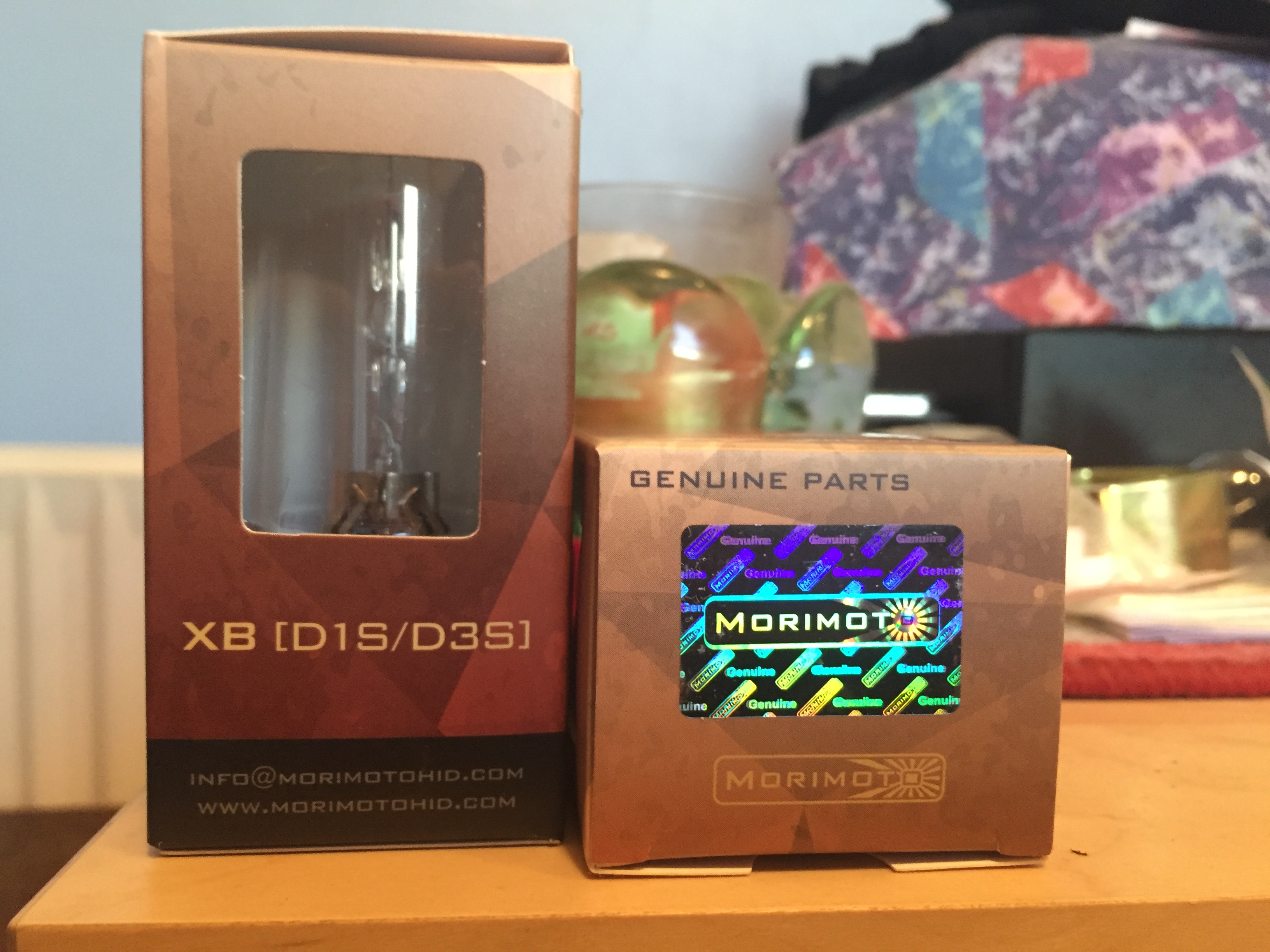

Installed the Morimoto's today & on first glance, noticed that the colour looked spot on B) The colour temp that I'm after :thumbup: but also noticed that randomly that both bulbs seem to do the odd flickering (very faintly) so they would flicker & then not & then flicker? :sad:
First the drivers side bulb would flicker & stop, then the passenger side bulb would flicker & stop, even both bulbs would flicker? purely random! :wall:
It is very random & faint flickering, my old phillip D3s bulbs did not flicker at all & I never touched or handled the Morimoto's from the bulb as I handled them from the base.
Can anyone assist on what to do next before I contact Morimoto & send them back, I don't really want too but if there faulty then I have no choice but too send them back, just strange that my original phillips D3s did not flicker one bit...
Here is a video to show the flickering in order to prove to Morimoto that the bulbs seem faulty but before I do this, can anyone share any input please.
Thanks
Edited by BATVANVRS

Re-installed the Phillips XenStart D3s bulbs around 2 hours ago now & went into a underground car park to test the beam on a solid wall, sat in the car park for an hour & not once did the Phillips D3s bulbs twitch or flicker B) so this is a good outcome because it proves that the Morimoto's are obviously causing an issue in my headlamps :doh: will update the thread once I have heard from Morimoto as regards sending them back but it's definitely left me in 2 minds as in the terms of (A:) I want a replacement from them or (B:) a refund.
Just had an email from Morimoto as regards the bulbs & this is what they say:
Thank you for your email and our apologies for the slight confusion here.
New bulbs will need to break in, which is 40-50 hours of run time.
Once this has been completed the bulbs will not exhibit the same characteristics.
Please let us know if we can be of any additional assistance after this has been performed.
Regards
Mia
So what do you guys think? Would you say this is correct procedure or not. I'm kind of confused to be honest & part of me is thinking can this be right or not?
Thanks
Yeah I would give it a chance, aki78 has said on a couple of occasions they need wearing in for the colour to settle, I wouldn't be surprised if that extends to flickering. I know mine look better after about 10 hours of use.
Regards
Mia
Thanks
Faulty bulbs in my opinion. They should not flicker even if they are brand new.
Have you sent your video as well? If yes their reply is simply not acceptable I think. Get your money back.
There's a similar problem here, maybe there was a bad batch?
I agree, bulbs should not flicker and are unlikely to improve after "burning in".
Cheers guys for your input :thumbup: I glad that this forum has great members to help out B) because I would of probably settled for the 40-50 hours but then as aki78 has pointed out above, this made me feel that I'm just being told a general response to be kept off of there back!
This is my reply back to Morimoto
Hi Mia
I have attached 2 video links & to be honest I don't feel the bulbs should flicker or twitch especially as there supposed to be brand new, I know that you have to run in bulbs but that is purely for a temperature point of view.
I feel these are a bad quality/faulty and I don't accept that you have to run them in to stop the twitching or flickering! As you can appreciate I don't want these to cause further issues to my lighting system in my vehicle.
I know a few other people that are running the D3s 5500k bulbs & none of them have this flickering or twitching from the start. This just makes me believe I should of purchased the Osram CBI as I'm sure the quality control would of been far superior!
I would either like a full replacement x 2 D3s 5500k bulbs (but tested before shipping out to me) with the courier & import charges already prepaid for via yourselves or alternatively a full refund as I paid via PayPal so I know I'm covered under there policy & I will send these bulbs back to you
Thanks for your prompt response & assistance as regards the problem/issue that I'm experiencing.
