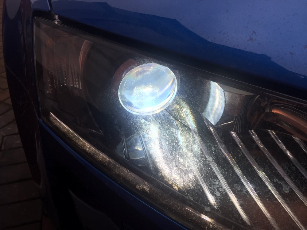

  • Ok so they have arrived from the US today, setup is: Morimoto XB55 D2S connections Morimoto D2S 5500k bulbs Right is the XB55 and 5500k setup, left is OEM setup. The beam seems significantly
  • It took a while but finally the 45W ballasts arrived and I fitted them yesterday. The result is fantastic, let the comparison pictures and videos talk. :) warm up dipped beams high beams activati
  • These pictures are from the german forum I linked earlier. They were taken with fix white balance so you can compare the colors. Maybe around 4500 K? I have to say that I am fine with the factory b
fitted the osram nightbreaker ones last week not a hint of flickering, took about 10 hours to settle down colour temperature wise and have remained constant since

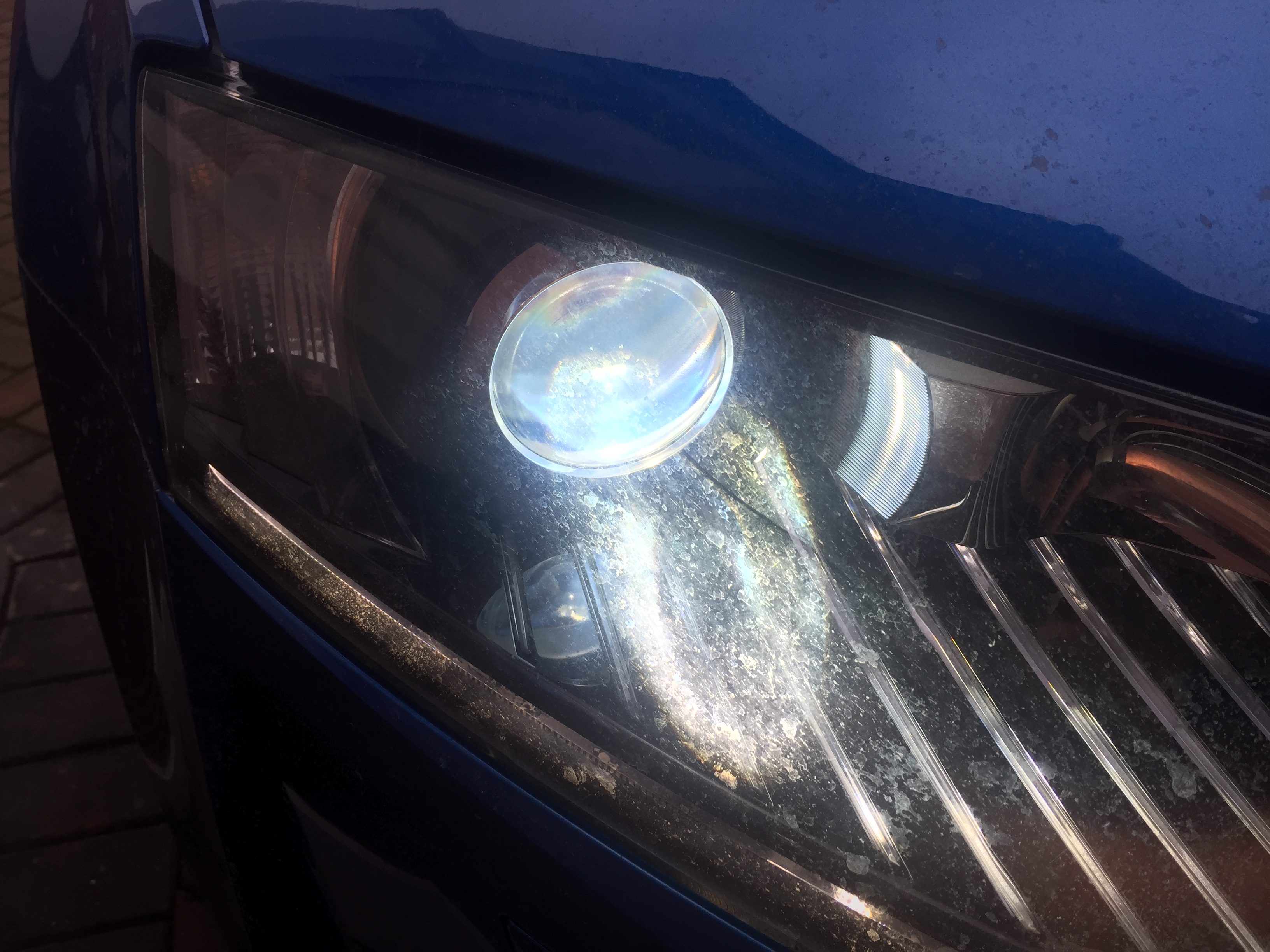

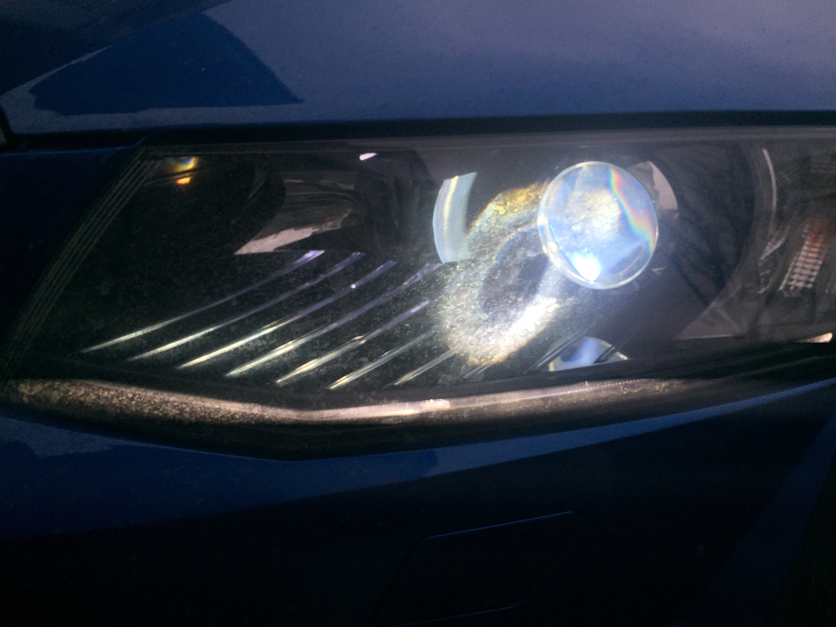

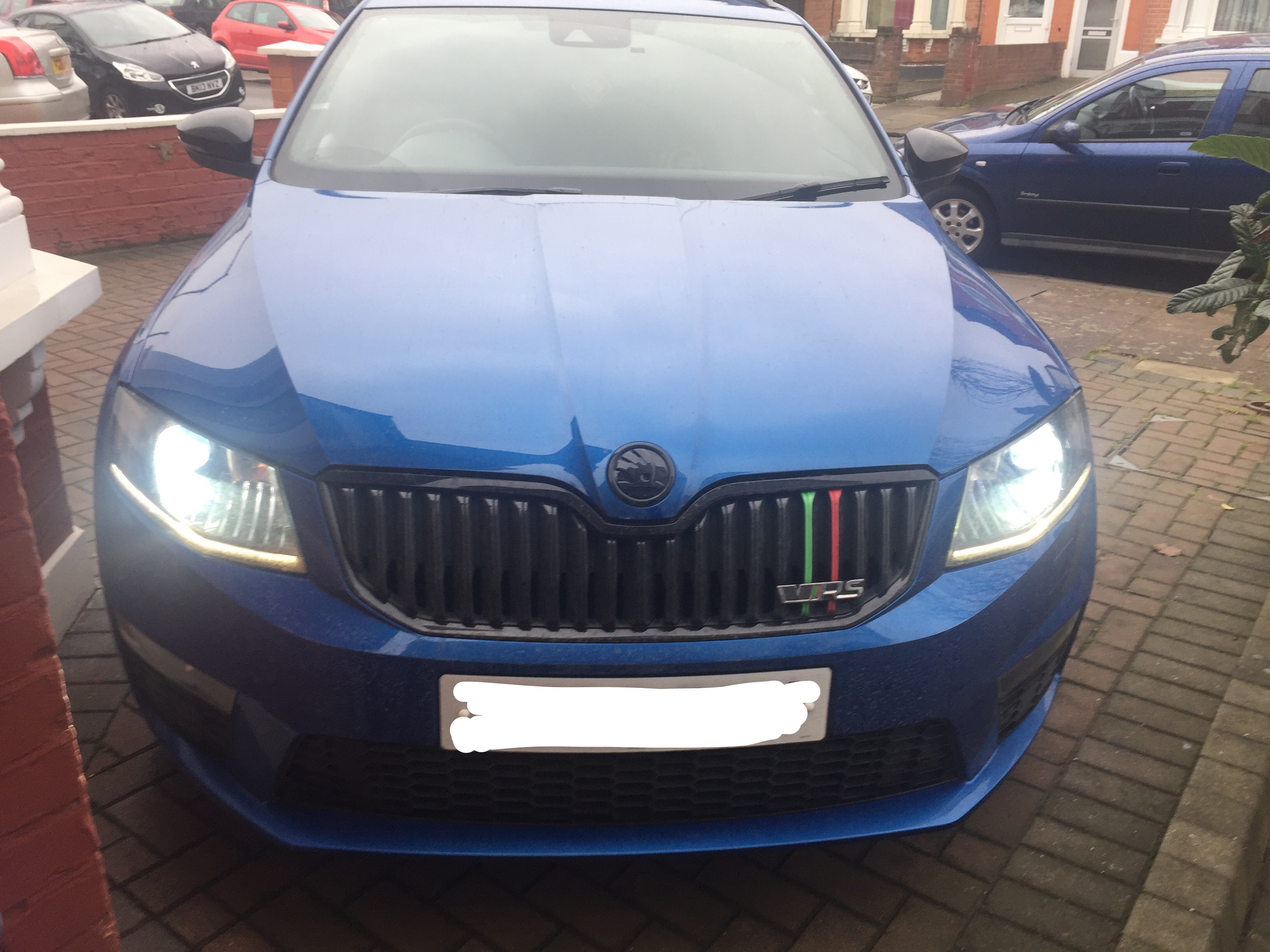

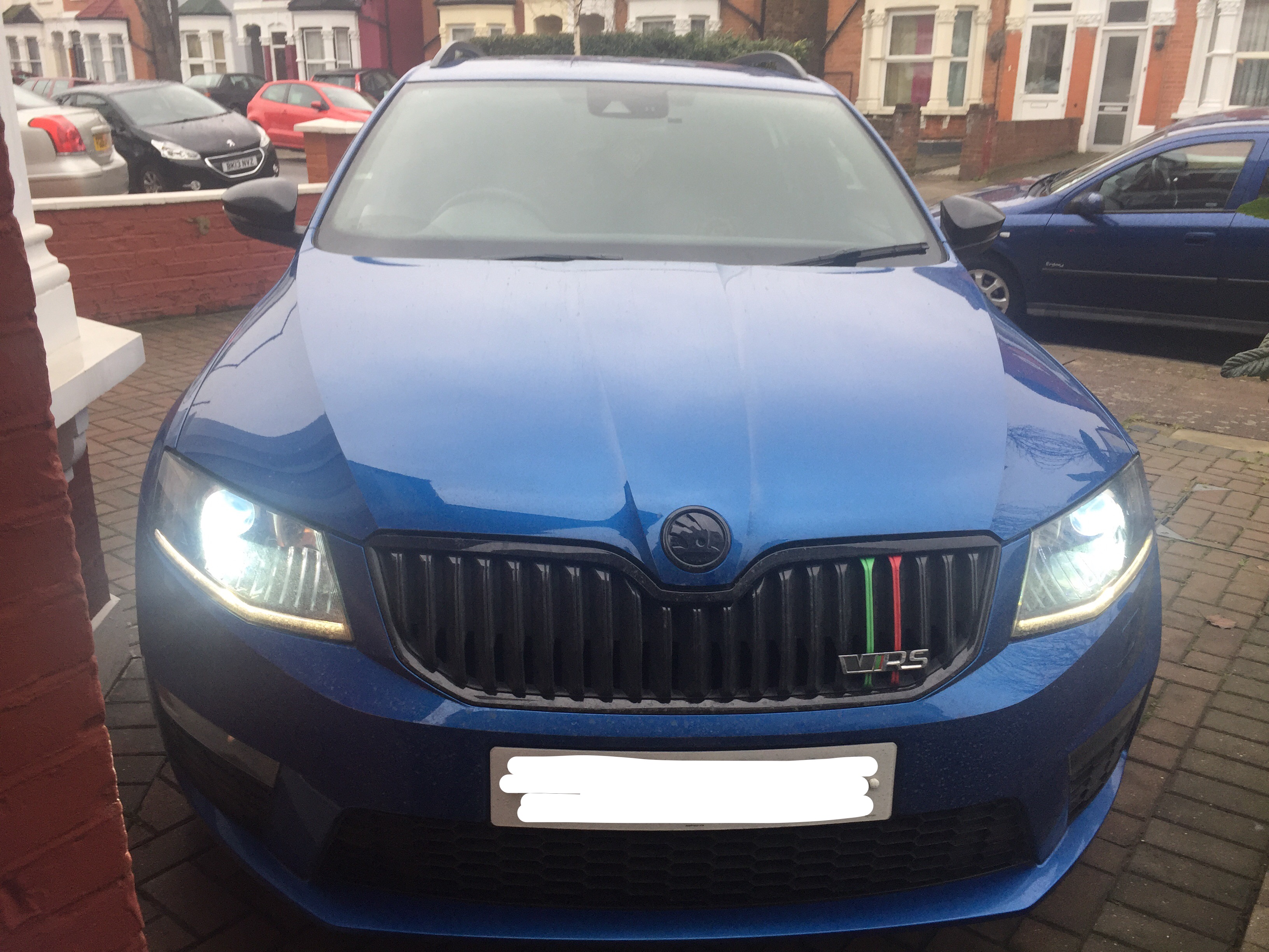

A few pics:
That's good news - but are they significantly better than stock?
@BATVANVRS Glad you sorted the fiasco with the original set of bulbs. They look quite blue from the images, especially compared to the DRL strip. How do they appear in person? I know camera settings and white balance etc can have a massive effect on how they appear in images.
I actually tested them last night & I found them to definitely be a improvement over the stock phillips bulbs, I wouldn't say a huge improvement because without changing the ballasts that's when I suppose you would notice the huge improvement in terms of further light beam projection etc...But as for colour temperature there definitely much better, more white with a suttle tang of blue B) as compared to the original phillips stock which I found them to be more yellow with a tang of white. Its actually a better light on the road with the morimoto's if I'm honest, more pleasant on the eye & the reflections of light from the vehicle in front of you or street signs actually look more pleasing on the eye.
They do look quite blue from the images above, just as the DRL in the last 2 images actually look a bit yellowish, I suppose it does not help that my car is dirty & needs a clean but the lights actually look a lot better in person as the camera does not pick up the true light effect or colour temperature etc, there definitely more white with a tang/hint of blue, also my DRL's are set to dim when the dipped beam is on (maybe why the last 2 images look a bit yellow?) or just dirty lenses & needs a clean.
I will try a post up a video later on tonight so at least we can see the lights at night on how they look but before doing that I will at least give the lenses a clean/wipe down.
