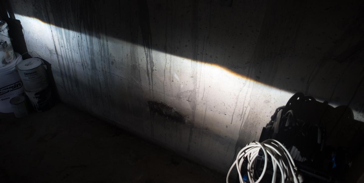

These pictures are from the german forum I linked earlier.
They were taken with fix white balance so you can compare the colors.
Maybe around 4500 K?
I have to say that I am fine with the factory bulbs with their bit more yellowish color at 45 W.
When I look at my headlights I can't tell it's more yellowish now (yes, it's visible on the road).
The choice is yours. :)
If you are afraid of the regulations in your country you can contact the seller and ask for 35 W stickers. ;)
The german guys also did this in a few cases.

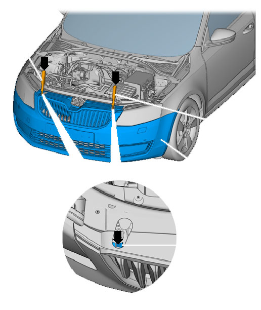

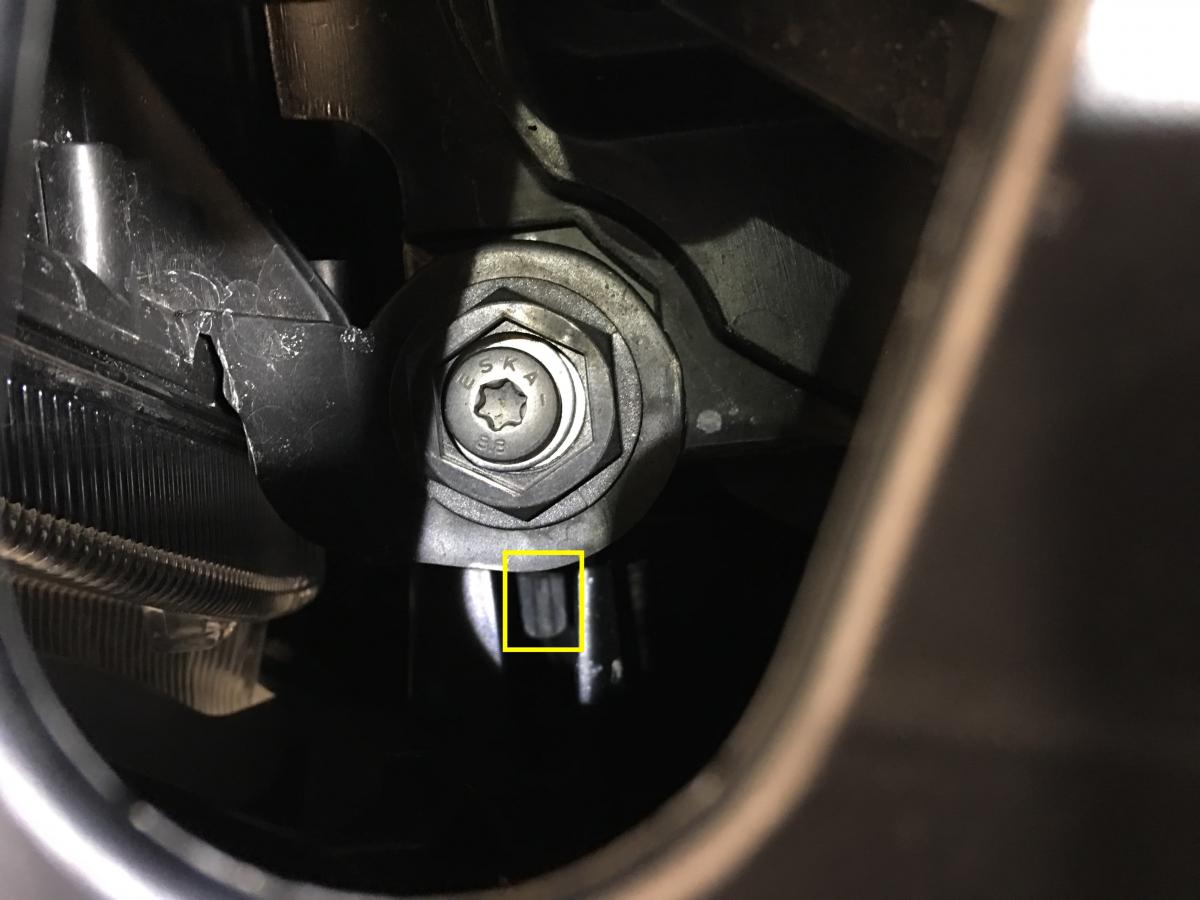

OK I've given in and placed the order for the ballasts.
Reading through xpower's well written instructions, I had one question. Where do I need to press with a screwdriver to release the clip - is it the indicated yellow area in this picture, as in in the hole? Do I need to remove the headlight bolt at the same time?
87BB3DE3-933D-44E1-BA60-860A466CC852_zps
EDIT: I see now, must be this one here:
Edited by mabnz
Yep, that's it.
Picture from the service manual.
Edited by Petunet

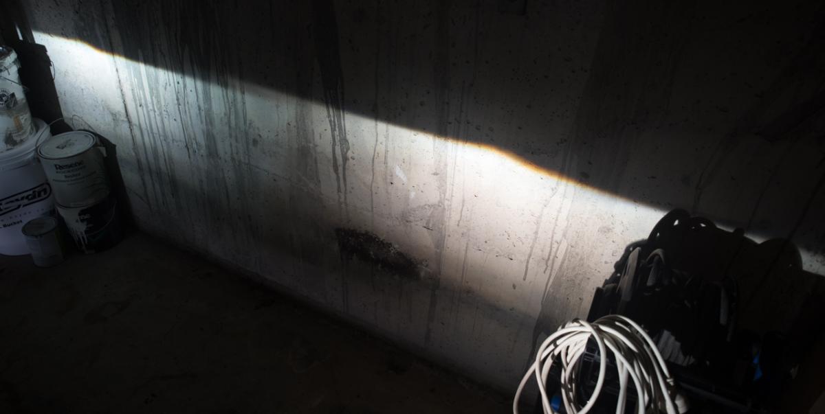

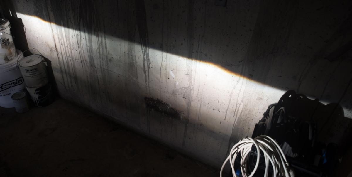

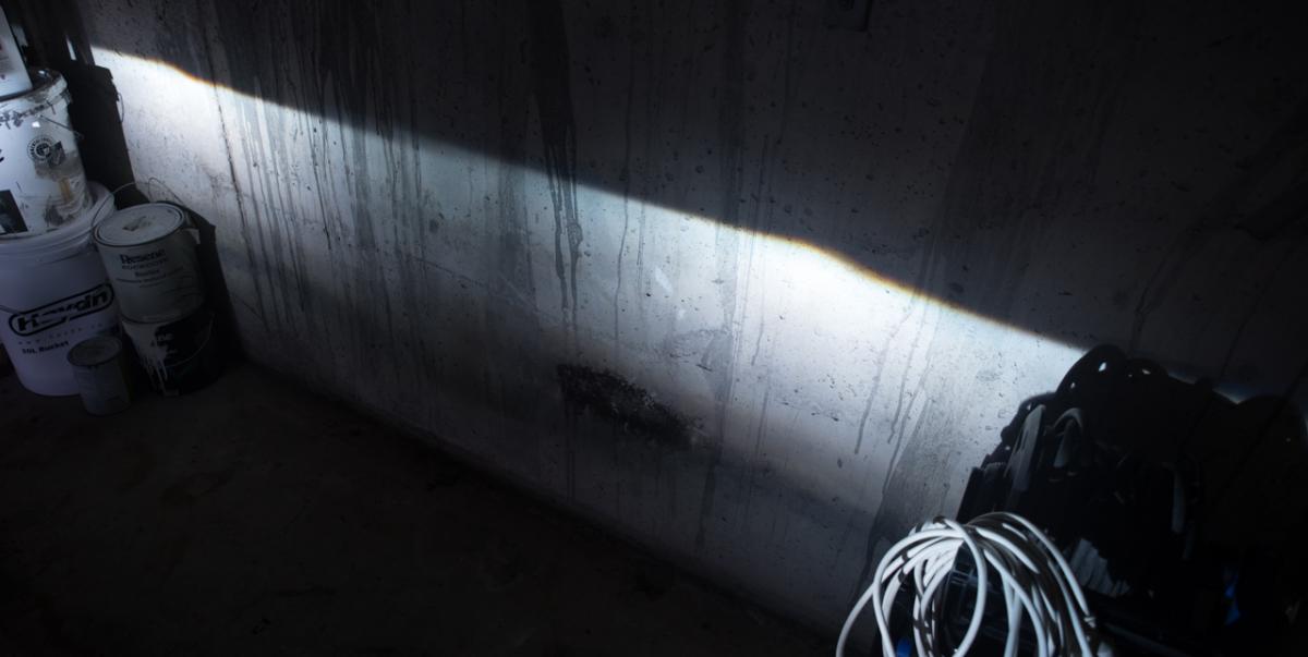

The lighting gods (aka DHL) delivered me a Yeaky present today, so I grabbed some pics (still stock 35W ballasts at this point). I went to some length to maintain the same ISO/aperture/colour/shutter speed, so they should be indicative.
Stock bulbs (Phillips 4300K)
6500K Yeaky left, stock right
5500K Yeaky left, stock right
5500K Yeaky both sides (the right seems to be slightly whiter than the left for some reason)
There doesn't seem to be any increase (or decrease) in luminosity, but I'll know for sure once I can get out at night on the road.
Edited by mabnz
Have just tried them on the road and they are terrible. The colour is awesome, but there seems to be dark spots now in the beam (which definitely weren't there with the stock Philips bulbs). On high beam it's even more noticeable.
I don't know if this is the Yeakys or the projector, but it makes them worse! Perhaps the Yeakys aren't fitting in the lens the same way the Phillips bulbs do.
Edited by mabnz
Next try will be the morimotos :-)
