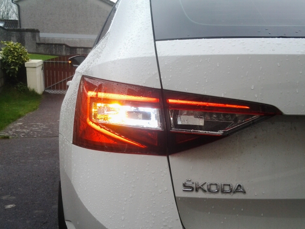

Sorry for bothering you again L4wence, The bulbs don't fit as the 'locking pins' are in a different position to the holders. The pins should be at '12' & '6' but as you can see mine are at '12' & '4'. Were yours like that or have I been given the wrong bulbs? They appear to be the correct ones????????
Are you sure you are trying them in the correct bulb holders?
They are correct, the 12 & 6 o’clock bulbs are the reversing lights (reversing lights are closest to the tailgate)
Didn't even think of that, it was ****ing rain so was rushing, cheers Gizmo
Er..that was embarrassing! Anyway fitted the new LED indicators, way brighter & way better :-)post-135704-0-29314600-1455375026_thumb.jpg
Glad you got it sorted in the end Rebelred :thumbup: They are miles better than the standard indicators.
I Agree 100 %. I'd highly recommend them & there is 20 % off them at the moment (see L4wence's link )
