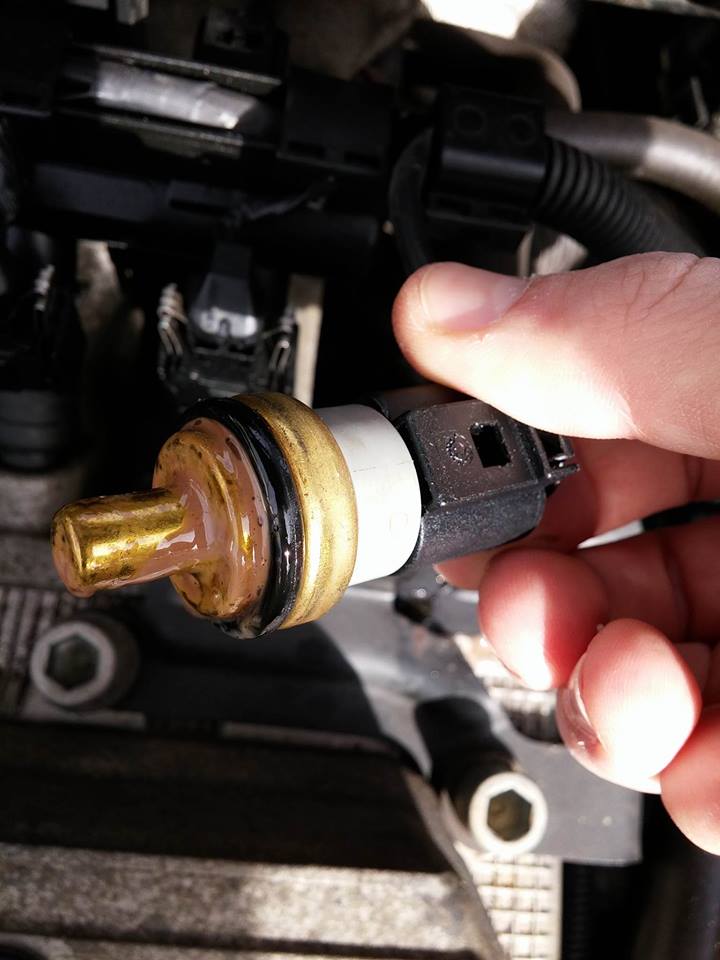

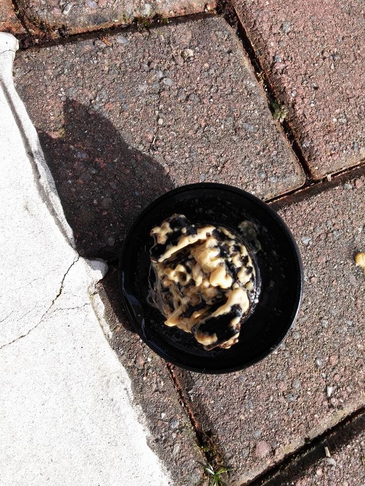

I have a Fabia X reg 1.4 mpi 2001. This morning I have found this crap in the oil cap and in the temperature sensor. Does anybody now what is? Is it possible to sort it out the problem? Many Thanks guys!

Looks like it will be your head gasket gone,but you might be lucky and it's just it needs a coolant change and the mayonnaise on oil cap could just be from the winter weather,do you do a lot of short journeys?
Easiest thing to do is get a garage to do a 'sniff' test on the cooling system,this will show if there are combustion gasses in the coolant system.

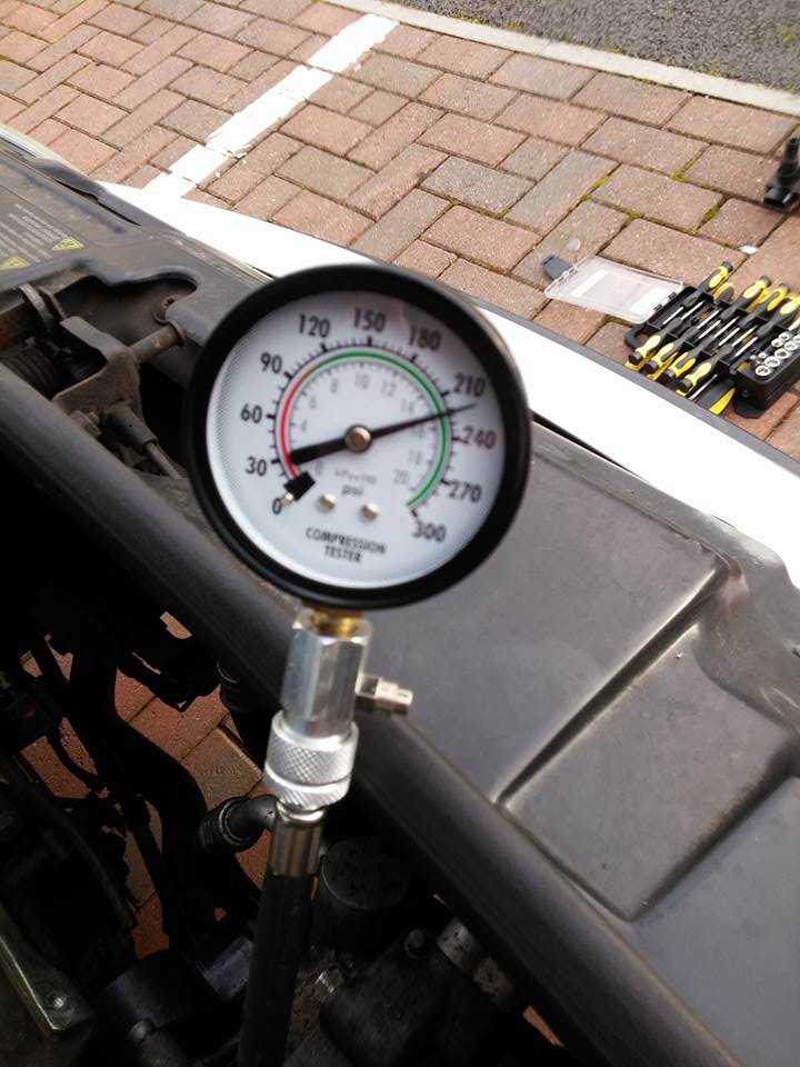

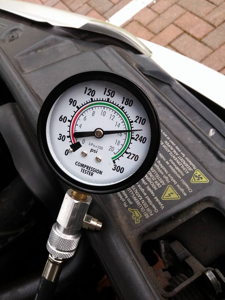

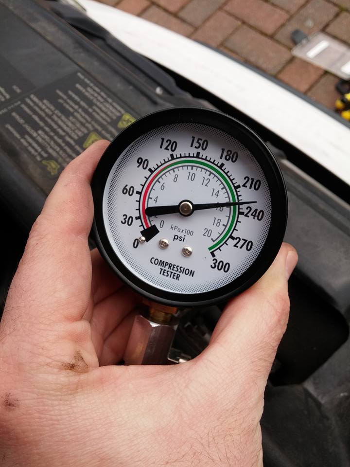

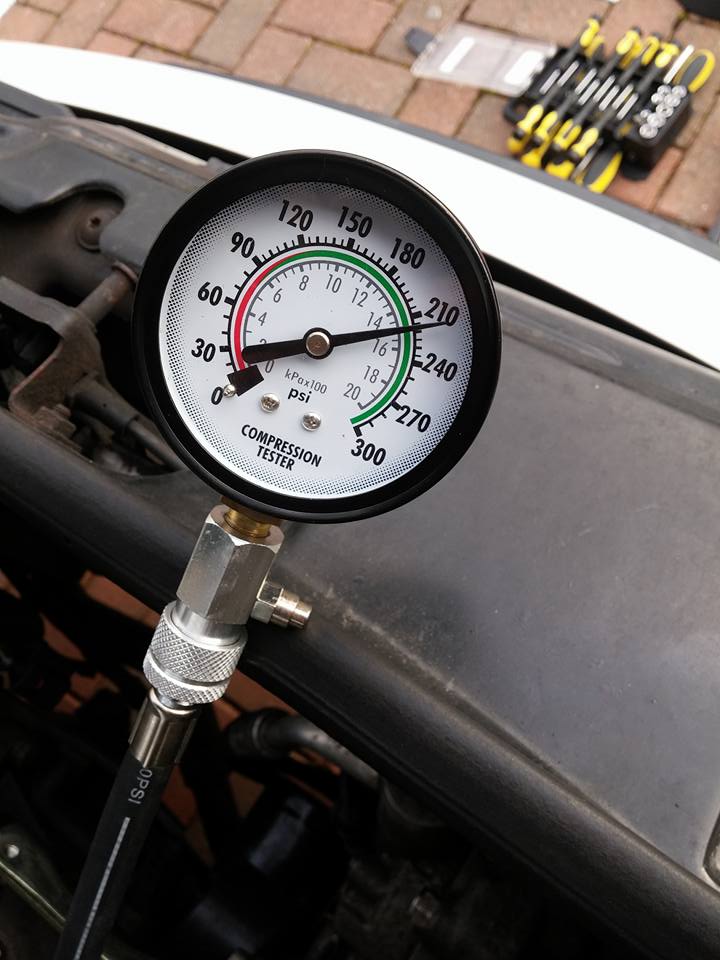

Hi guys, Today I have done the compression test. These are the results. What do you think? Is still the HG?
Head gaskets are common on the MPI, however not normally leaking coolant into the oil. They tend to burn the coolant off or over pressurise the cooling system.
Look pretty equal to me.
Looks good to me. I've done a compression test last year on my mpi which has about 120.000miles and it was around 14.8 on all 4 cylinders.

Check around the radiator thermoswitch for evidence of coolant leakage, to explain the top-ups (and at the ends of any/all flexible hoses if there's no evidence there).  Clean the mayo off the oil filler cap and then go for a half-hour plus 'brisk' drive on a dual carriageway. When you get home, check the oil cap again. Post a picture of what it's like.

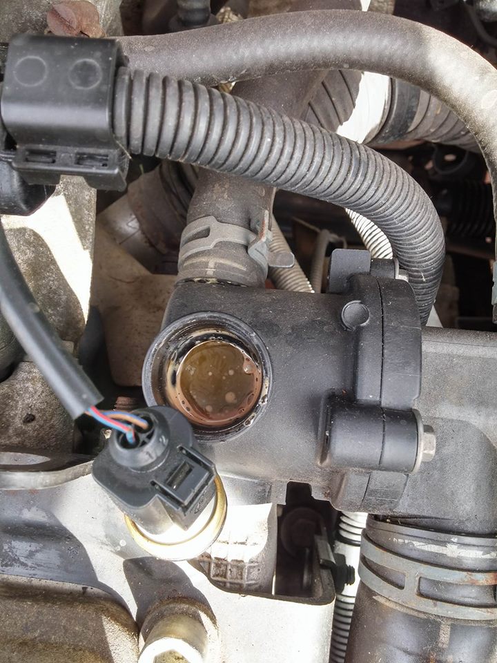

You can get mayo on the oil cap from short journeys but coupled with what looks like emulsified oil in the coolant system there is something else wrong here. How does the expansion tank and cap look?

It's the crap in the coolant which concerns me, along with having to top it up regularly. If it was just mayo in the cap, I'd say condenstation. Good compression though, but unless there's any external leaks, then each cylinder will reach good compression.
