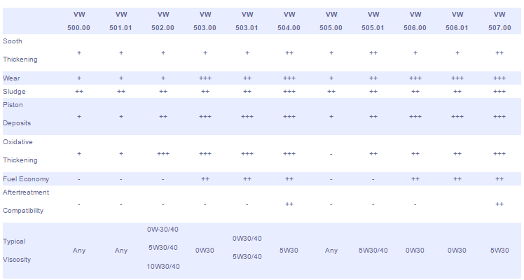

Found an oil comparison tool and you can look at various oils specs from different manufacturers and how they compare to previous specs. Not saying it's correct but the 507 oil according to this is superior to the 505.01 but as the 507 oils have been developed to serve long drain intervals then probably no surprise.
More +++ means the oil performs better

The 505.01 is the minimum spec for the PD engines, at face value the charts I posted above show the 507 outperforms the previous spec for wear, sludge, piston deposits and oxidative thickening.

505.01 vs 507 on the image below shows that the VW507 oil standard is *possibly* made up using higher quality base stocks, I imagine the bulk is group III or in Mobil 1's case they use what is apparently unique to them a group III+ (visom) and recently GTL (gas to liquid) with a smaller percentage of group IV & possibly group V (if at all)  used in 507 spec, + a higher additive package for 507 which will be due to the requirements of the oil to reach extended drain intervals. The total base number is slightly higher for the 505.01 oils but I think (not sure) that will be depleted faster over the drain interval compared to a longlife oil which will need to string it out as long as possible and be able to stay in grade. Some reckon oils approved to the VW 507 standard go through a lengthy 650 hour wear test to get VW's approval vs 250 hours for the 505.01 oils although I'm not 100% sure on this.
Either oil will be absolutely fine in the PD engines so it's down to personal preference, I would stick with approved oils as they have undergone the relevant VW tests and met each parameter to get approval but this obviously will come at a cost and not every oil manufacturer will submit their oils for the approval test, hence they will say 'meets requirements' or 'recommended for' instead of 'approved' but that doesn't mean the oil isn't up to the job and some may even exceed the requirements set by VW.
