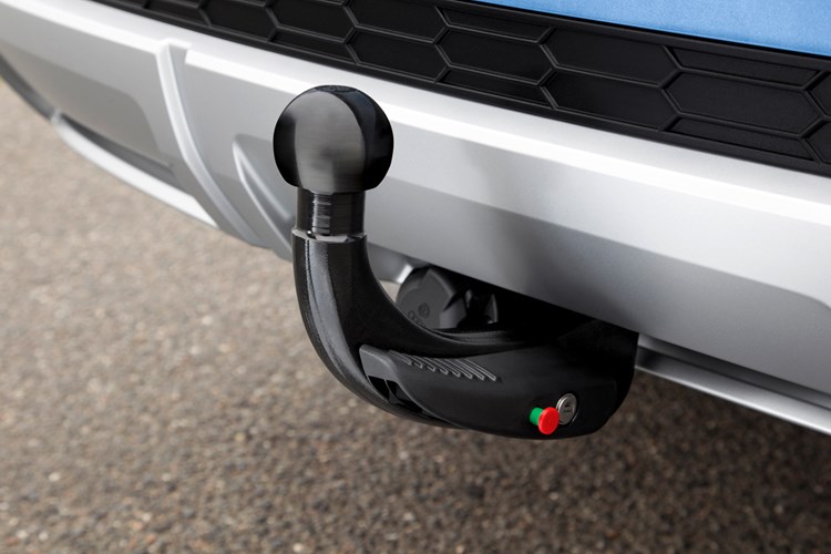

New to the forum.....and about to pull the trigger on an Octavia Estate....but I need to be clear on the towbar options....I want a detachable bar but need the flanged variety as this is compatible with the Witter cycle carrier I use.  The factory fitted bar is a standard swan neck.  I have a Witter bar on the car I'm trading in but don't believe the flanged bar will be compatible.
Can someone definitively confirm what tow bar prep means?  Surely this just means ready to attach a car specific electric kit, rather than everything but the detachable bar?
Really appreciate the heads up?  If anyone has a detachable swan neck, any chance of posting some picture to compare to my Witter one?
Many thanks
Simon
This is what my tow bar looks like on m,y 2016 2.0 TDi SE L DSG Estate.
This ain't my car BTW.
Edited by YMe
Thanks buddy...that's what I thought....will need a detachable flanged version really.
