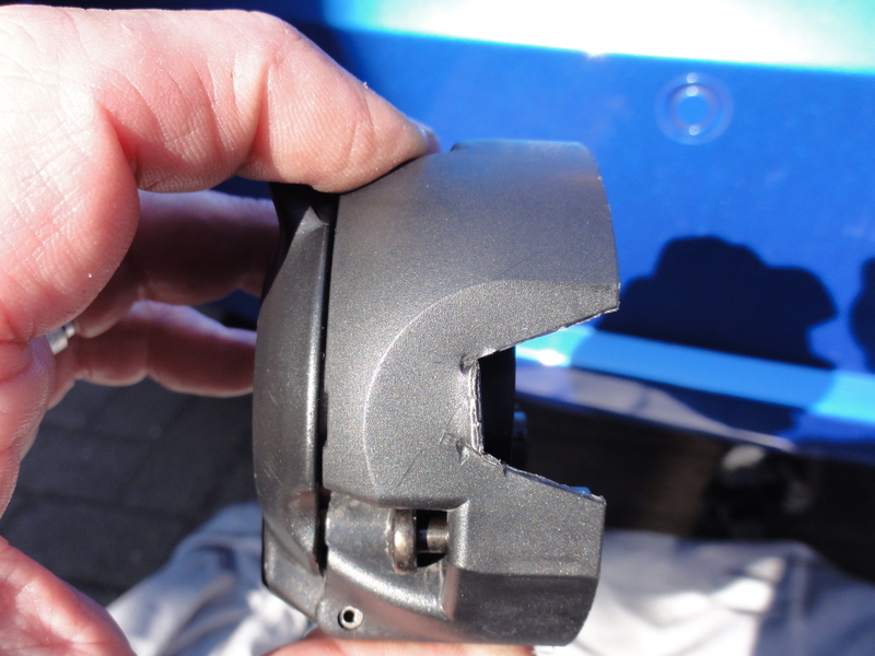

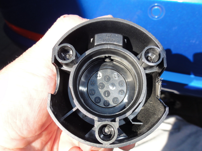

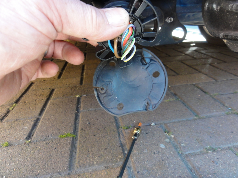

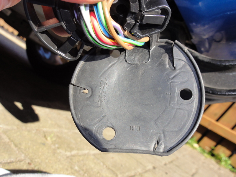

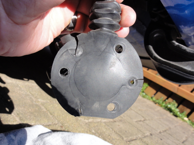

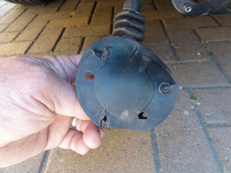

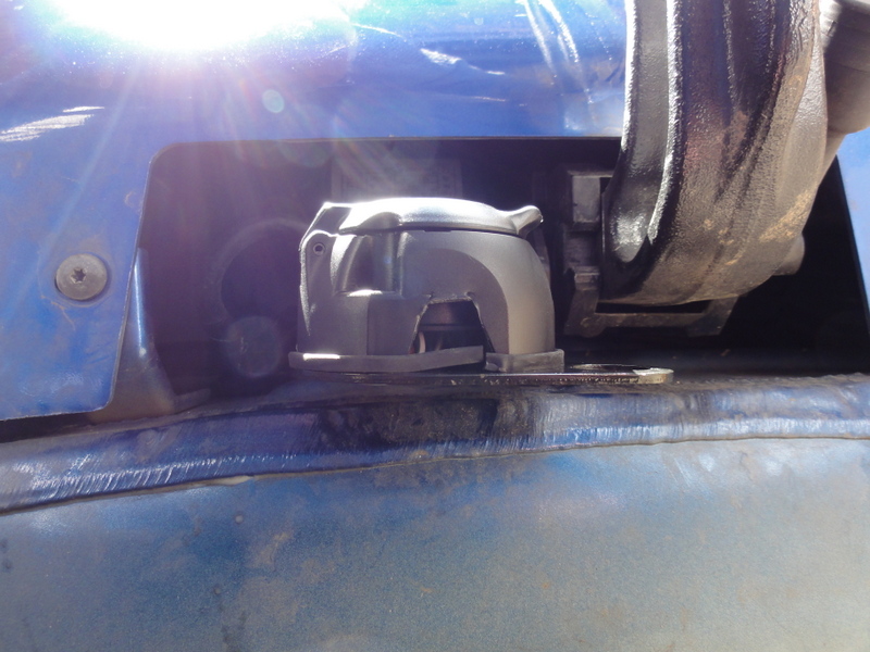

The following is what happened when a "professional" tow bar fitter/ company fitted a Skoda bar to my VRS 4 yrs ago.I have included the photos that were sent to the dealership.
Ordered the VRS and the factory fit option of tow bar prep so as I could fit the Westfalia or similar myself afterwards. I had an issue with the car on delivery and the dealer agreed to fit the official tow bar.
The independent fitter for starters got the socket the wrong way round which meant I could not insert the plug(which was good when I need the lights on a large trailer around midnight).
As you can see he butchered the sealing grommet, which has the wiring sealed from the elements.
After the initial moan to the dealer, the fitter came back and then cut off the proper wiring and replaced it with a standard socket which had no chance of keeping out the water. So after another larger moan to the owner and the service manager,
they ordered another wiring kit and fitted it. It then took multiple visits to get the coding sorted to stop the parking sensors going ballistic when reversing with the trailer.

post-81430-0-38888600-1456184199_thumb.jpgpost-81430-0-75682500-1456184199_thumb.jpgpost-81430-0-08724300-1456184200_thumb.jpgpost-81430-0-44570500-1456184200_thumb.jpgpost-81430-0-80558600-1456184200_thumb.jpgpost-81430-0-14820000-1456184201_thumb.jpgpost-81430-0-47378800-1456184201_thumb.jpg
In which case they were not a professional, and neither were the dealer if they can't code a tower.
