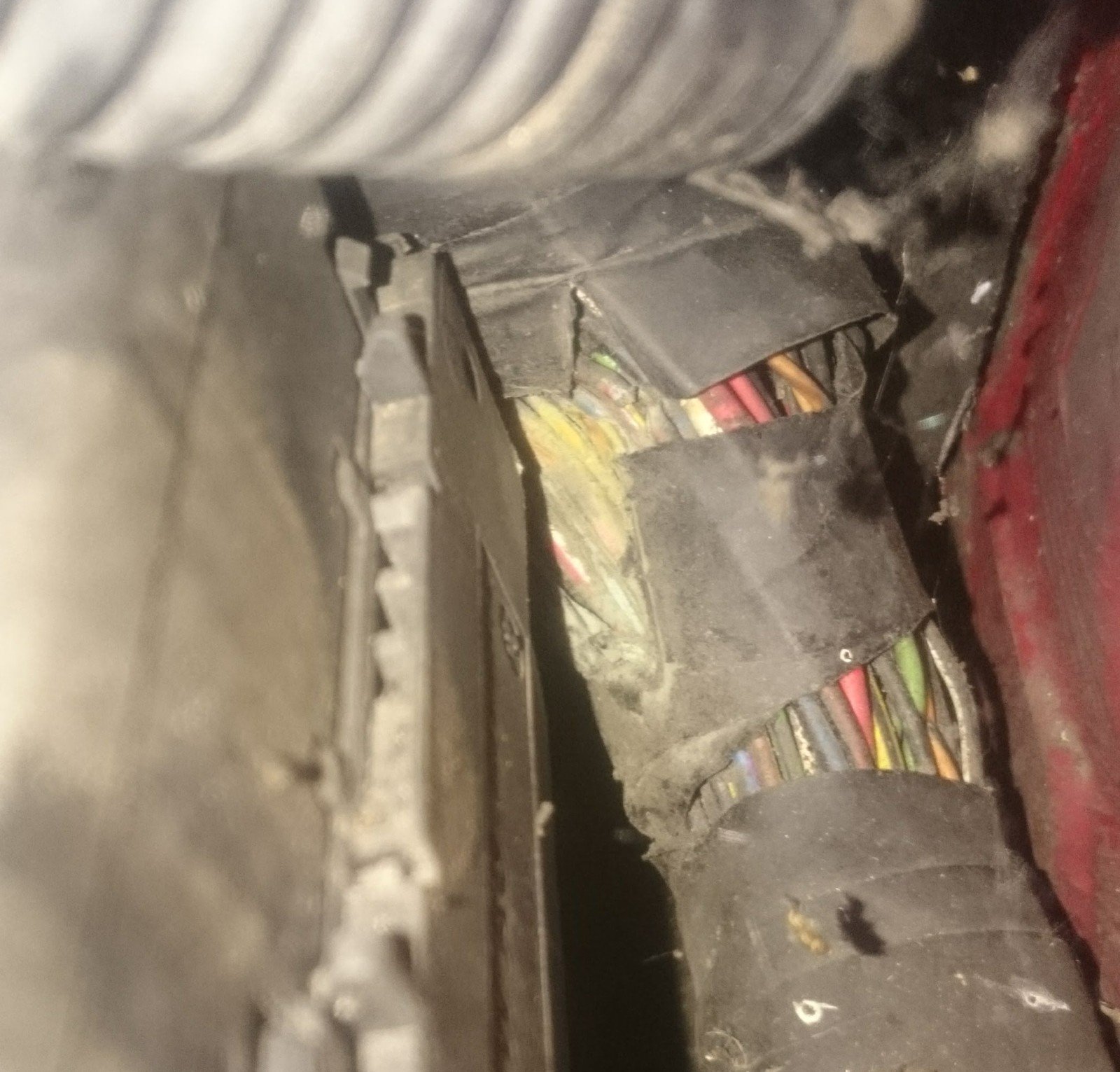

DSC_2208.thumb.JPG.1182ec27efd4470e70fb4db1a4a9c0b7.JPGDSC_2206.thumb.JPG.f2f1cc4204e217ce39da992c2d28ecc1.JPGDSC_2210.thumb.JPG.bf09c4baafe224d6209fc520d0813e75.JPG
The above photos show that the exposed loom wires have been rubbing on the corner of the ABS pump and with water seeping down this section of loom making things worse. In the center of the last photo is the black/yellow PAS wire that has broken along with 4 or 5 more others. Splicing in new wires is going to be annoying but I am so glad I have found the issue and it is fixable. I hope this helps anyone else with weird electrical issues as this seems to be a very fragile section of the loom.

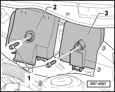

I only just recently myself discovered that the engine bay loom(s) can disconnect/unplug at the bulkhead with that/those Torx screws (only one takes all the loom except the main terminal 30 feed through on our car, the other just takes the terminal 30 feed through, some pics here: https://www.briskoda.net/forums/topic/446560-fabia-electrically-died-whilst-driving/).

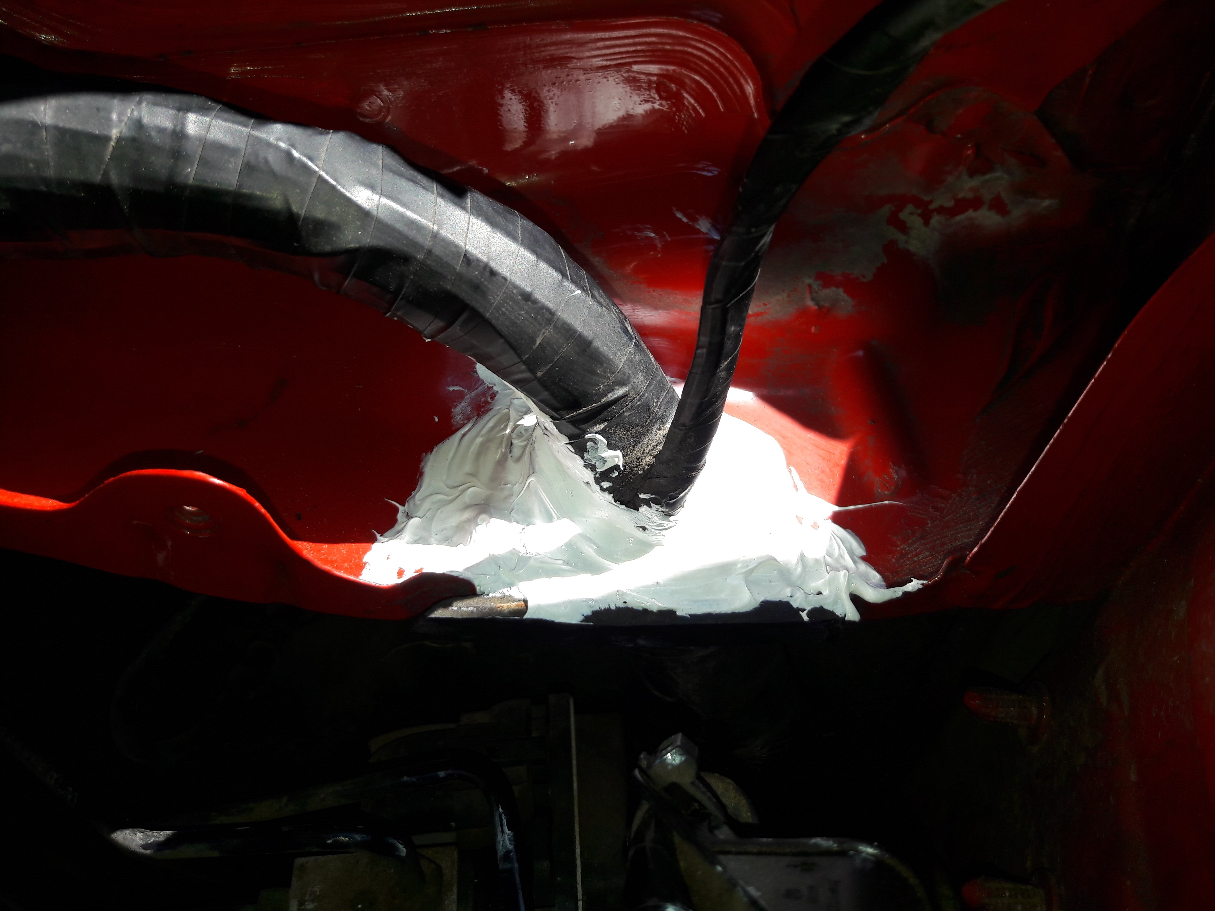

That grommet surrounding the descending loom in your first picture is - I think - meant to prevent water running down in/around the loom into the engine bay, and the steel panel on the front of the scuttle has a crappy foam seal (like door carriers) which is probably also supposed to stop water finding it's way out of the scuttle/waterbox from anywhere except the end drains. It doesn't really work.
I guess if the loom hadn't rubbed on your ABS module, water wouldn't have been able to attack the copper, but I'd advise people to clear the scuttle drains, seal these grommets etc with Plumbers Gold and inspect this 'rubbing on the ABS module' possibility if they value their car's long-term future.

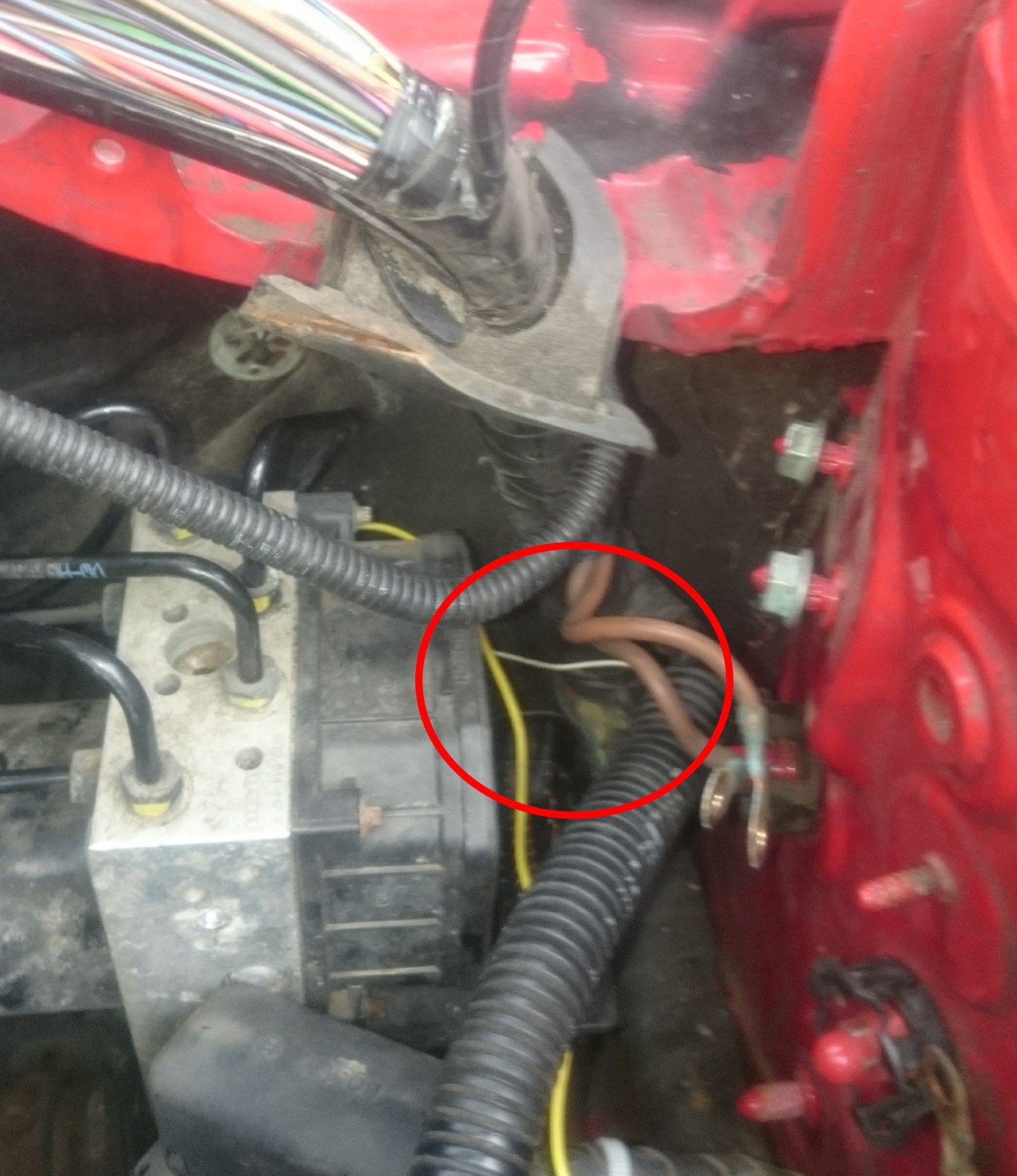

I had to take the air filter box off mine to be able to inspect the loom properly. Also had to unclip the ECU and move it slightly forward, but that is very easy.
The loom was fine where it goes behind the ABS unit, with a reasonable gap between it and the loom. However I did notice further down that the loom looked ready to start rubbing on the sharp edge of the chassis rail. The wires aren't even covered by much tape but they were undamaged, thankfully.
I slit a piece of rubber hose and pushed it onto the chassis rail to prevent any chance of it rubbing in future. Also saw three earth wires down there which I took the opportunity to remove, clean and apply some petroleum jelly to. To be fair they were surprisingly clean anyway.
