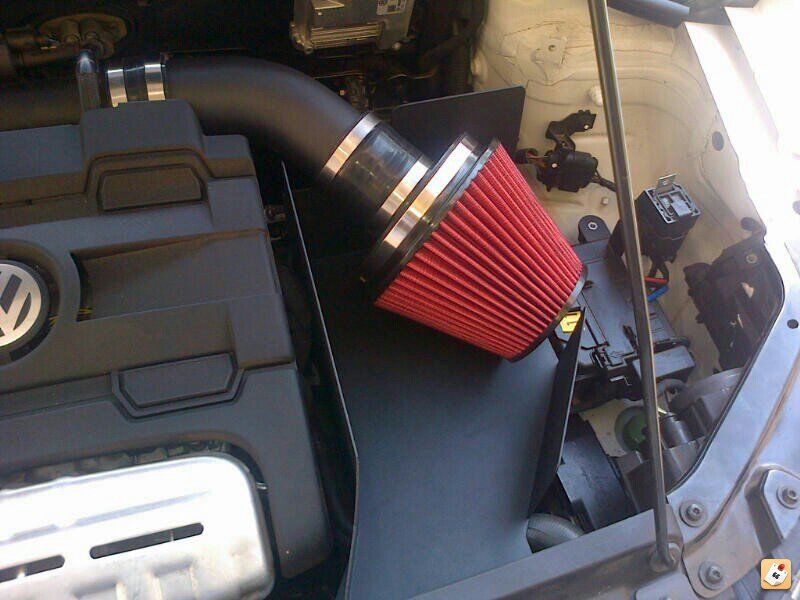

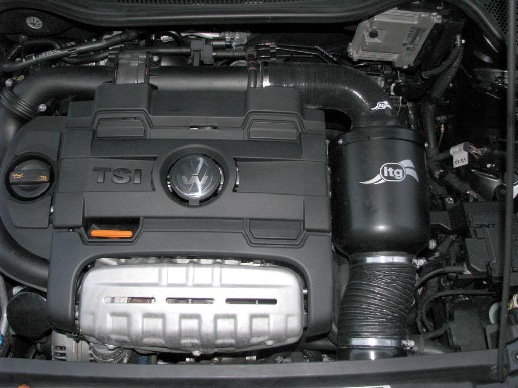

Because it lets you have more choice on the Induction Intakes you fit without going for a smaller battery or turning it.

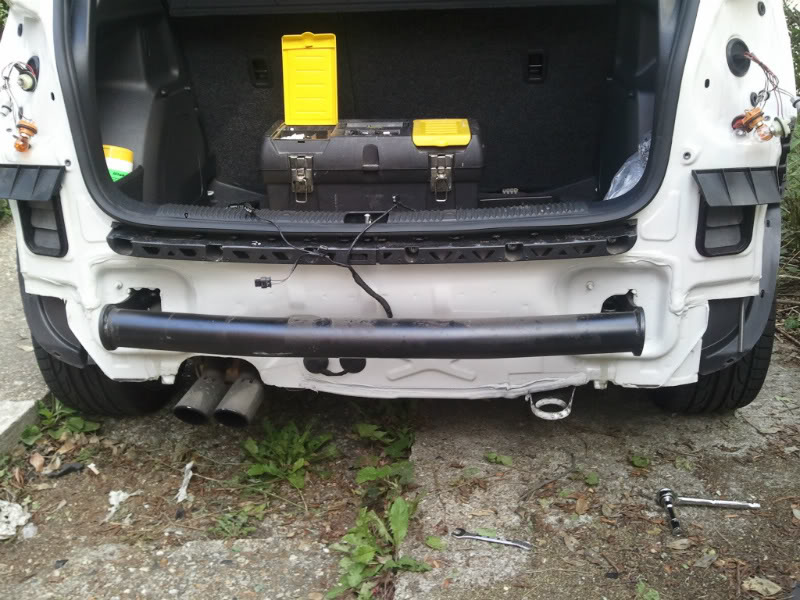

You can remove the 25kg rear Ballast weights from the Crash Bar, the 20 kg spare wheel and put the battery in the boot and then check out the handling.
Or just Turn the Battery in the engine compartment.

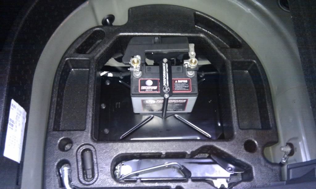

Fitting the Battery in the boot is no problem.
The Polo GTI had the Spare Wheel as a Option and you had to buy a Battery Cover.
Wiring from front to rear depends on your skills or mates skills.

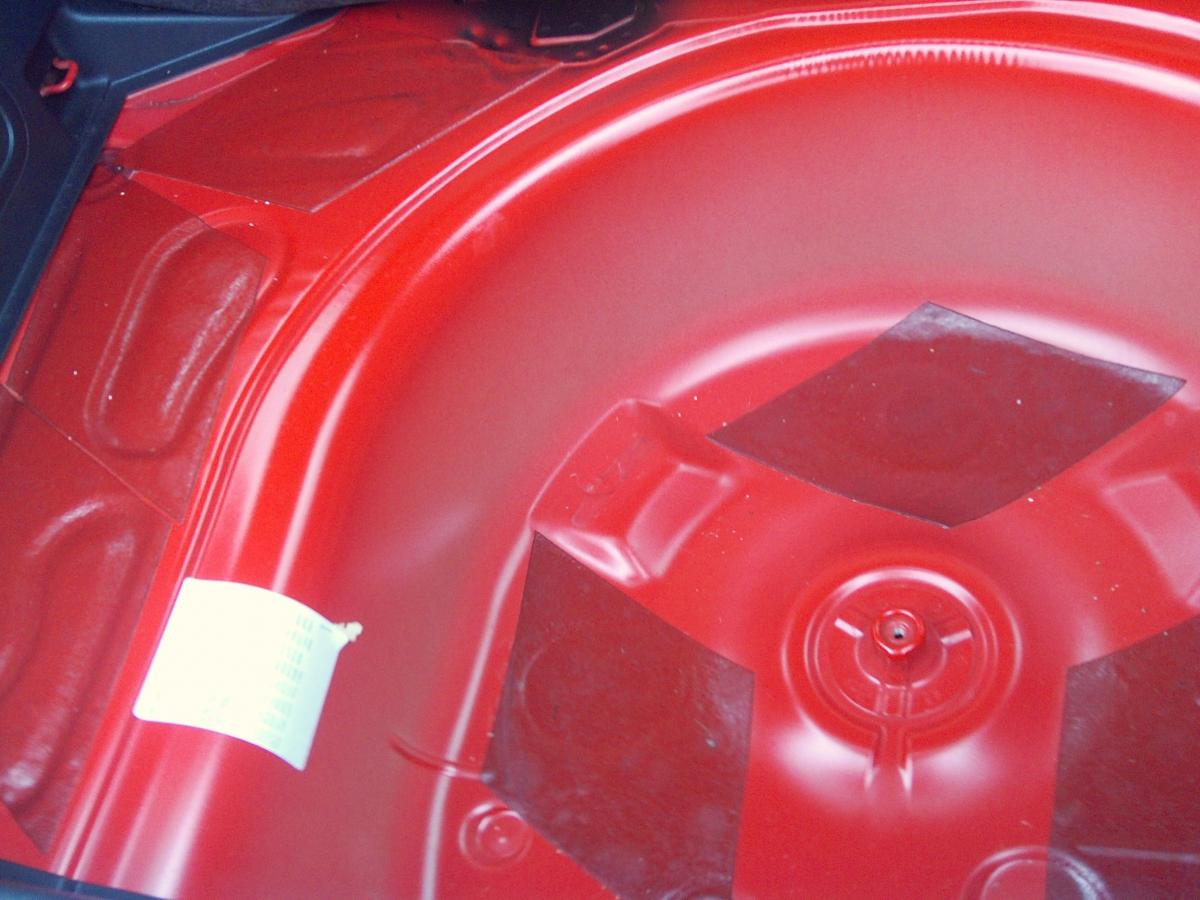

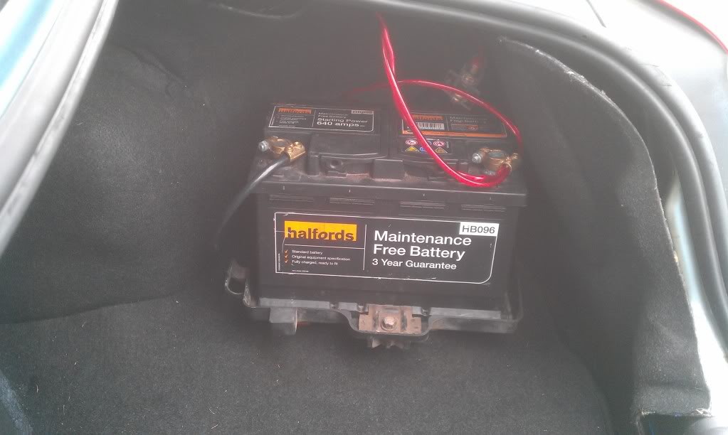

The second picture has like a metal floor that's what I was kinda after haven't got a problem wiring it in its just securing the battery somehow idealy without drilling the floor which is why wanted to look how the polo gti was
Sent from my LG-H815 using Tapatalk
Ant-vrs on here moved his to make space.
Looks well.

 You have the Centre hole for the Spare Wheel securing (Threaded hole.)to utilise for fixing a battery carrier to,
fabricate something. DIY!
Why does drilling the floor of the spare tyre well concern you.?
**You are taking a cable through, fitting an earth anyway when doing it neatly.**
It is really not an issue for your Corrosion Warranty. (& your car is modified, so modify as you wish, just do it safely.)
You need to secure what ever battery carrier you use.  Just drill the holes, clean then etch and prime and paint the holes.
Fit a battery carrier, seal the holes / bolts, paint any nuts  / bolt heads under the car.

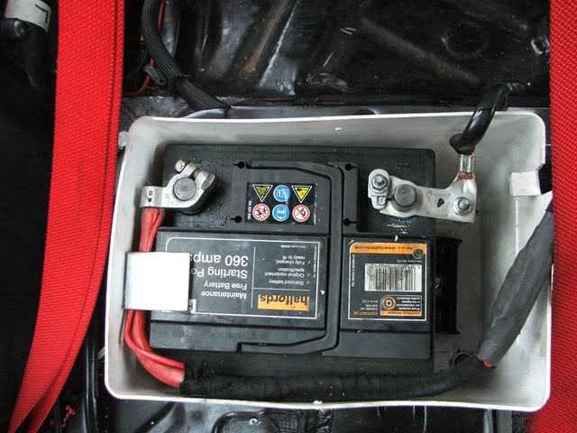

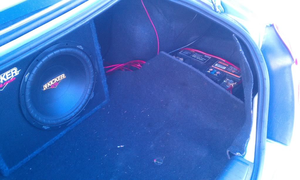

As an alternative fit the battery at the rear passenger side.(the side you remove 25kg of ballast weights from)
Cut the Floor covering at the side in the boot, then secure a Battery Box on the higher part of the boot space
at the side, as people do when fitting 2nd batteries to power their ICE or Leisure Batteries.

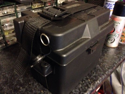

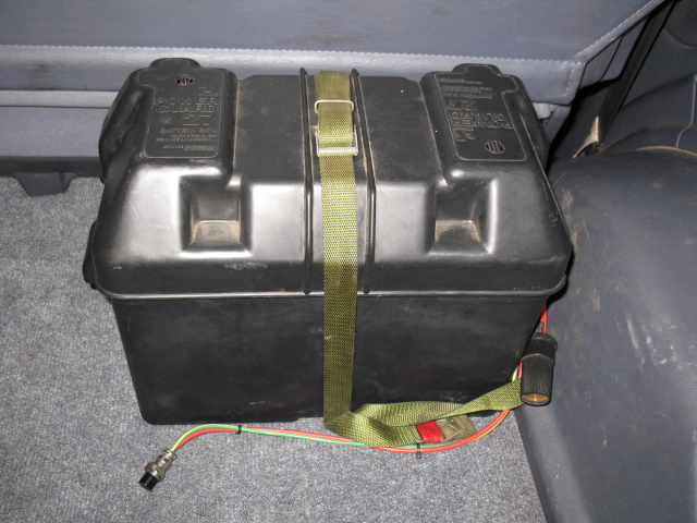

Just some more ideas / examples for you.
You can buy various types of Battery Boxes for Marine and Caravan use and then fit these with a suitable carrier.
