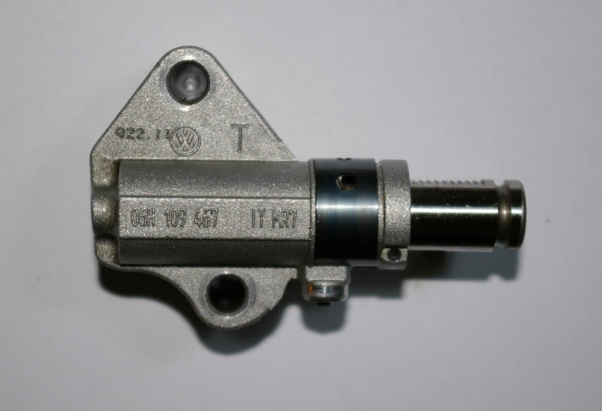

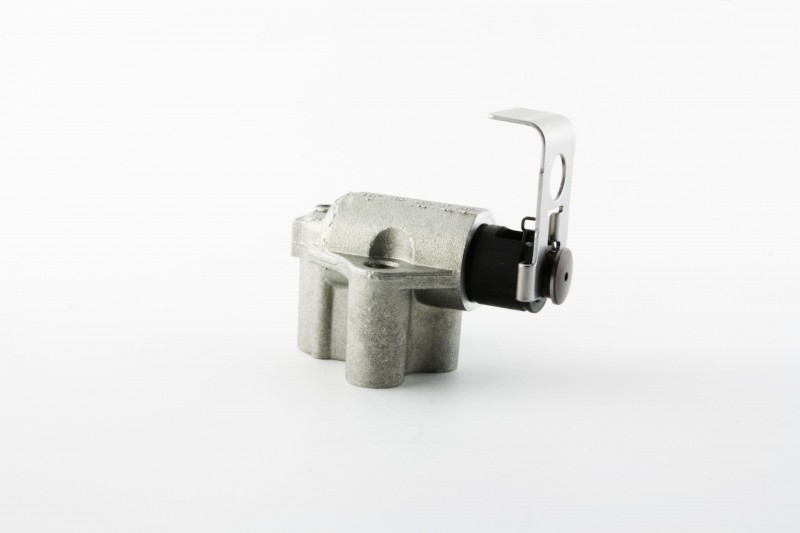

If you have pre-2013 1.8TSi mk2 get the chain tensioner checked to see if it's the revised version or the old one (see below). My 2011 TSi had the old tensioner - which has been known to fail causing the chain to be slack on start up and after increased rattling over days/weeks will eventually jump 4-5 teeth and allow valves to make contact with the pistons!
As a preventative measure I had it changed (no need for a new side pan as they are stronger than Skoda would lead you to believe!). New tensioner (revision T) was £40 and labour at my local garage was £160 including sealant. I've done 500 miles since and no oil weeps. £200 is not bad for peace of mind driving vs the chance of a massive bill for an head re-build.
Garage said that it isn't just a Skoda issue. They've done the same thing with many VAG cars, BMW's, Jag's etc.
Photo of old and tensioners below.
Worth checking for any 1.8TSi owners.

You're right, especially as the car has done such low mileage. The tensioner kit that Skoda sell comes with the tensioner (rev T, £40), side pan (approx £80) and sealant (approx £60!!). I didn't use their expensive sealant or need a new side pan - as it can be removed and reused if done carefully. Labour is shown as 4hrs. So the Skoda bill is going to be pretty hefty.

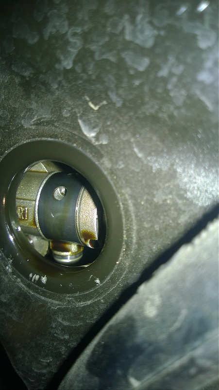

But I would recommend first getting someone to check which tensioner you have on the car. This can be done by looking (with a small mirror on a stick) through an inspection opening (sealed by a circular rubber grommet) on the driver's side of the engine (see photo attached below). This would then confirm whether you need to replace the tensioner. I did this and saw what you can see below i.e. the old style tensioner, so had to get the work done. Any Skoda or decent garage should be able to do this inspection for you pretty cheaply so you can positively verify where you stand.
Hopefully you'll be one of the lucky ones. But if not get the work done asap.
