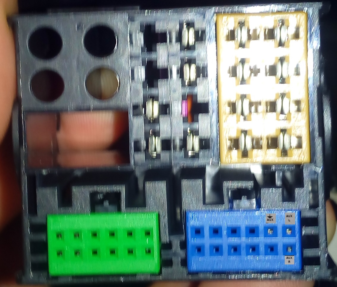

An AUX socket has three conductors, one for each channel and one common earth. Use this photo I took from my car to wire them accordingly.
