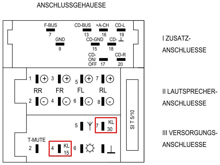

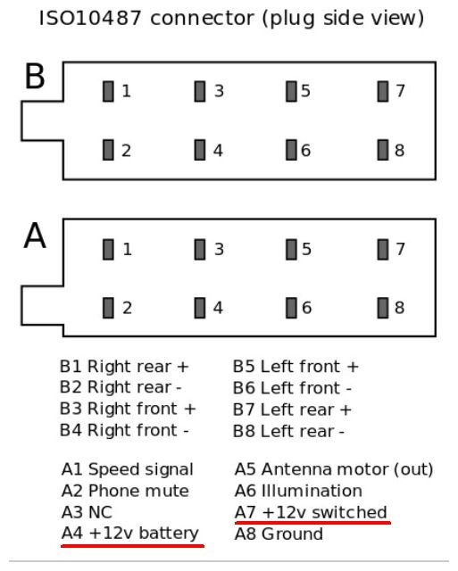

Felicia with Grundig MS-201 comes with (almost) standard ISO10487 connectors, meaning any modern radio will accept them. I say "almost" because on some VAG cars (Felicia included) pins A4 (+12V battery) and A7 (+12V switched) are swapped from factory. You will have to swap them back to standard ISO. If not, the radio might drain the battery overnight.
OK thanks I will have to check that when I get a new one.
Here is the proof for my advice.
  • This is from Grundig MS201 service manual.
  • This is the schematic of ISO10487 connector.
I guess I can check for certain with a circuit tester and make the relevant adjustments. Thanks for the images they will prove very useful.
Interesting, I have wiring from factory and A4 and A7 have both +12V battery. Yes, I experienced battery drain this winter, but quick fix is removing front panel of radio.
