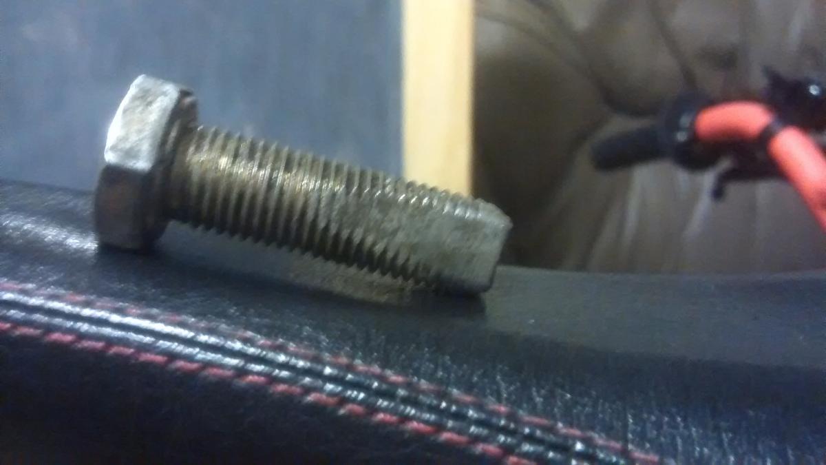

I've measured the bolt I used and it measures 10mm on the widest point. I used both spreader tool and bolt as if can't open it wider enough you have problems getting the strut back in. I think I used a 14mm head bolt and grinded two sides down so it just slips in the gap and turning the bolt so it expands the hub.

Clearly my chisel etc was no where near - didn't realise that it needed to be spread that much - I'll put that down to lack of inexperience/knowledge
