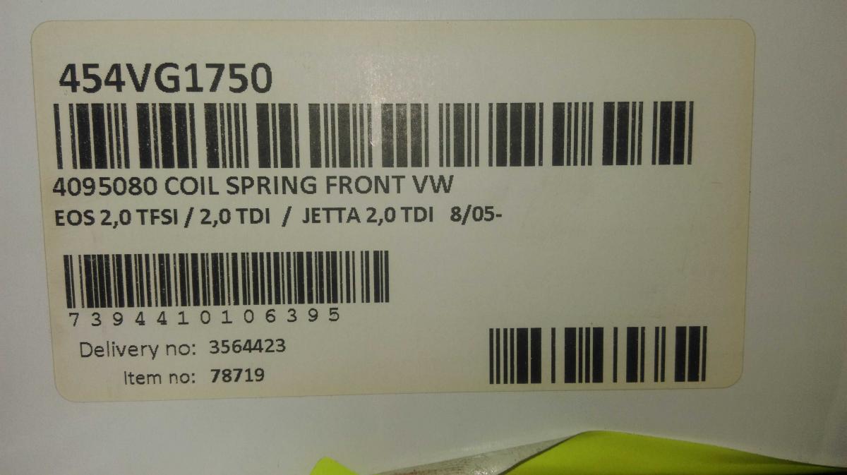

I've got a pair of Lesjofors springs bought from GSF.
Trouble is I've managed to get the broken piece of spring out and have compared it to the new ones and there is an obvious difference in diameter.
I did phone GSF before ordering them and did double check that they were the correct ones before picking them up.
The boxes don't have the Lesjofors part number on so can't compare that way.
Having now checked the labels they state EOS 2.0 TFSI, 2.0TDI / JETTA 2.0 TDI 08/05-> no mention of Skoda nevermind Octavia!
The GSF site classes my car as:-
SKODA OCTAVIA 2.0 TDI 4x4 Diesel (07/06 - 05/10)
I've added a pic of the label and also a pic showing the difference between the OEM spring diameter and the new Lesjofors.
Does anyone have any comments to make about this - as I'm thinking that they can't be the correct springs, so reluctant to start the job/fit them.

The lesjofors website lists those spring as being for cars without heavy duty suspension, so may well be wrong.
